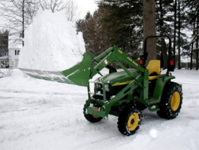

I've been using truck mounted plows for 25 years, we really can't do with out them for clearing roads and parking lots, but for clearing barn yards, contractor yards or work areas where you can't just pack snow in, the loader should be considered.
As far as Chris mentioned about power ramming snow banks with a front mounted blade well I would not do that with quick attach unit, you would rip your FEL apart in short order, just the thought of the stress that plow being that far out in front would excert on those loader arms scared me away. You could do it with a frame mount plow (which I think Chris was referring to) , only problem with that is you have to lose the loader mounts and replace with the undercarriage for the plow, very inconvienent ( had a chance to buy a new/used frame mount plow for the 4310, it was like a H.D. dozer blade w/power angle and down pressure, but it would be a pain in the neck to go from plow to FEL so I passed it up) Plowing even with frame mounts is rough on equipment believe me I became a pretty good welder early on.
Since IB is from Maine I assume they get alot of snow, I think the large material bucket is what I would want.
I mentioned we can't do with out plows, well I can since I'm not plowing for customers anymore my next work truck wil not have a plow which will save me close to $5,000.
Just a little more fuel on the snow removal debate, John
ps. I'm going to attach a picture to this post click on the attachment link above.

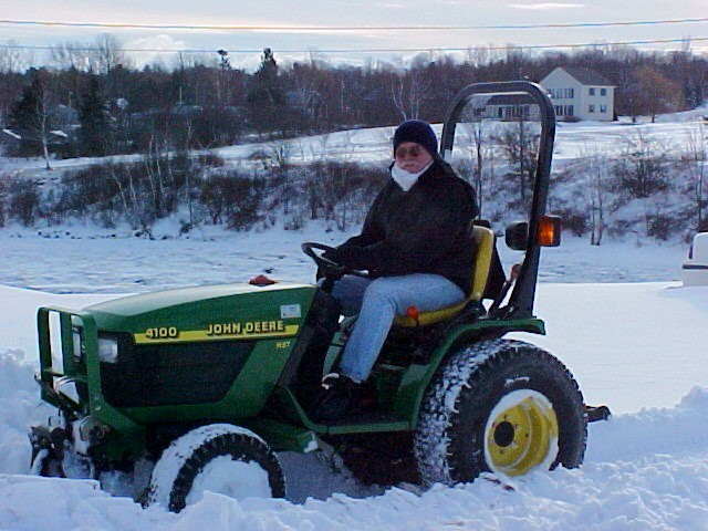

My 4310 handled that last wet snow with no problem but my body nearly froze doing it, using the FEL only just takes so much time, too much to clean up after a pass down my 300' driveway with the 61" bucket. I really think I need some kind of front blade, either the boom mount or the JD frame mount. I need to speed up my plowing time some how, I have been thinking maybe winter was over and I could wait till this fall before I had to buy another attachment but March is really wild right now.
I priced the blower front and rear and the rear one is the one I can afford but the backing up all the time in the cold would kill my neck. I know they work well but you need to be under 40 to handle pain.:) I lived right on the ocean and we get high winds here always.
What do you use up there in Raymond on your JD to move snow?
I had a front blade on my JD4100 that I sold when I got this 4310 and that would move all the snow that we get here, I up graded only cause I convinced my Wife that bigger was better and the 4310 would cut my outside time in 1/2,but so far it takes longer using the FEL on the 4310 then when I used the blade on the 4100.
