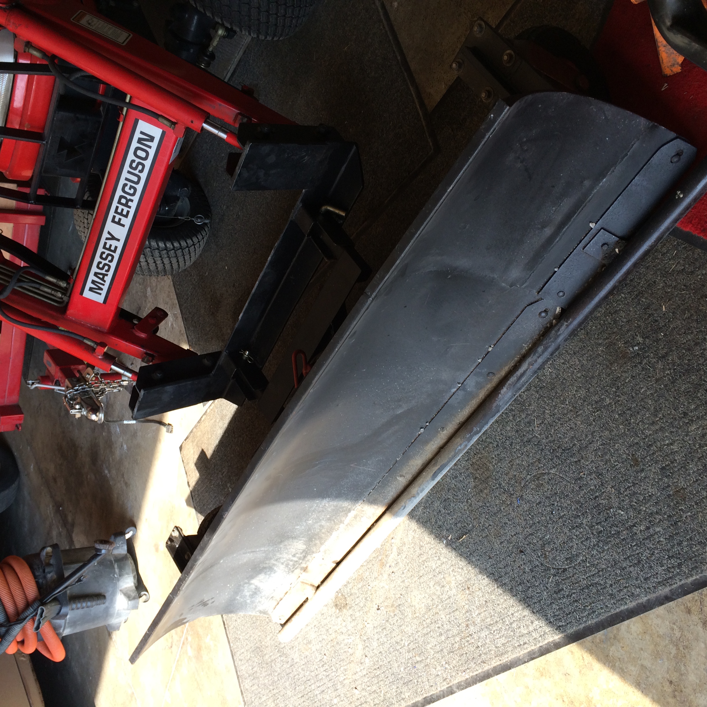

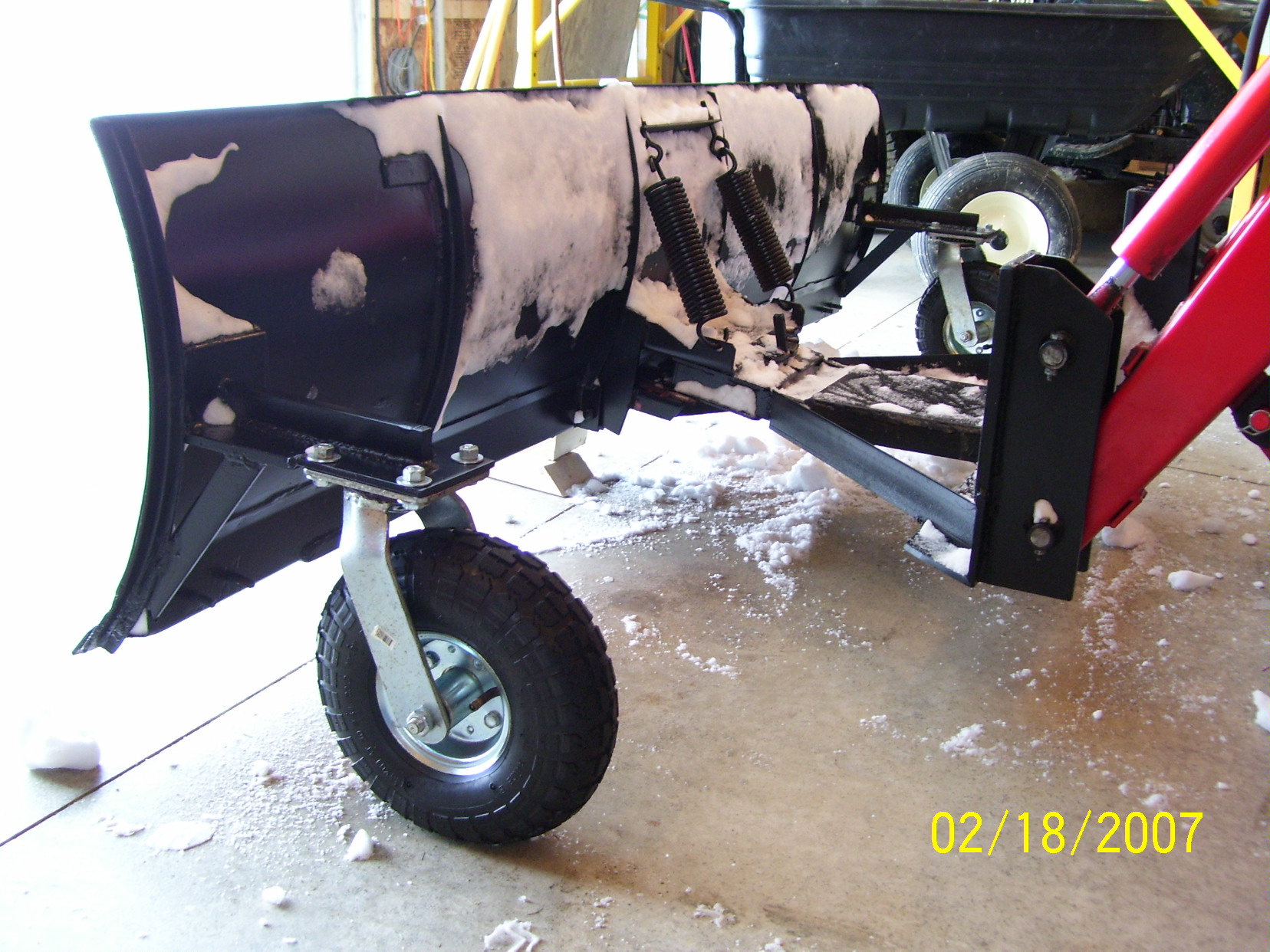

Here are my plow castors. The have, 8" foam filled tires:
Don't slit the steel pipe. It's totally unnecessary. Just weld some tabs on it, and bolt it on with the existing edge bolts.
