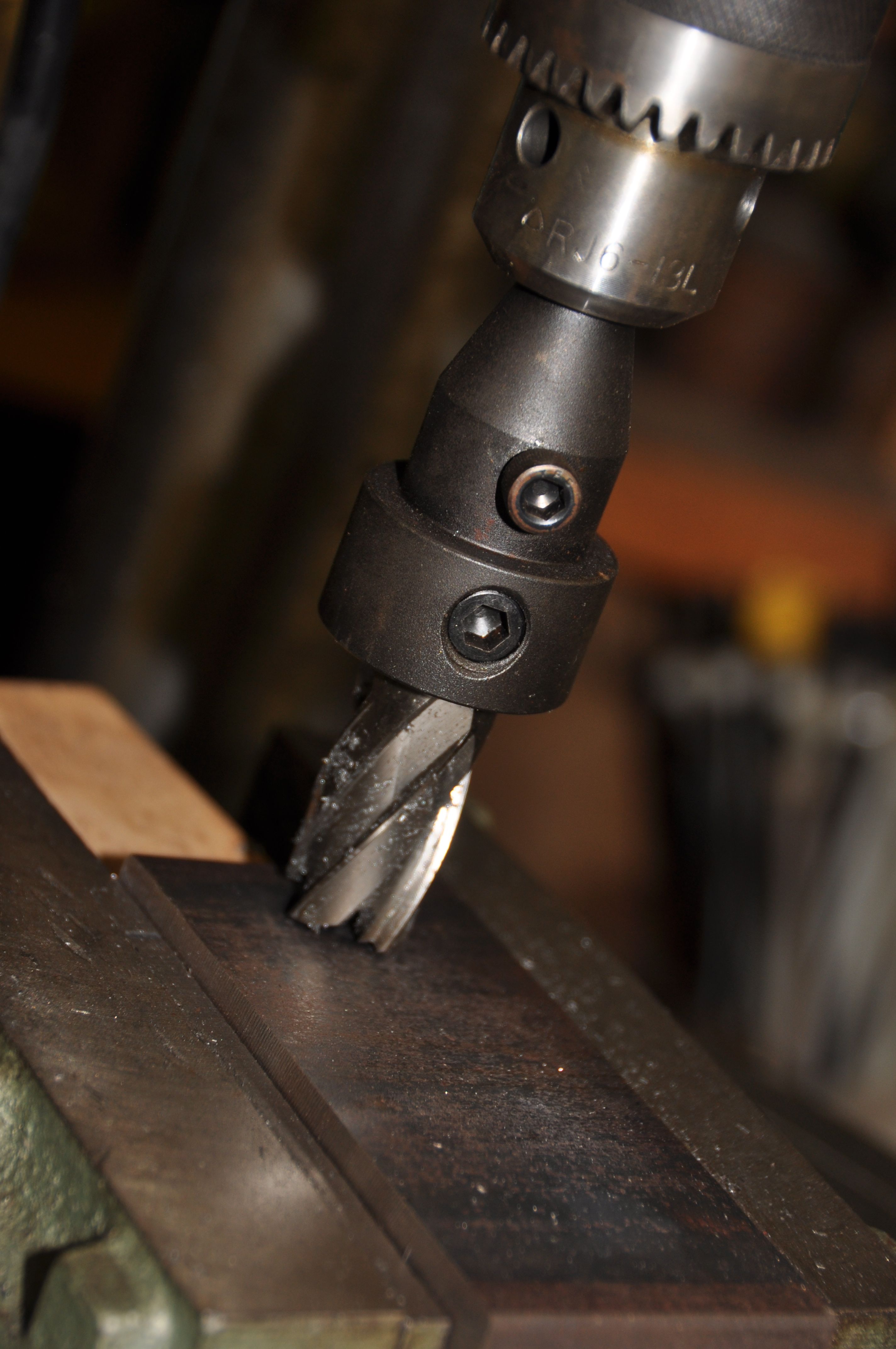

Thanks DJ54 for the slotting method. I got a plasma for Christmas last year, still playing with it. It is a fun toy. I do not have enough time during the week to get much done though. An hour before dinner on a good day.
I will make sure there is room for 4 pullback springs.

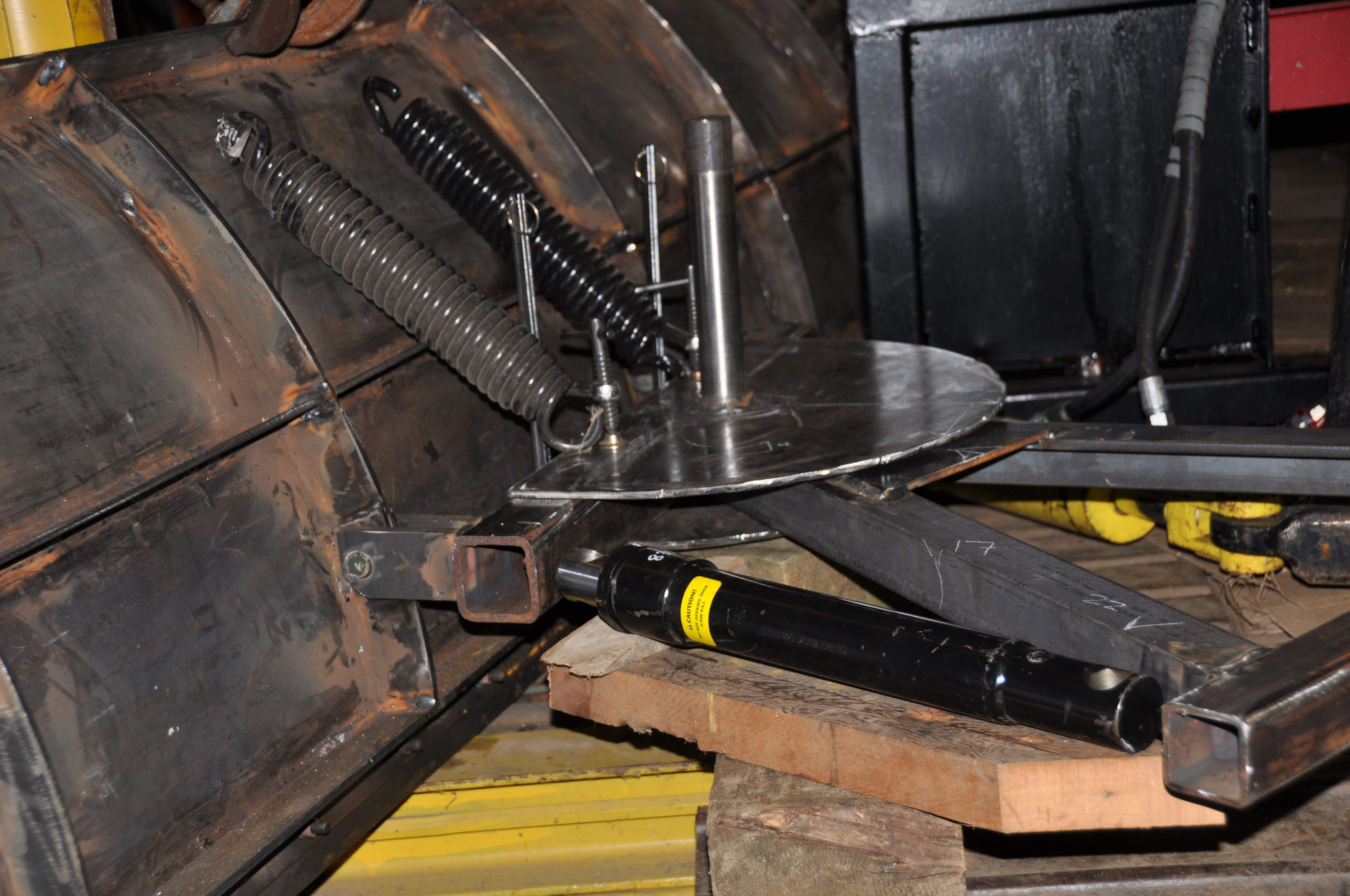

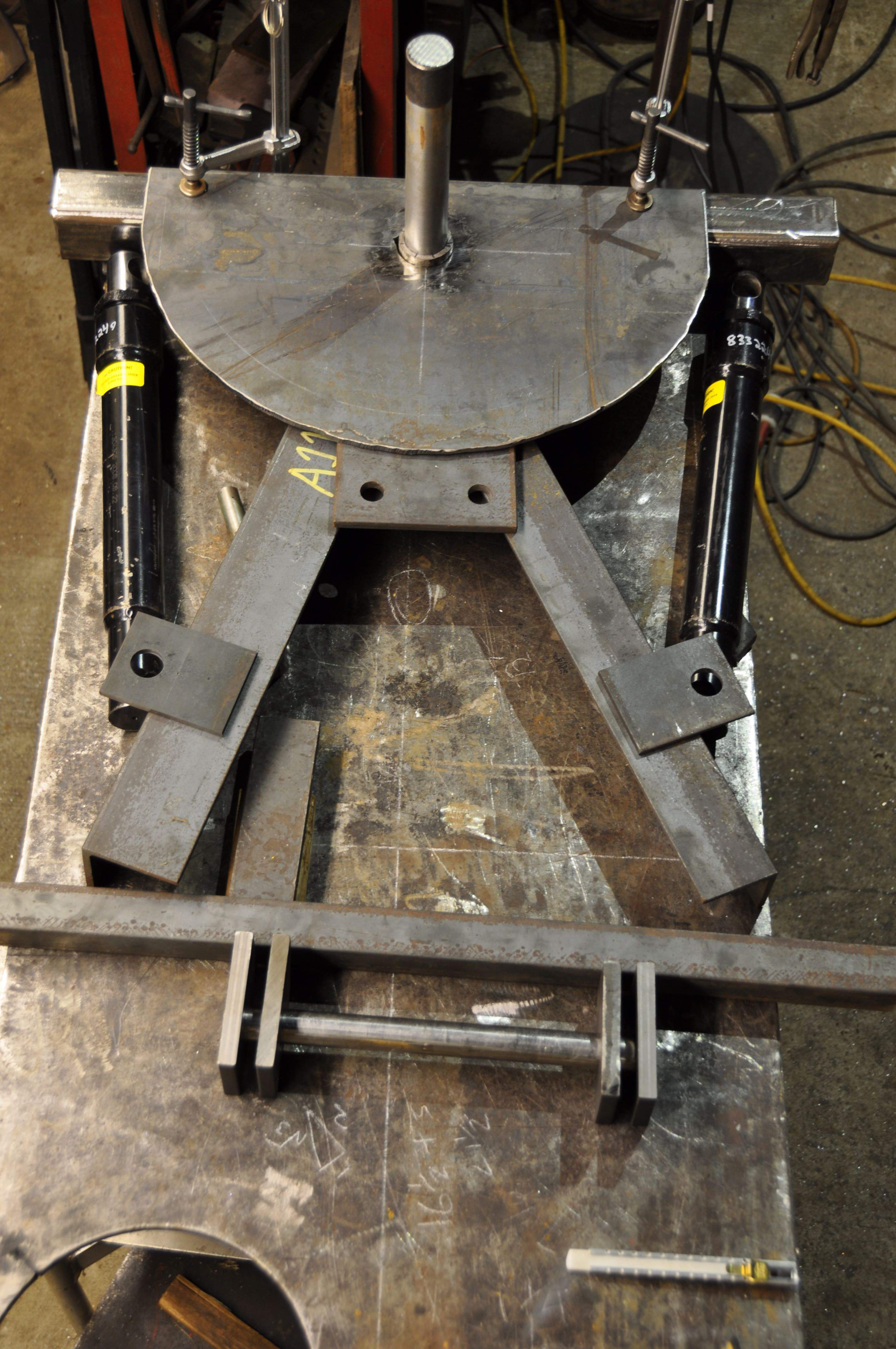

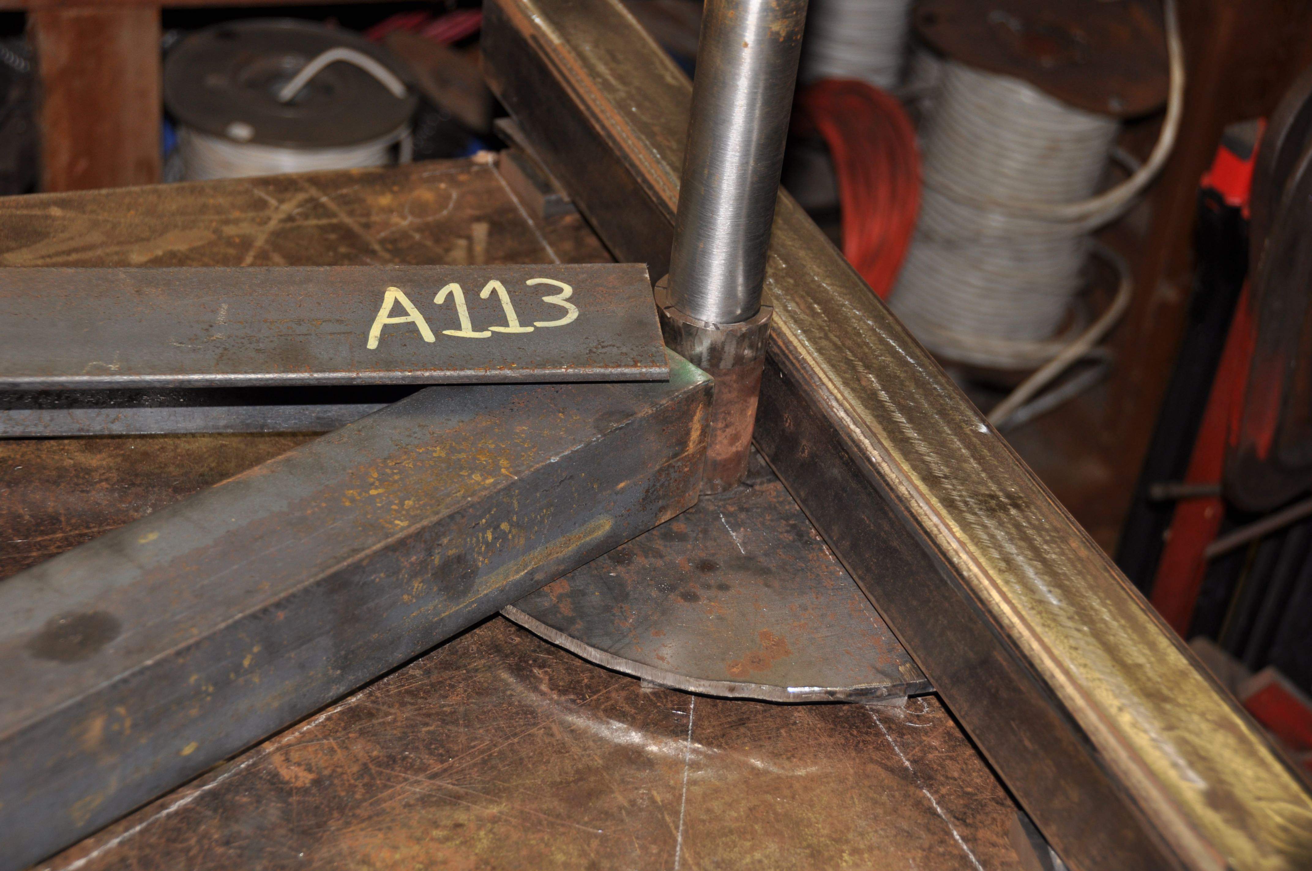

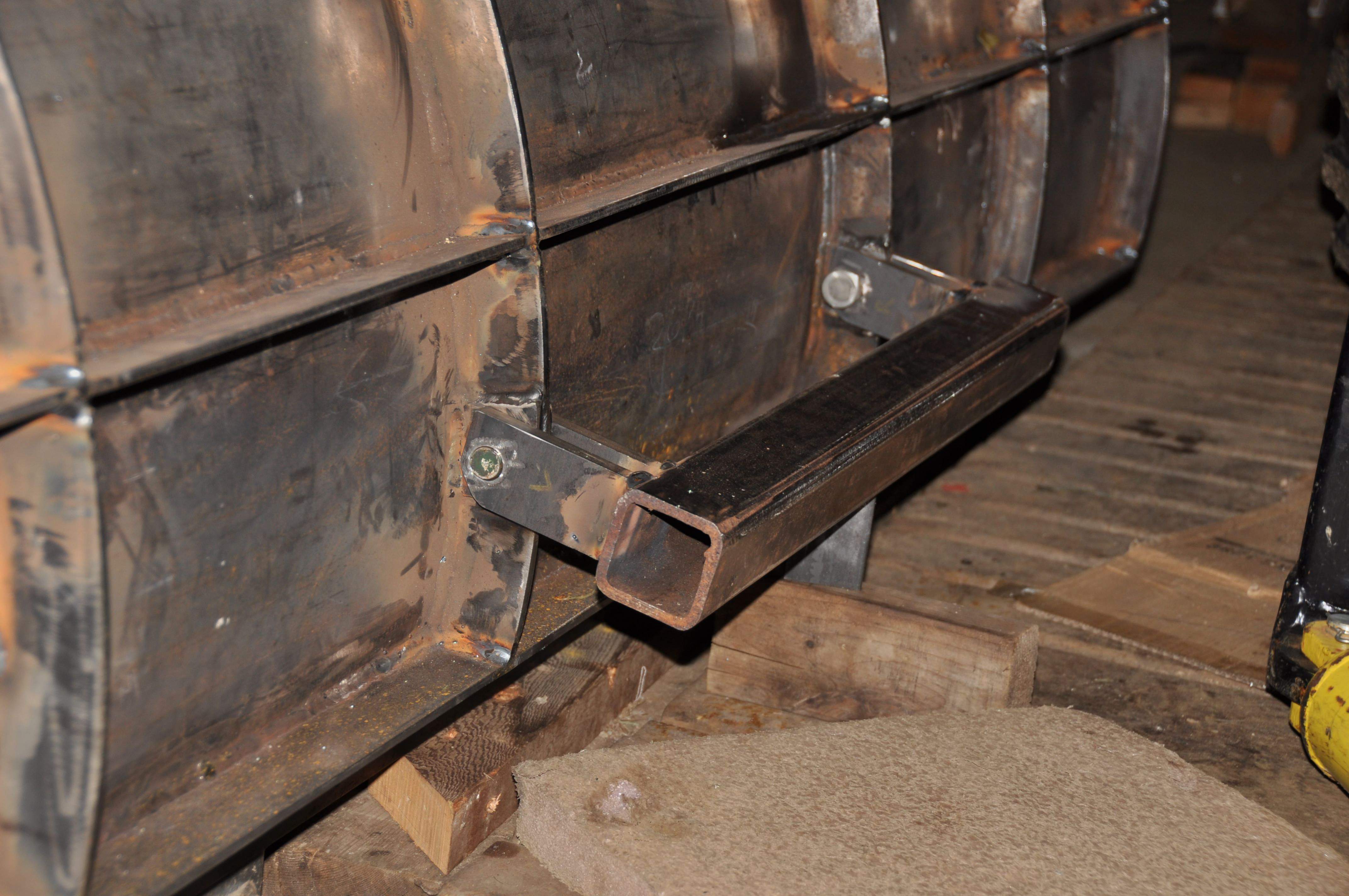

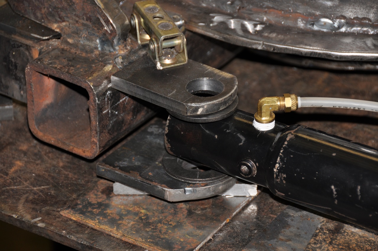

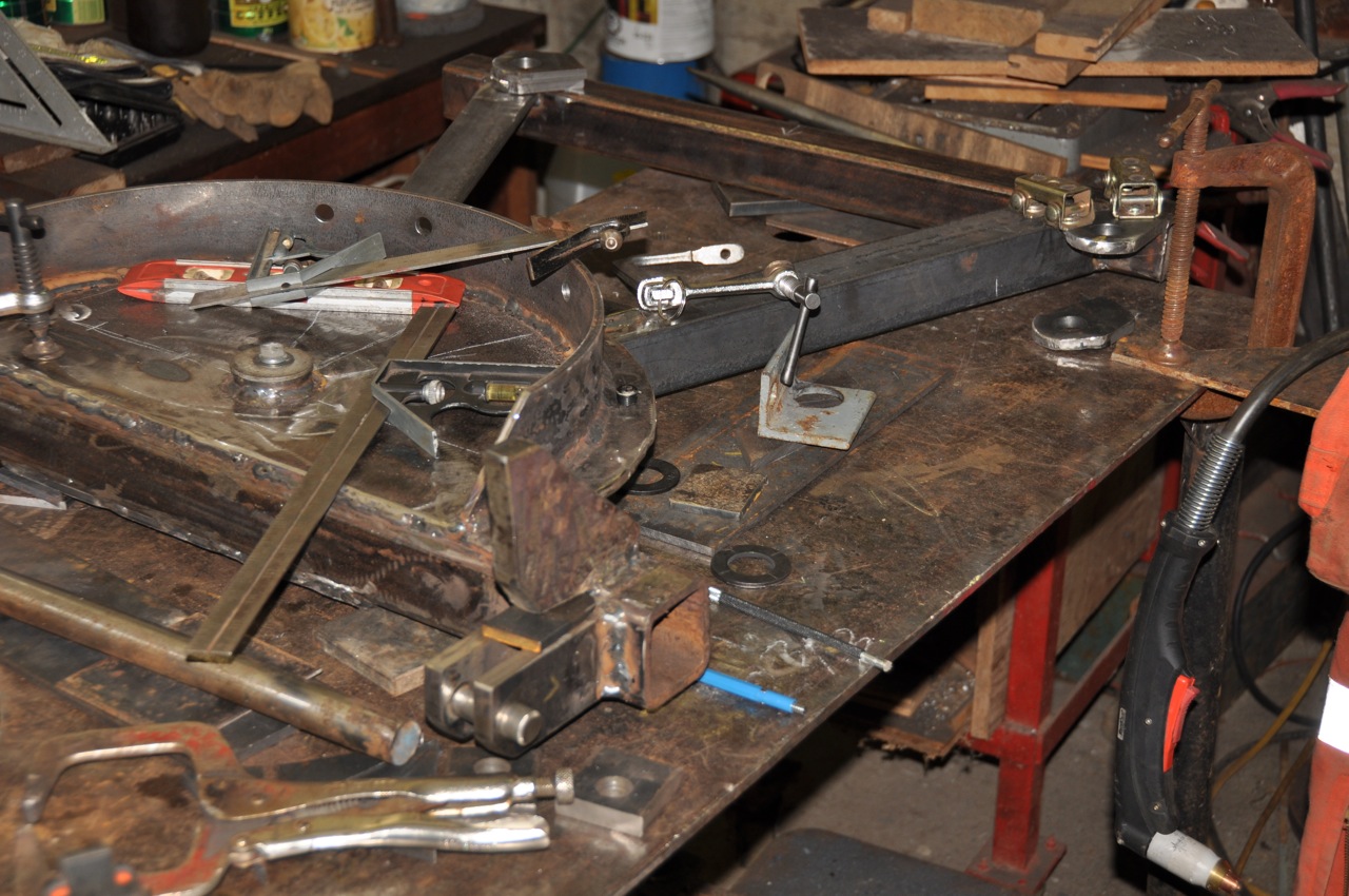

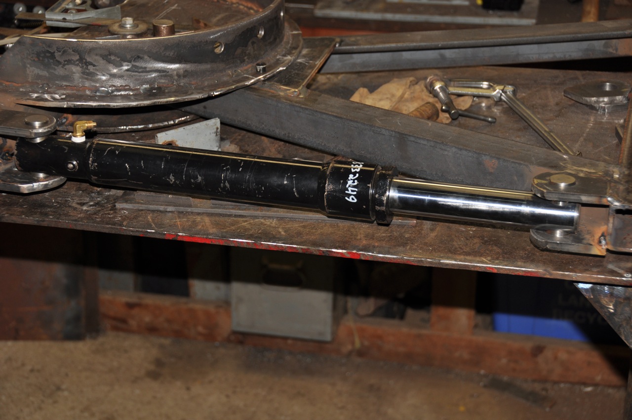

Things are slowly progressing here on the plow build. No snow to speak of this year so the urgency to finnish is not there (add in Christmas, a cold that just won't end, and a warm holiday).
The A frame and pivot cylinders are now ready for paint.
Finishing up the mount on the tractor.
The Blade is painted.
Cam
/ Snow Plow started #24
Looks good.
Once completed I assume the angle cylinder will be the other direction?

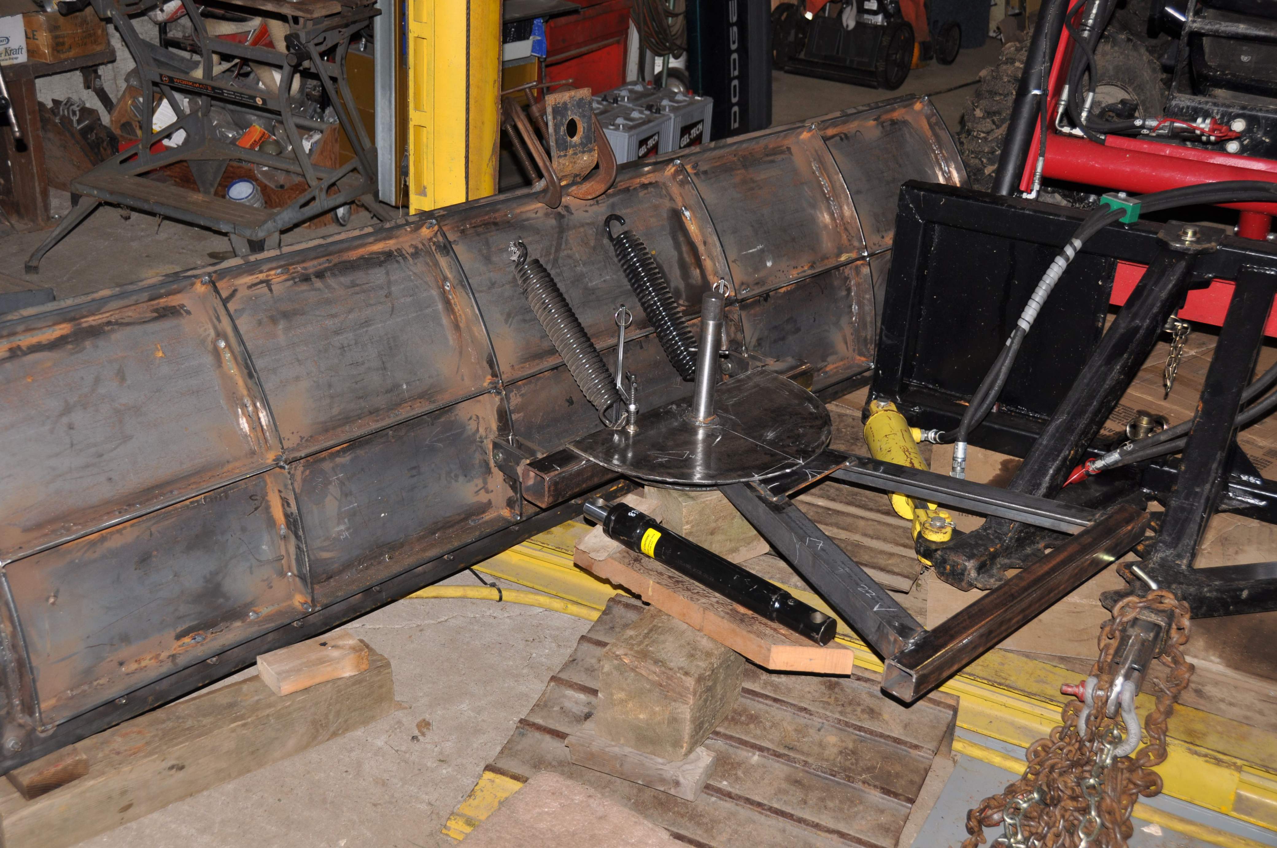

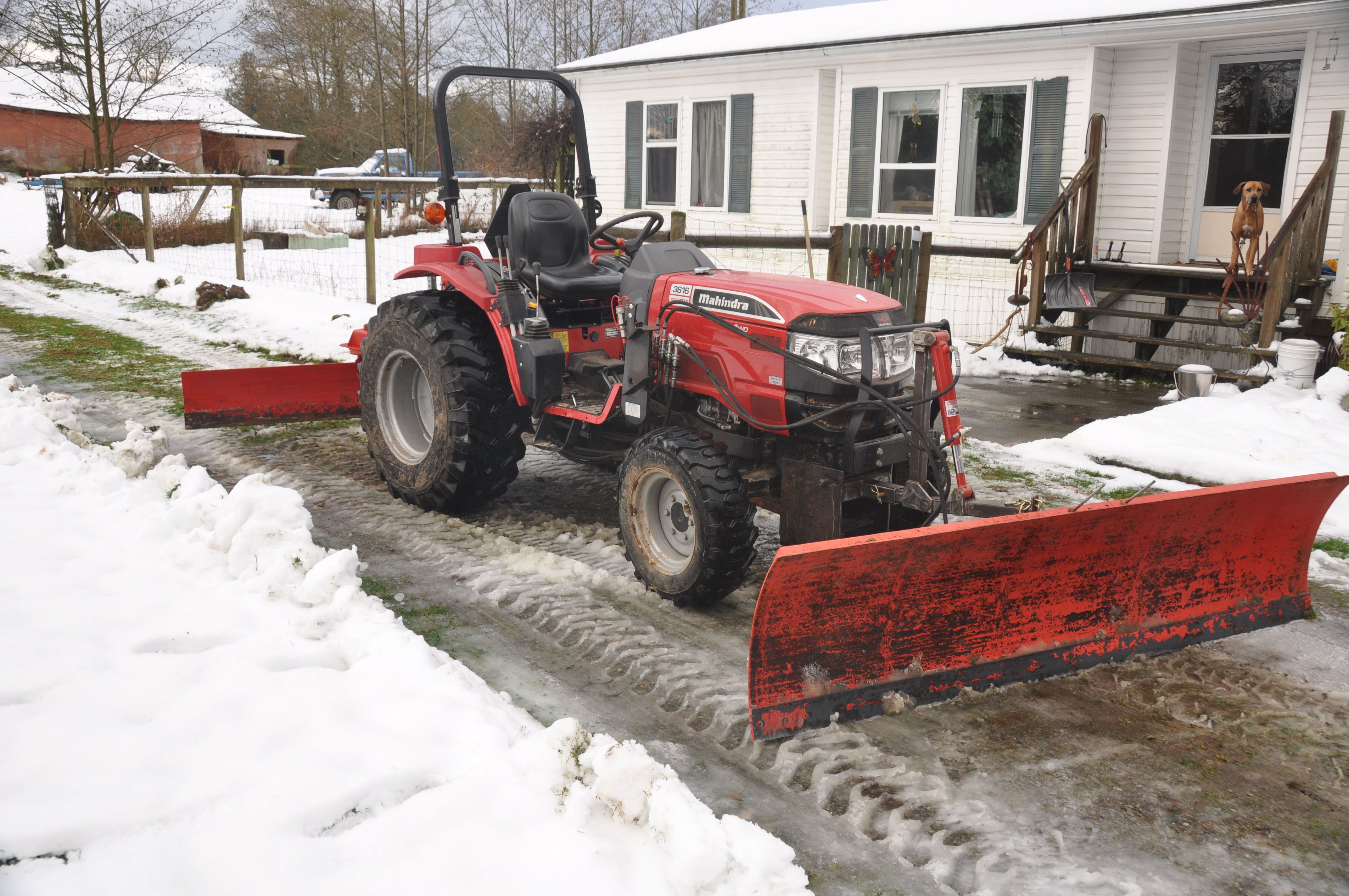

Finally got this blade finished and tested yesterday. We have not had enough snow for quite a while. So far, everything is working as expected.
I have not painted the mounting as I was not sure if I would be modifying it. The new "Water-born, eco-friendly" paint on the blade failed when I was assembling the pieces. It will have to be sandblasted off and I will start again. The surface prep was proper and clean (as advised by the paint supplier), not sure why the paint did not adhere. I could not buy self-priming epoxy here anymore. It is only sold to Pro's and have to fill out paperwork to justify its use.
Now we just need more snow so I can play.....

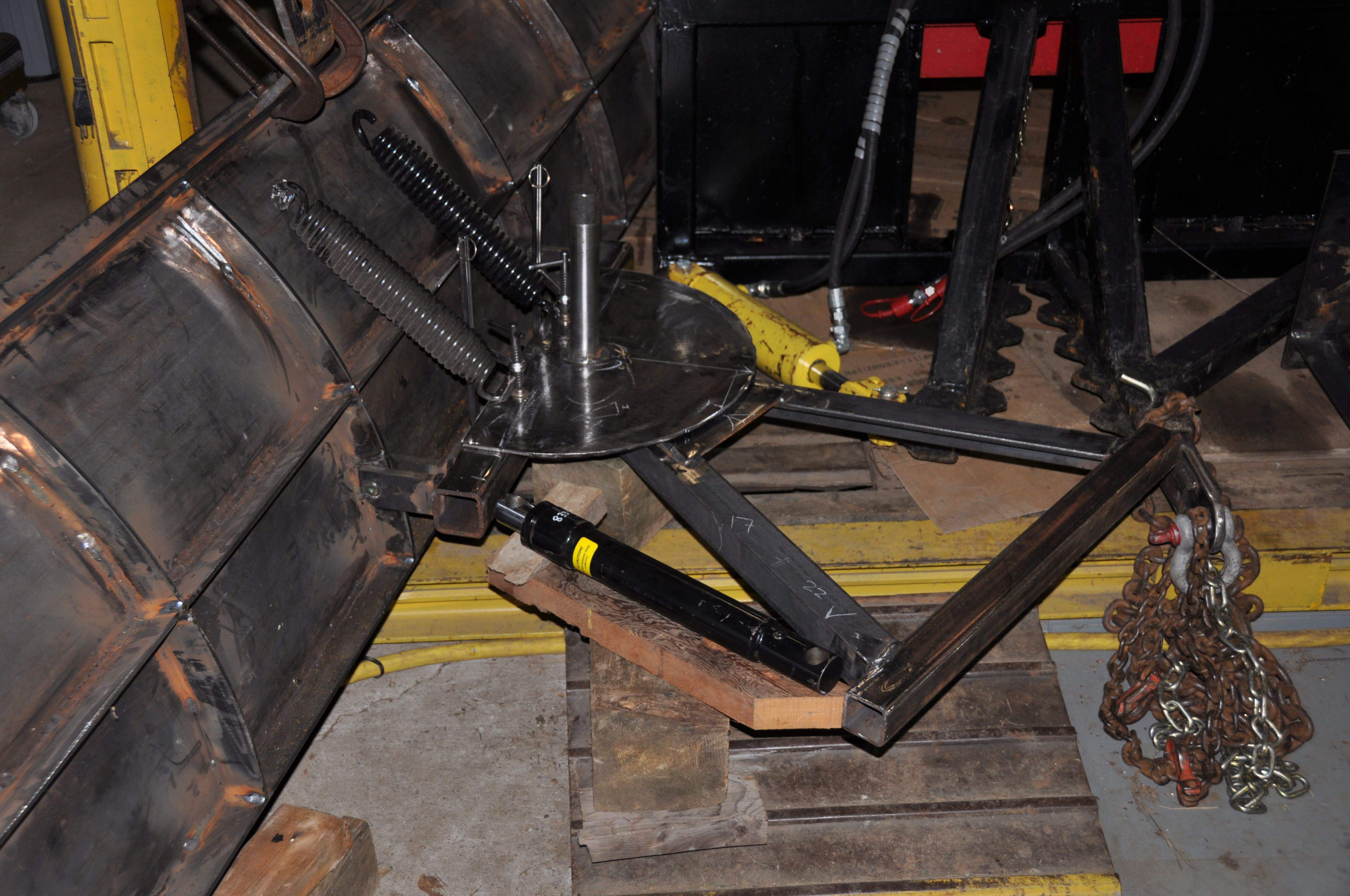

/ Snow Plow started
#29

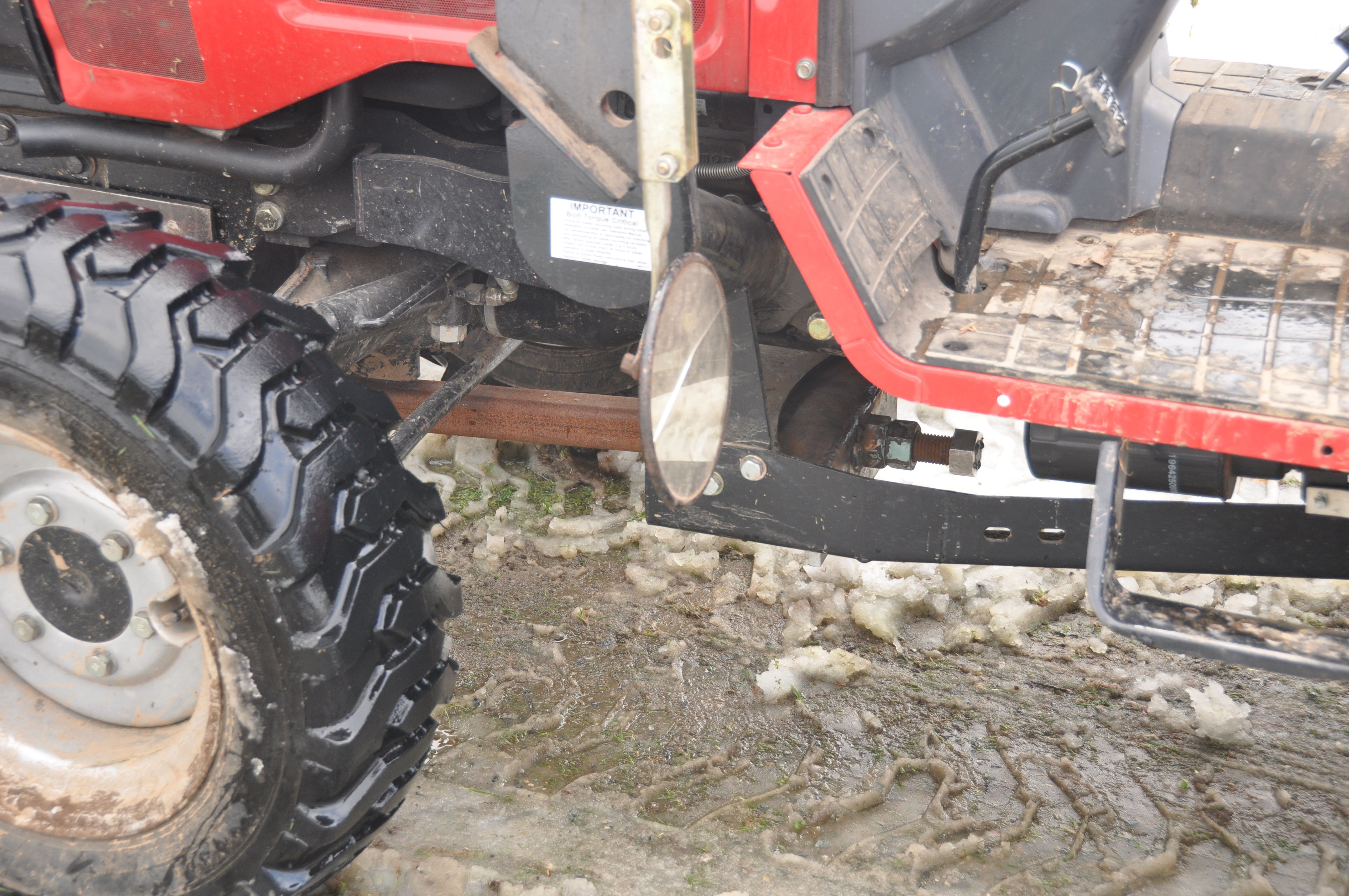

The snow plow is somewhat modular so that I can move around the small pieces without a crane(tractor). The front mounting plate on the plow frame slides into a slot (mounted to the front of the tractor) and is pinned in place. I have a piece of square tube going back that ties into the loader frame. I take up the slack with a large bolt that pushes on the end of the square tube. I had to get a lathe in order to turn down the end of the bolt so that it will come apart when the end mushrooms.
The loader frame is tied in at the rear of the engine and at the back of the tractor.

/ Snow Plow started #30
Very nice, you may want to consider adding one or two more trip springs, I have a feeling that blade will be tripping often on you.
/ Snow Plow started
#31
Skyhook
I have 2 more springs and the mounting hardware ready to go. I would rather add them if needed than break something. This blade is only18" wider than my last one so I figured 2 was a good starting place.
Cam

You will love that blade set up. :thumbsup: I still have my L3400 setup this way. I mostly use the bigger tractor now since I have chains and a cab for it. Are you planning on running tire chains?

I have tire chains for the R4 rears. The rear aux hydraulic lines do not have much clearance from the right rear tire (1 1/2 inches) and have not rerouted them yet. Another job on my list. I have some old car chains that I can make work on the front. As this is the first snow in 2 years I have not had the need to try.
A canopy is also an the list as well as reworking the skid shoes on the corners to save the grass.
