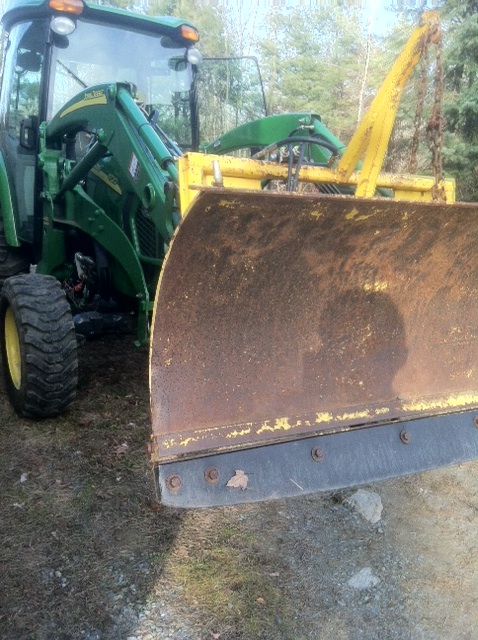

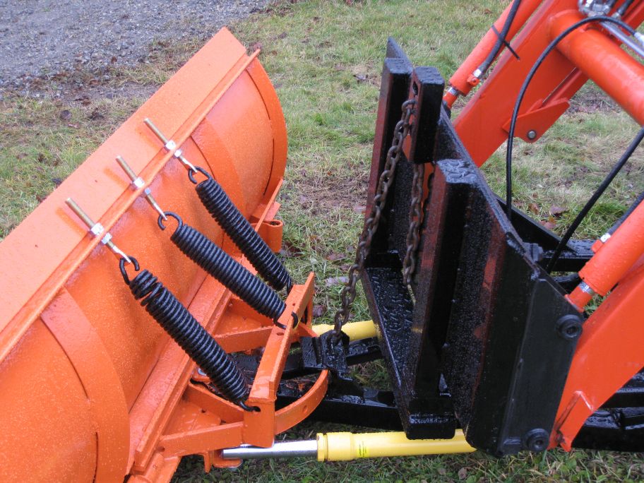

Attached is a shot of my 7' Fisher. I'm thinking of eliminating the lifting chain and replacing it with a solid steel connection so I have down pressure vs floating blade.
Any opinions out there? I plow on asphalt, asphalt millings, and gravel.

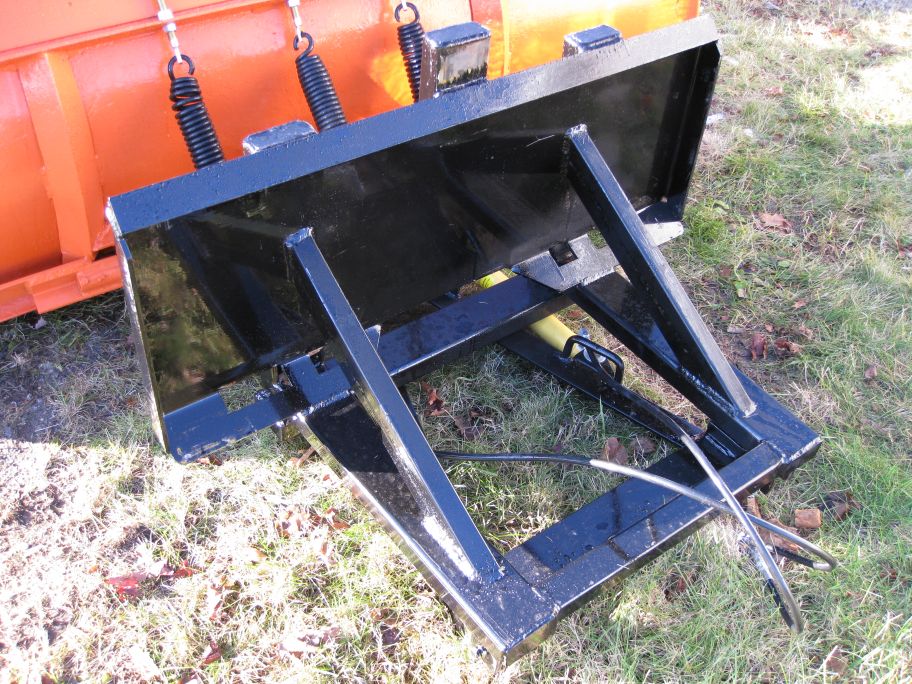

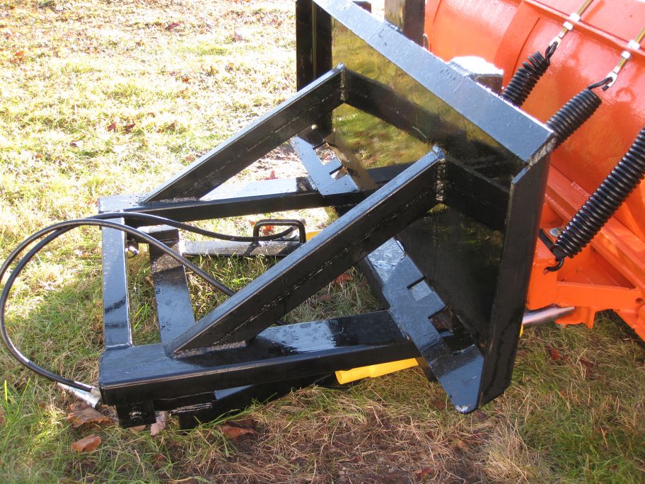

If the chain type is built proper you can still have down pressure??

When I built mine I ran the attachment points for the plow behind and under the SSQA plate. This way the plow doesn't stick out in front so far and I can use downpressure if I need to.
Jeff
Edit- Rayclar beat me to it. I did mine almost the same.

Thx for all the comments and opinions. I hear you all on the "shock" issue. My thought process is I am usually plowing in float position-at least once the frost is in the ground. Plus my Fisher has the spring loaded cutting edge-and the cutting edge is a well worn poly. I also have a cross connection valve so if I'm angled and hit something, I have relief.
I actually am going to have to take it off the blade and cut 1/2" off it as the ends are rounded. Being poly, it also doesn't cut as well as a steel edge would. Attached is a better shot of my set up.

Red Horse,
If I understand the pic correctly your blade is lifted by the chain?? If so, then you could set the FEL frame at a given height, with the blade on the ground and the chain slightly slack and have the blade float effect?? Looks great to me!!!

No argument-and I think I noted that I do plow in float position-but MNBobcats suggestion is a great compromise-- I will be plowing with a loose chain and in float. But when I'm cleaning infront of my doors- or trying to get hardpacked snow broken loose- I can put some weight on it-either pushing or backblading.
