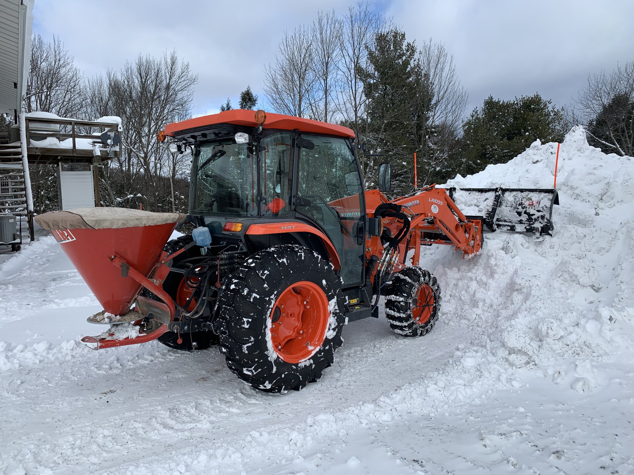

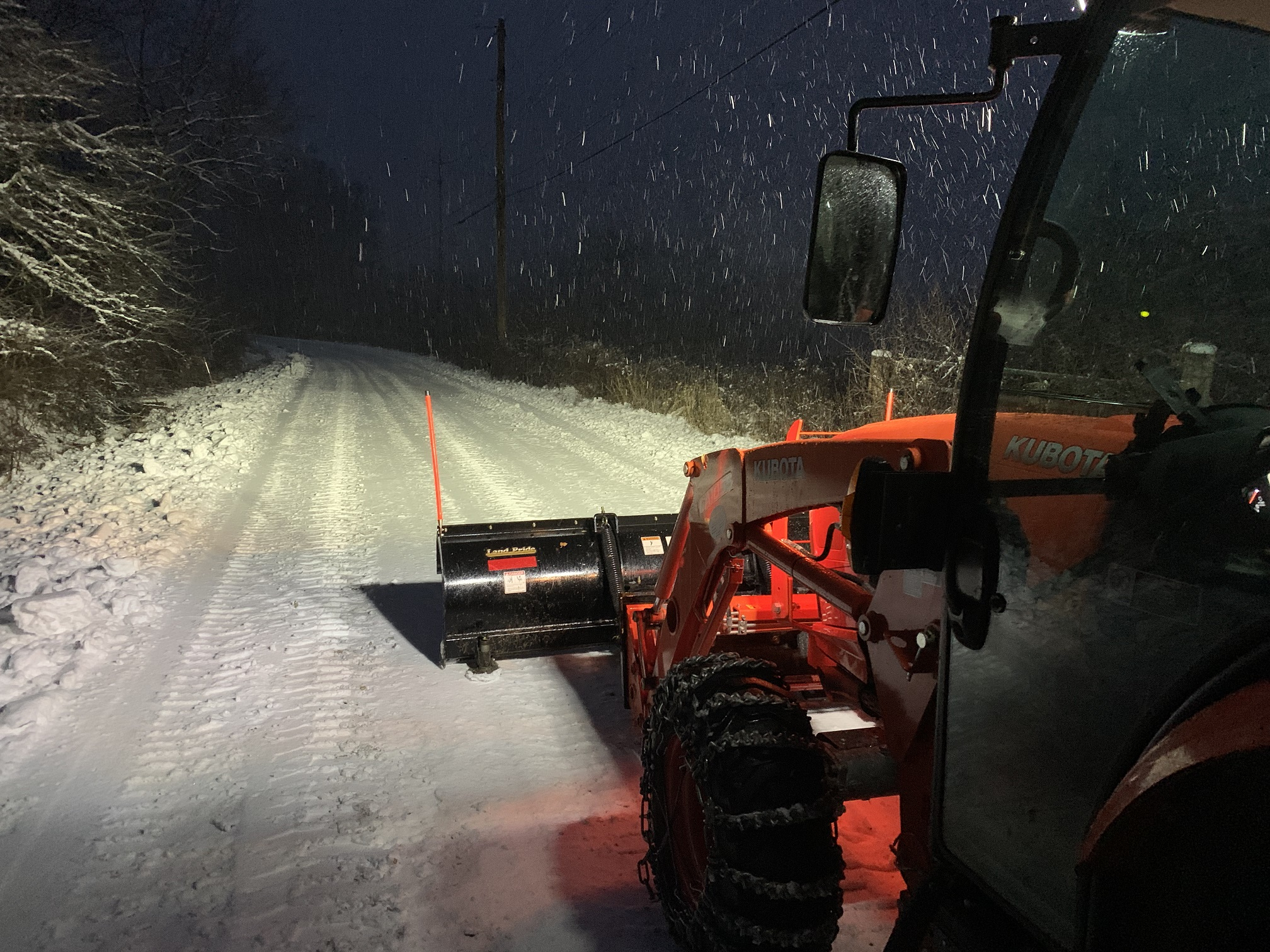

I've used FEL plows on all 7 of my Kubota's for over 40 years to plow 1.25 miles of private road. I did manage to break the FEL arm welds on the B7100 HST but I was using a 7' Western plow at the time which generated a bit too much side pressure on the small machine.
In my case, plow shoes are a must with chains on the front tires. To prevent side slippage or gain traction, I just lift the plow a bit to put more pressure on the front tires. The only thing I didn't like was plowing at -10 degrees during a storm on an open station tractor. Under those conditions, I would sometimes plow with the pickup.
My current rig is an L6060 HSTC with an 8' Land Pride blade. I find the ability to pile snow with the FEL to be very handy
The cabbed tractor is so comfortable during inclement weather that I sold the pickup plow.
FEL plowing takes a bit of practice but, due to the increased maneuverability, it saves considerable time over plowing with a truck.

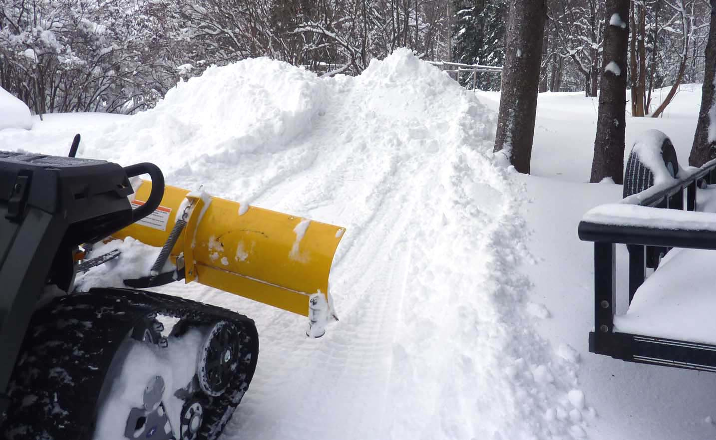

Some of use ever use a 6ft blade on a ATV! Love the darn thing. Can't got fast with it, but it pretty much retired our snow blower. We really do get snow here.

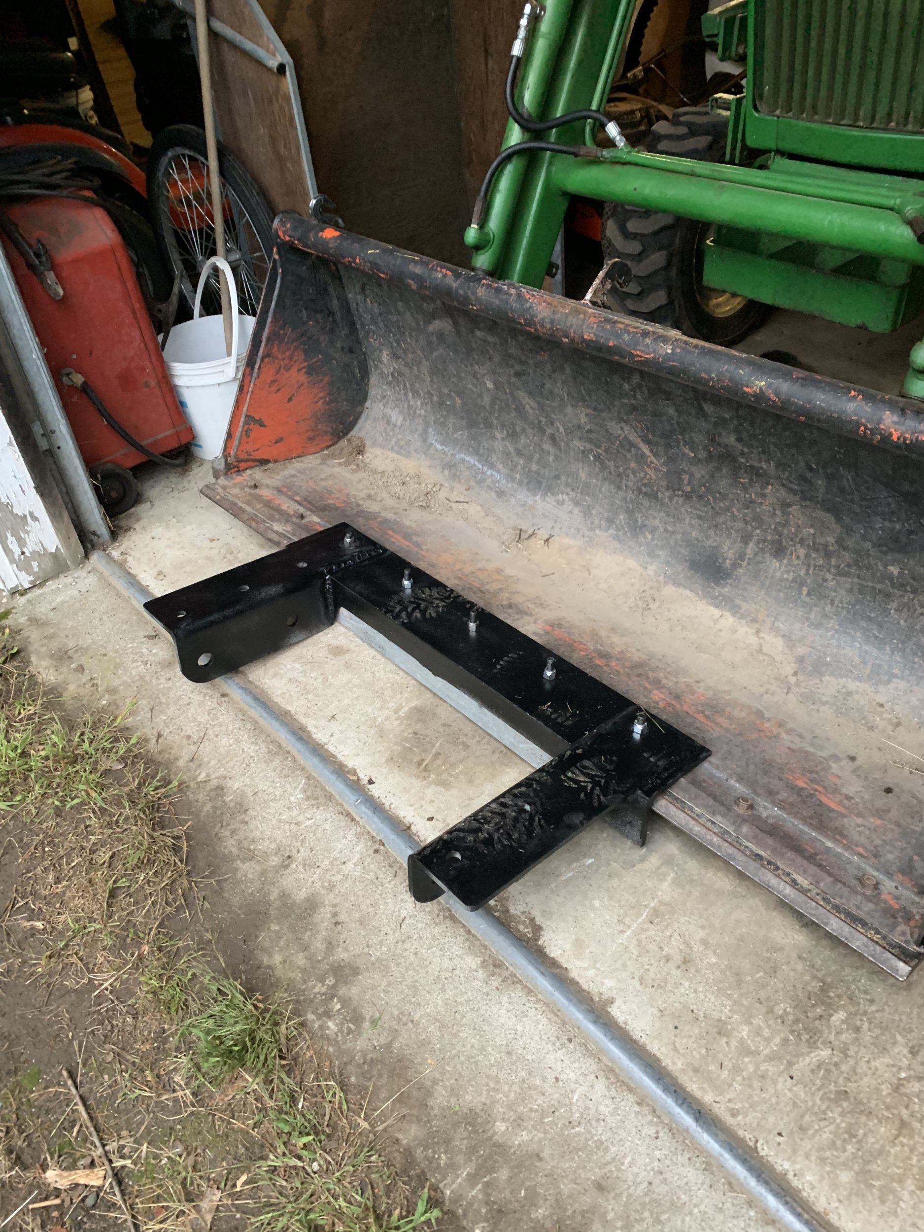

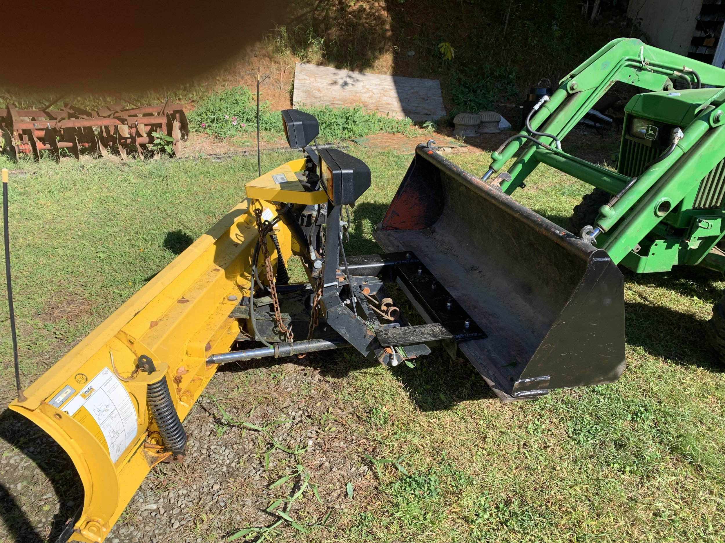

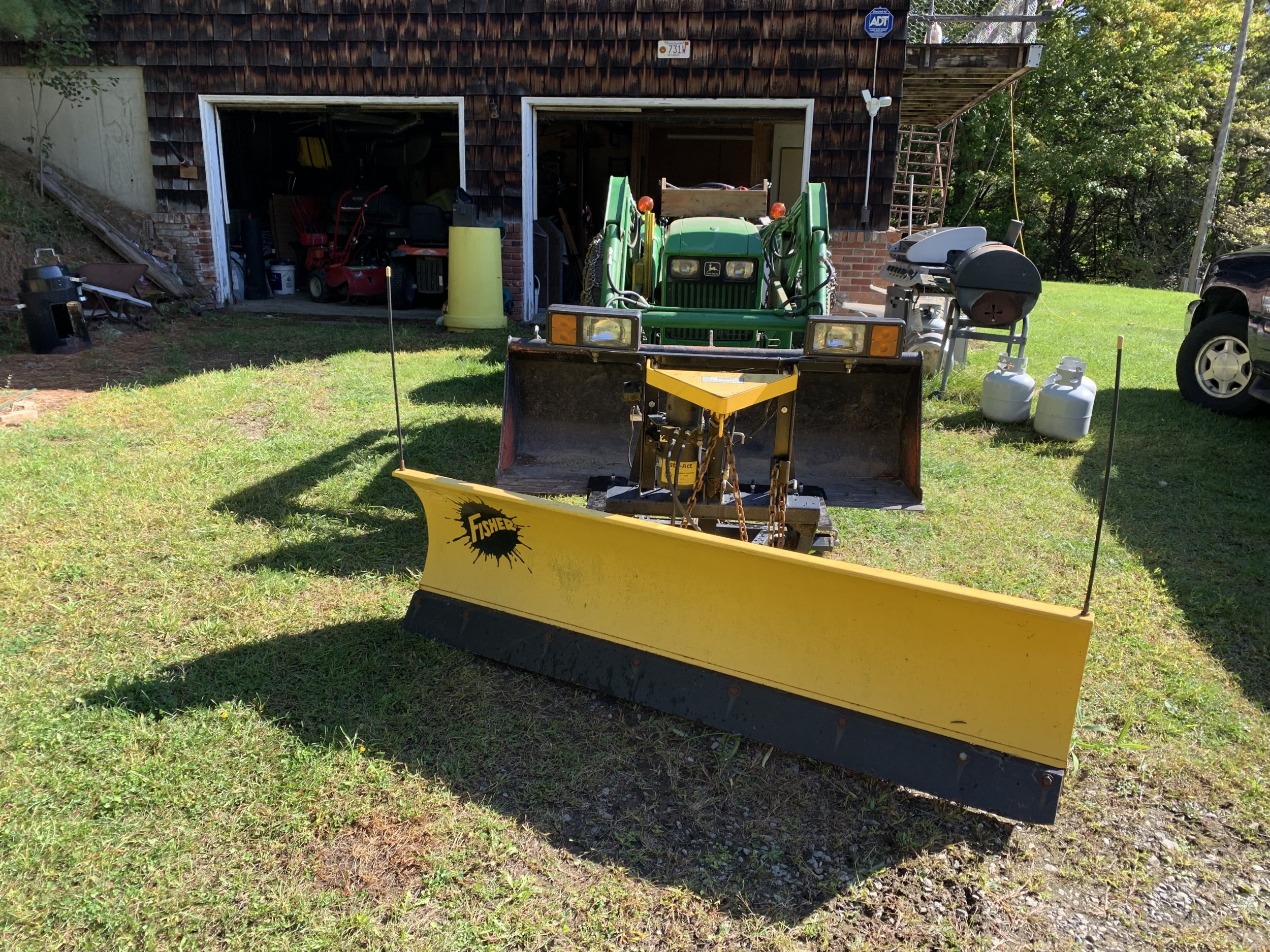

Can someone running a snow plow on their loader provide feedback on how well it works? I have an L2250 with FEL and am contemplating mounting a snow plow from my skid loader on it. The plow works great on the skid loader, but that's all I use it for. I'm thinking about selling the SL and fitting the plow to the tractor. Thoughts?
Works great on my little Deere 850
