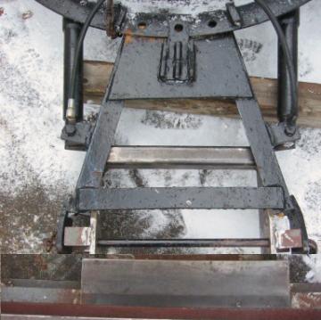

This is a mod for my quick attach loader that is finished but yet to be tried. This weekend I'm taking it up to the cottage where there is about 2 feet of snow. I hope all my measurments are right as I have not tried the new loader bracket on the actual loader. It has now been painted but I didn' get a pic yet. Wanted to make sure everthing was going to work. As I am new to welding it is definitely not a piece of art but should be built to last. I was lucky to get most of the steel for it for nothing so that made it easier. I didn't want to destroy the plow frame so I made so it could be removed with a long 3/4" dia pin. This way the plow could still be used on a conventional truck frame. Also this way I can just remove the plow quickly (1 pin) and use the new loader frame for another mod. Actually I plan to add a 2" reciever piece on top for normal hitch type attachments and definitly for a boom extention (next year). I put a new wear bar on and bought new skid shoes. The hydraulic cylinders are good and will hook up lines to control angle adjustment next year with loader controls doing the rest. I'll post pics and maybe a video clip next week. Hopefully all will go as planned
Thanks for looking,
Dave
Existing Loader
Cheap 8' Plow
New Loader/Plow Adapter

That looks good. As long as the snow is removed, looks are nothing. I was just wondering what the weight is? Are you going to need to put some weight on the back of the tractor to even you out?
/ Snow Plow Loader Modification
The plow probably weighs in at about 400-500 lbs, I can lift the bracket I made, so it is probably about 100-120 lbs. Given that, its 1/2 the loader capacity, so I'm not too worried except for the extra weight in the back for traction. May have to add some if I can't get enough grip. We'll see....
Thanks Dave

Just run around with a bush hog or something like that on and you will be fine. The problem is not the weight but the distance it will be form the tractor.

How are you going to hold the plow up? A chain? If so to... what?
My only comment is that it looks way to far forward of the loader, and I think you might have steering problems because the plow is so far forward, and you possibly risk torquing your loader frame because of the extended length.
Your fabrication looks top-notch though:D
PS. Just so you don't think I'm attacking you...I had a FEL plow that i had built myself-but got rid of it because of the loss of steering and the constant need for adjustment it requires to operate.

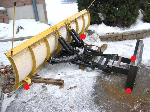

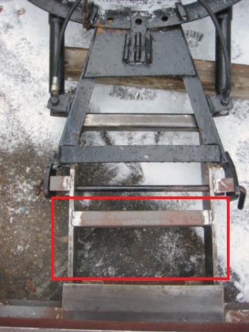

Nice fab work. I am interested in how it will workout for you. I agree with Kennyd about it being to far foward. You will definately need alot of weight on the rear of your tractor for traction. I was planning and still am contemplating adapting a blade I have to the front of my tractor. The thing I am contemplating is whether to put it on the loader or attaching to the frame of the tractor.
If you are planning on using the float postion on your loader I would reccomend putting skids directly under your attaching point to the loader and also the skids on the blade.
Another thing maybe shorten the center section on the frame. Looks to ba about a foot or so. This might help with having sit so far out but still having the stability.
I hope it is alright but I modified some of your photos to show you what I am talking about.
Either way it is nice to build your own things and use them.

If the float drops the plow down, the skid shoes set at the right will keep it where I want also taking some of the weight and strain off the loader frame. It sounds good in theory, hope it will work in practice.
But how will the shoes hold the rear of the frame up and level when there is a hinge between the attachment point(loader arms) and the shoes?
What happens in real life is this: As the blade pushes the snow and gets weight in front of it, and the tractor is still pushing forward then the front lifts up. The loader becomes the hinge point. So then you lift the blade a little to get some weight back on the front-but now you are missing snow!
This same thing happens with just the bucket on-try driving into a dirt pile with the loader in float. The rear of the tractor keeps pushing and the front comes up. It kind of wants to "fold in the middle" so to speak.

Great comments. I have new skid shoes for the front (blade). I wasn't going to put on the back (frame) but may have to. As needed, if I have the loader raised a little and then angle the blade down a little to compensate it I thought it would do the trick although not tried yet. I know it is out a little far but I was hoping to use the same adapter for other uses and not having to make another for the loader thats why it is a little far out. I have my info under my profile but it doesn't appear to show up. Anyway, I have a DF354 (Dongfeng). 35hp, weighs about 4000 lbs. with loader, width with wheel set in about 66" (plan to move them out next year for a little better stability), loader has a 1200lb capacity, rear lift about 1500lbs.
I figured any big banks I would use the bucket, and everyday plowing (usually not too much snow and weight) , this set up would be ok. It wouldn't be quite the same as moving into a pile of dirt. I figured the snow will be a fraction of the resistance of a dirt pile, but I definitely appreciate all the comments. Its making me think of all the possibilities of what will & will not work. Piloon- saw your setup.. very nice. Hope mine works as well as yours.
