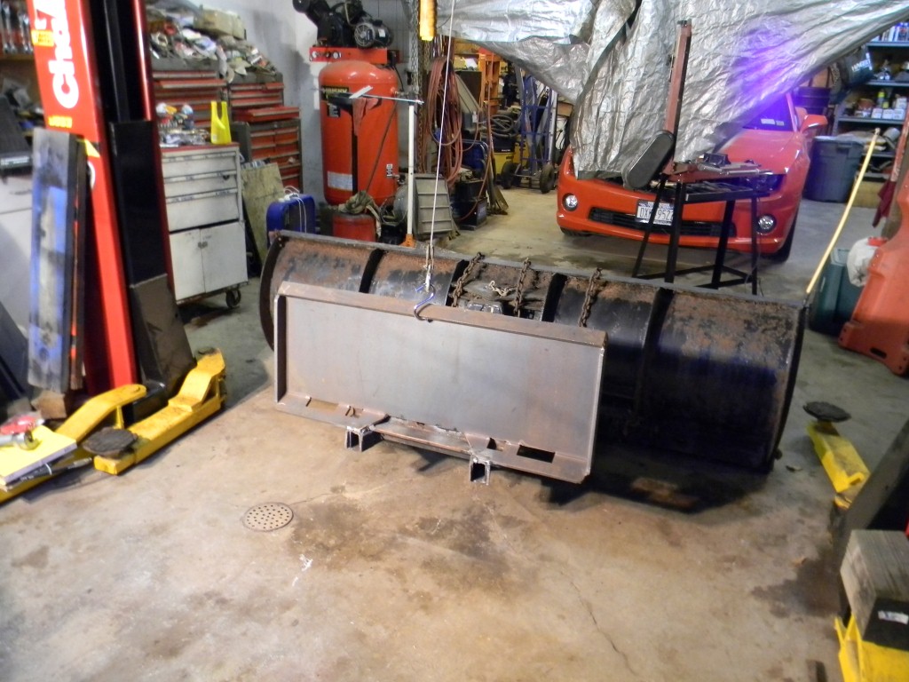

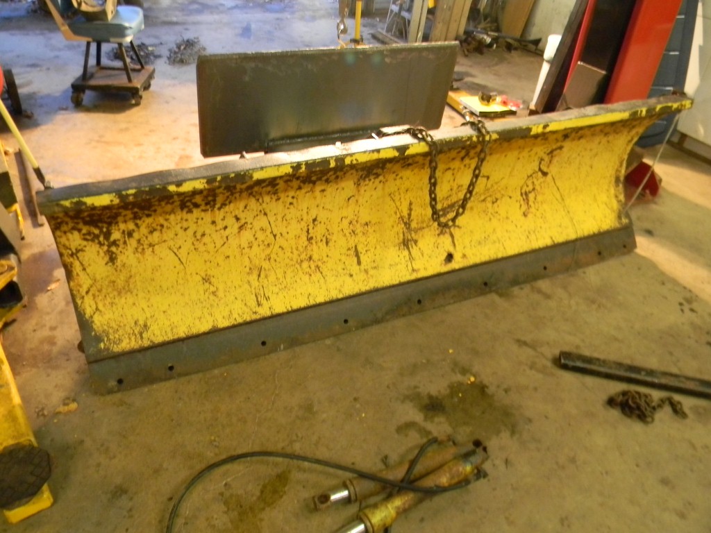

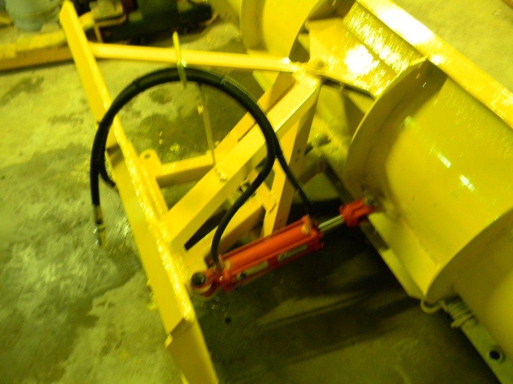

Started my snow plow build today. Had an old 7'6" Diamond snow plow just hanging around taking up space so figured I'd put it to use on the tractor. Received a Quick Attach plate today ordered from Titan Attachments. I got the heavy duty plate 1/2" thick. Started tacking it to the plow A-frame this afternoon. Going to weld some angle from top of A-frame to top of QA plate. Plow shoes and guide flags on order. Have a new D.A. cylinder, hoses, and fittings. Still have to locate a crossover relief to work with a D.A. cylinder. The cylinder from Tractor Supply has an 8" stroke which gives about a 25 degree angle each way.

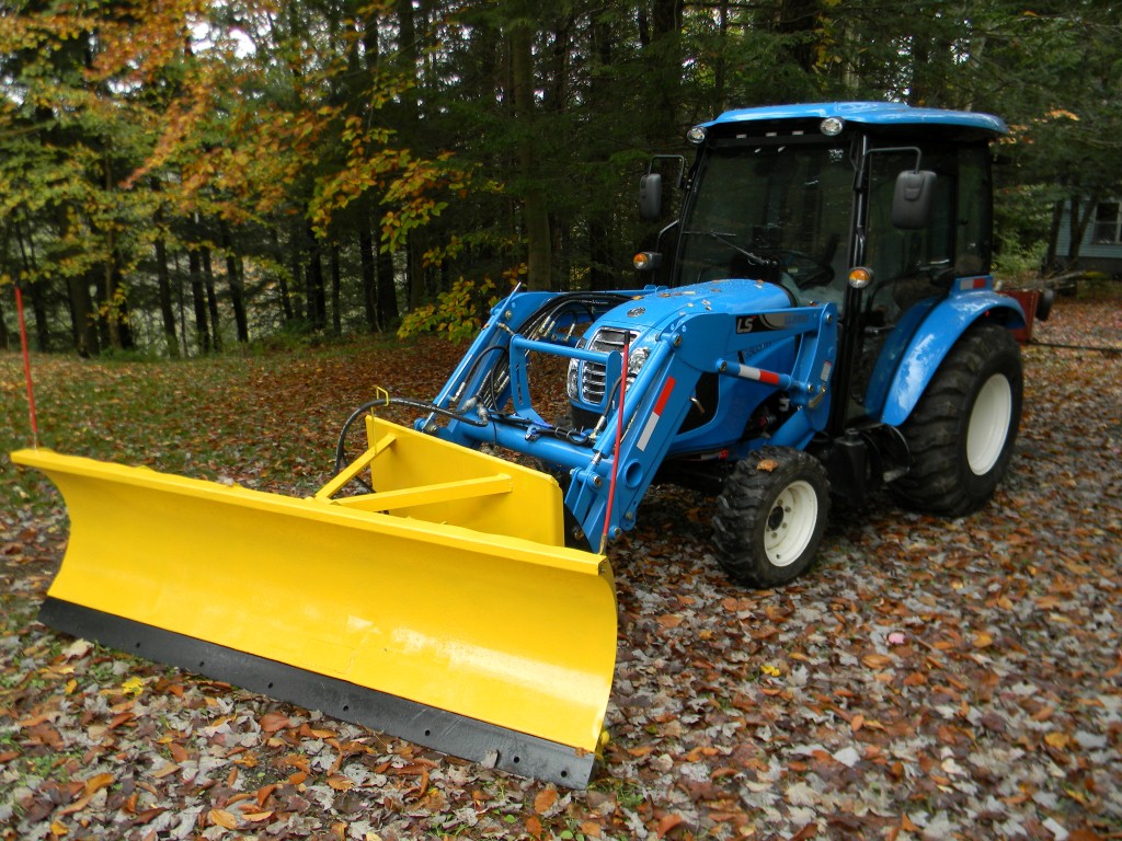

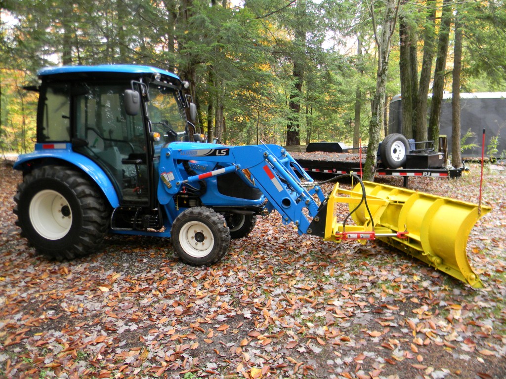

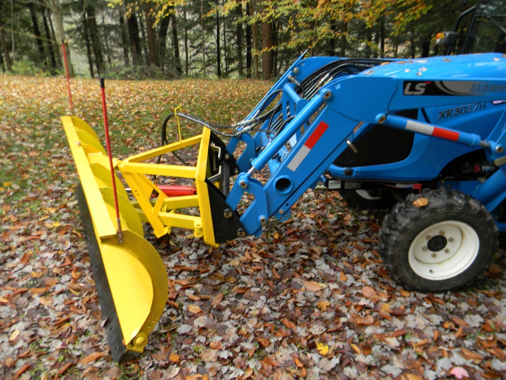

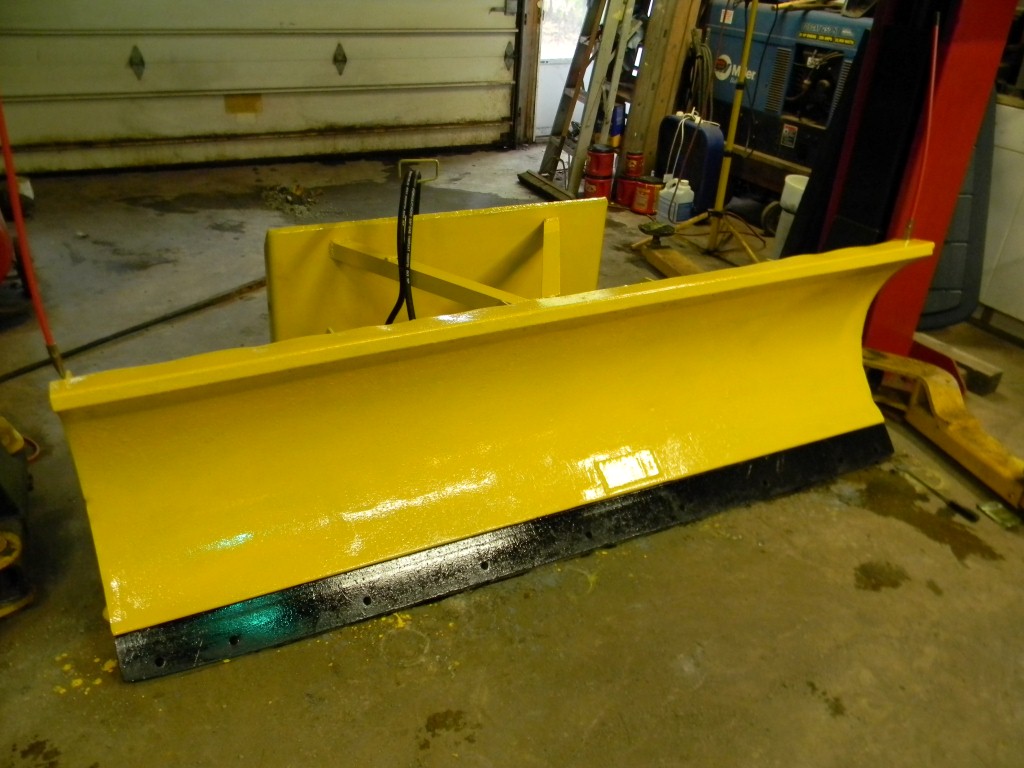

/ Snow Plow Build

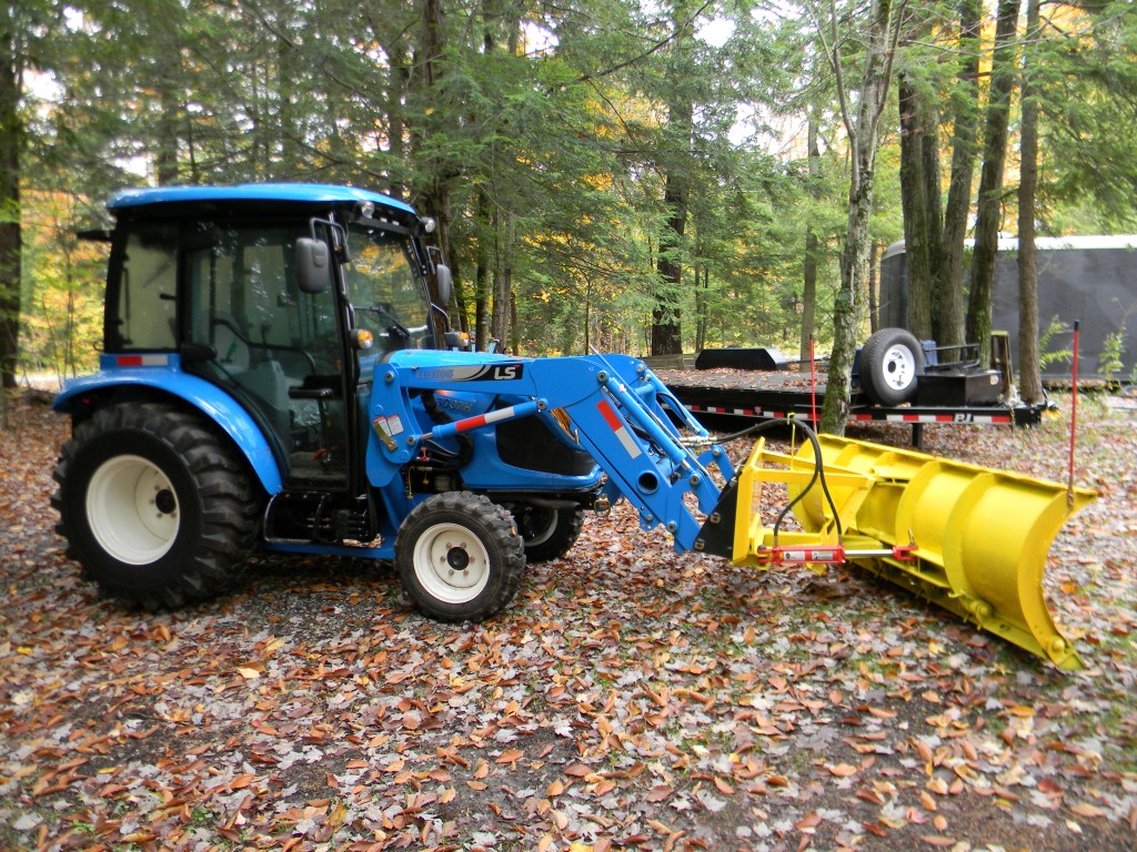

Finished up the plow. Only things I have to get are the cushion relief valve and plow shoes. Going to check local shops tomorrow for them. If not, will order. Paint was still wet in pics. Put it back in garage with salamander heating it up to dry. Outside temp. only 45 deg F. now, was 36 this AM. Pics are out of order.

/ Snow Plow Build
#9
Looks good,sure to get a lot of use in Central Square!
Yes it will. As you must know, we average between 140-160" per season. Between the plow, a 7'6" snow push blade, and the bucket I should have it covered.

I'v never seen a hydraulically angled plow with one cylinder. Is that normal?
I've seen other tractor plows built this way. The original cylinders (2) from the old plow were rusted out and trashed. I'll see how it works this winter. If I have problems I can always buy and install 2 cylinders since I didn't cut off the mounts on the A frame for them.

I'm going to check local shops tomorrow for a cushion (pressure) relief valve. If I can't locate one locally I'll order one. It works the same on one or two cylinders to bypass the fluid, if you hit something solid, to the other port on a DA cyl. or other piston on a dual cyl. setup. You'll need one for a 2 cyl. plow setup also.
QuickAttach and HLA make and sell single cylinder SS snow plow attachments.

/ Snow Plow Build #15
I tried building mine on a rigid frame like that.
I quickly discovered, it needed the ability to float, and the ability for it to rotate a few degrees side to side, to adjust for changes in the grade.
Otherwise, it has the potential to put lot of strain on the loader frame.
Keep in mind, you can't use the float mode on the loader. It will put the loader arms on the ground.

I know I'm careful plowing (over 35 years experience) but for under a hundred bucks I'll install the crossover relief.

When I'm done the plow blade will have 2 shoes and the back of the A frame will have 2 shoes so 4 shoes total. I just have to make sure the 4 shoes are in contact with the ground. As long as the A frame is level the plow can angle left or right without digging in. I'll probably not use float mode and keep the blade an inch off the ground to keep the extra weight on the front steer tires.

A crossover valve wont work with a DA cylinder. Differing amounts of fluid.
When trying to collapse the cylinder, it will try to bypass MORE fluid to the rod side than it can hold. Since hydraulic oil wont compress, its as good as not having a crossover valve at all.
When trying to force it to extend, you have to create ALOT of vacuum around the rod seal, will likely suck in contaminates and dirt/water and have limited effect on acting as a cushion.
Not sure what you paid for the DA cylinder, but you can get a PAIR of 1.5x10 SA cylinders for ~$70 delivered. Then you KNOW the crossover protection will work perfectly.
