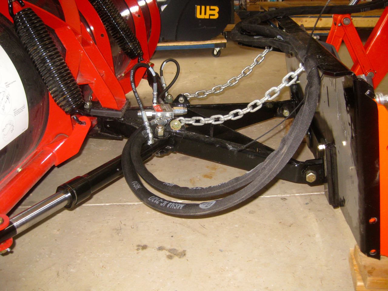

This looks really interesting and would solve the issue that I think is the problem..... too much weight. I agree that there is too much weight pushing down that adds to the digging in. Would it be possible to get a few more shots of how exactly that is made. Someone mentioned earlier in this post about hanging the blade by chains and I couldn't quite picture it, but now I have a general idea and I think this would solve alot of my issues. This would be the reason why the quad blade works so well, because it's just the weight of the blade pressing down.
Here's a few more photos:

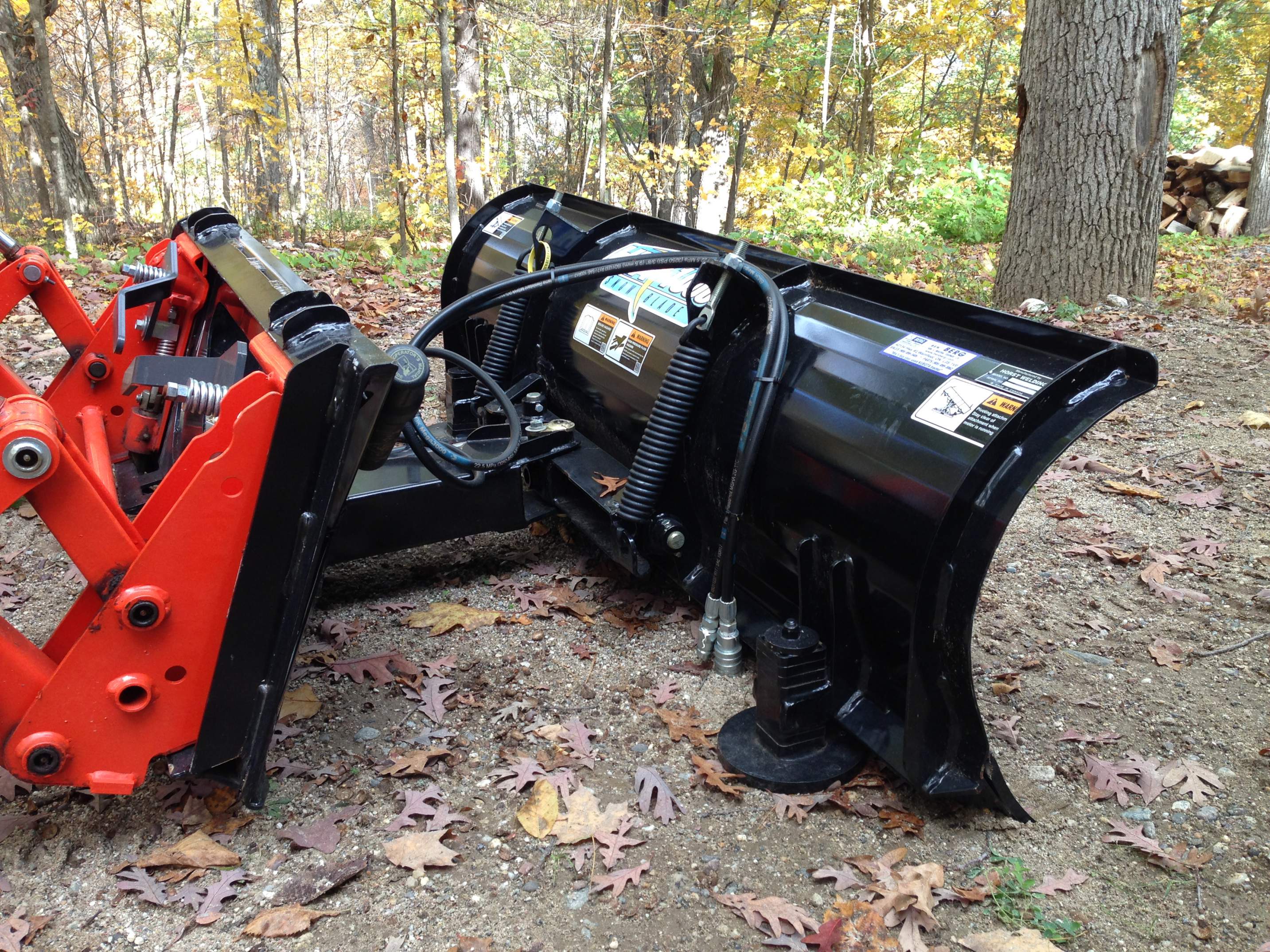

This shows how the blade can move up and down off the SSQA plate and also how it can oscillate (rotate) around the center bolt. One good thing about rotation is that it can correct for the tilting of the blade when it's angled.
And a side view of the rubber edge that I put on after removing the steel edge that comes with the blade for unfrozen gravel:

Thanks oldafretired, that's a cool set up and the pictures give me a good idea how its made. Is that a metal plow blade frame and a poly blade bolted to it. If so that would make it real light. Does the oscillation function just rotate on its own with the angle/contour of the ground. I have some areas around buildings that I plow that have a grade to them for shedding rain and snowmelt away from the building where that would come in real handy.
Hiniker makes two versions of the Big Ox Plow. One is the CUT version like mine with the poly blade, the other is the skid steer version with a steel blade. The guy that made the video below has the steel version on his Kioti. The video shows how the blade moves independently of the loader arms. He was the one that suggested this plow.
