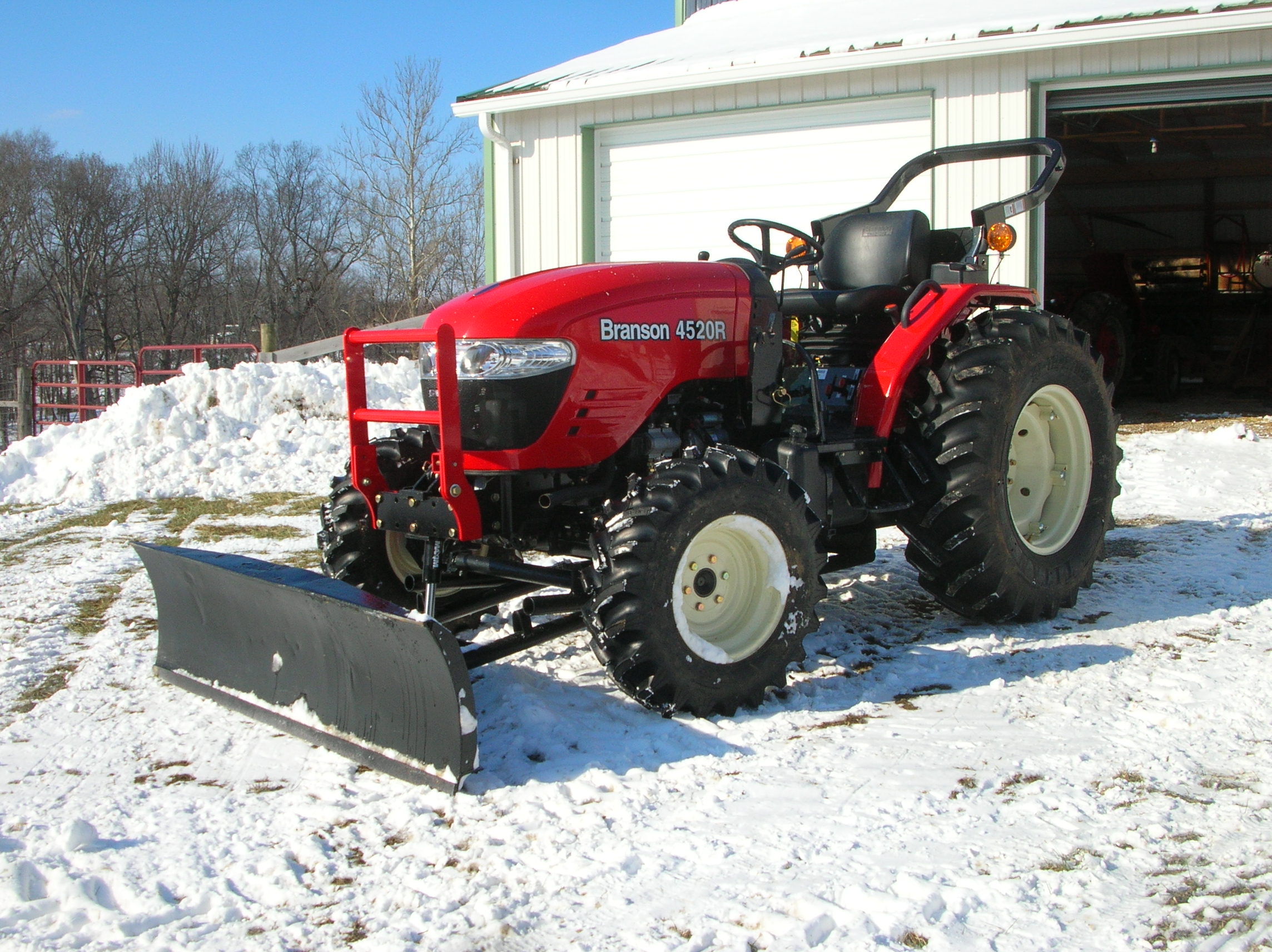

I've tried them all and you already know the best solution, a front snow blade. Build one. Buy one, but get a front blade for the tractor. It will move more snow than the ATV, and won't mess with your back (at least near as much), as hanging anything on the back. Keep the FEL handy to move any piles later as/if they build up enough to be problem.

This is my blade setup.
