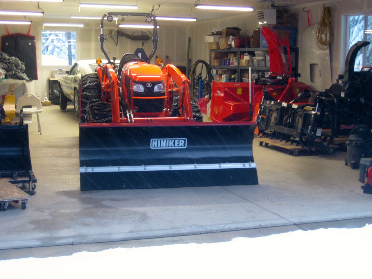

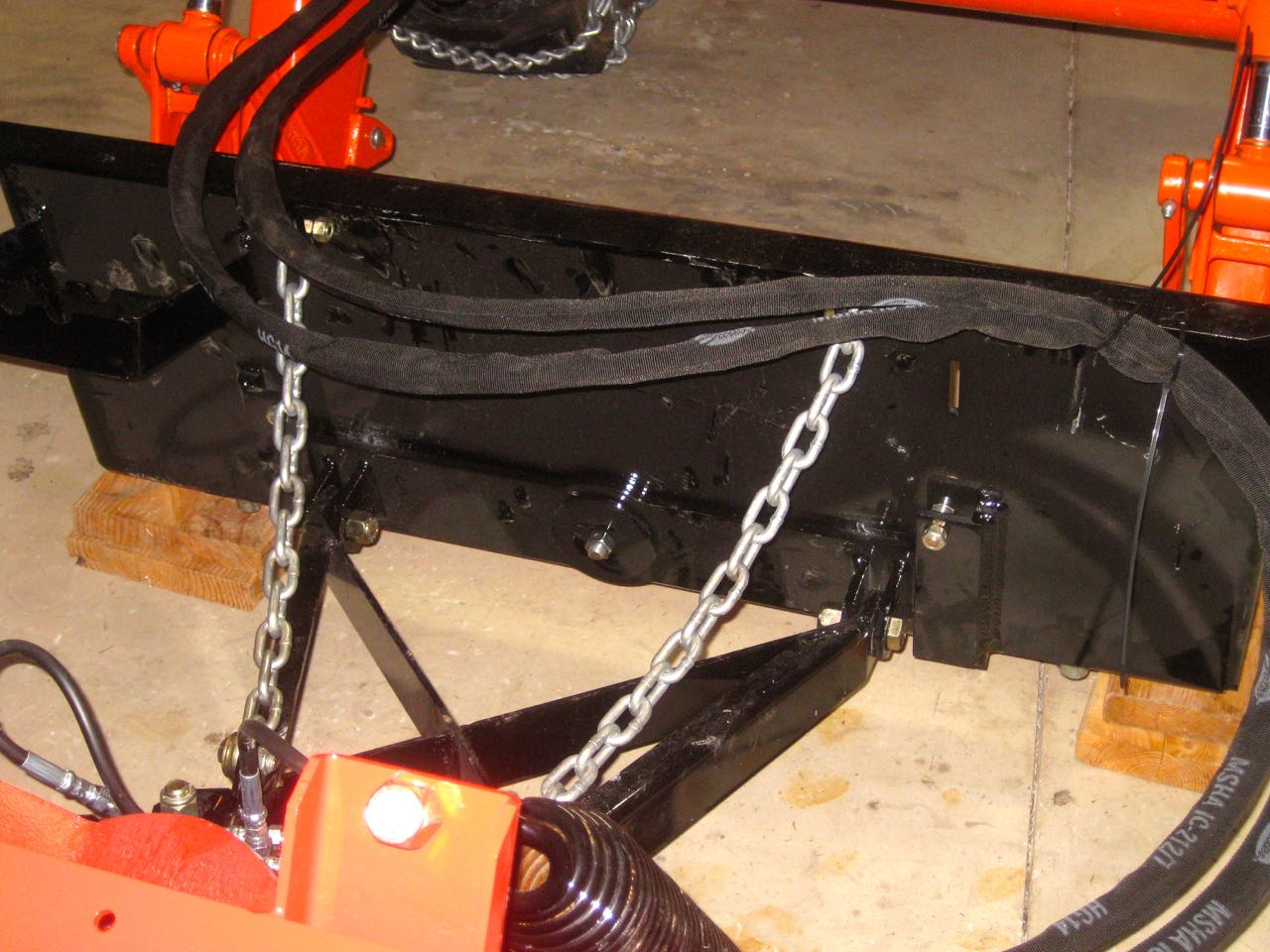

What works for me when the gravel drive isn't frozen over is a tall rubber edge on my front plow. The rubber edge bends backwards when moving forward and just sweeps over the gravel.
My new front blade floats independently from the SSQA plate and it also has lateral oscillation. I just set the loader height so the blade can float on its own so only the blade weight and not the loader arm weight rests on the gravel.

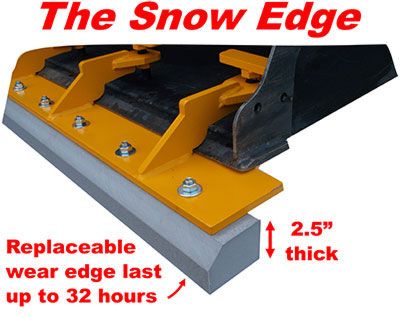

I purchased the snow edge two winters ago and I've been very happy with it. It changes me from a novice operator to an "operator". the angle of the FEL can be anywhere from level to 15 degrees off and it doesn't matter. I originally got it to save the blacktop coating but it just improves the chore totally...

A SSQA blade that floats independently! Oh boy, might need to sell my HLA blade now....

This looks really interesting and would solve the issue that I think is the problem..... too much weight. I agree that there is too much weight pushing down that adds to the digging in. Would it be possible to get a few more shots of how exactly that is made. Someone mentioned earlier in this post about hanging the blade by chains and I couldn't quite picture it, but now I have a general idea and I think this would solve alot of my issues. This would be the reason why the quad blade works so well, because it's just the weight of the blade pressing down.
