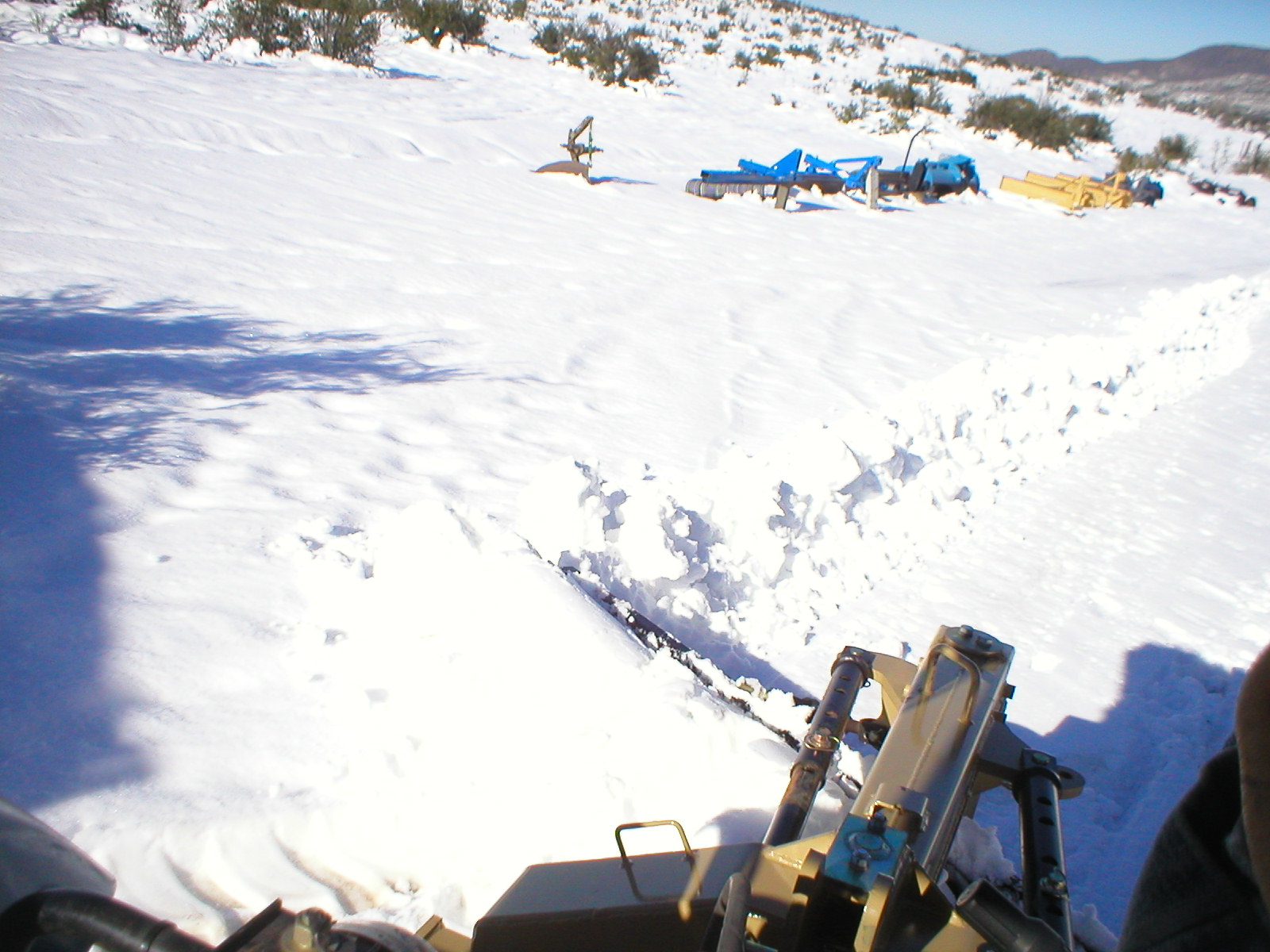

A rear blade would be a good start to taking care of things. I know that you said that you don't have much snow, but from what I have read here on TBN a rear blade sure seems to do the job better than a box blade. I don't have much to deal with either, but when it needs to get moved, I use my rear blade. ;)
