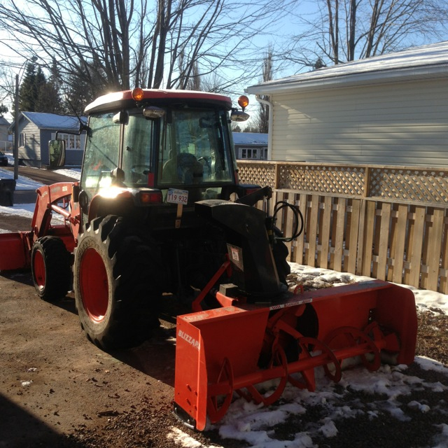

I use a L4740. Never thought I would need chains for snow removal until the other day a person approached me to do their driveway as i was fuelling up. Man was the upper part steep. They had the upper part shovelled and I slipped and slid my way to do the lower part. Chains required but it would take 1/2 hour or so to put them on. Bad business to be doing snow removal on a steep and slanted icy driveway without chains. Wasn't sure where I was going to land.
