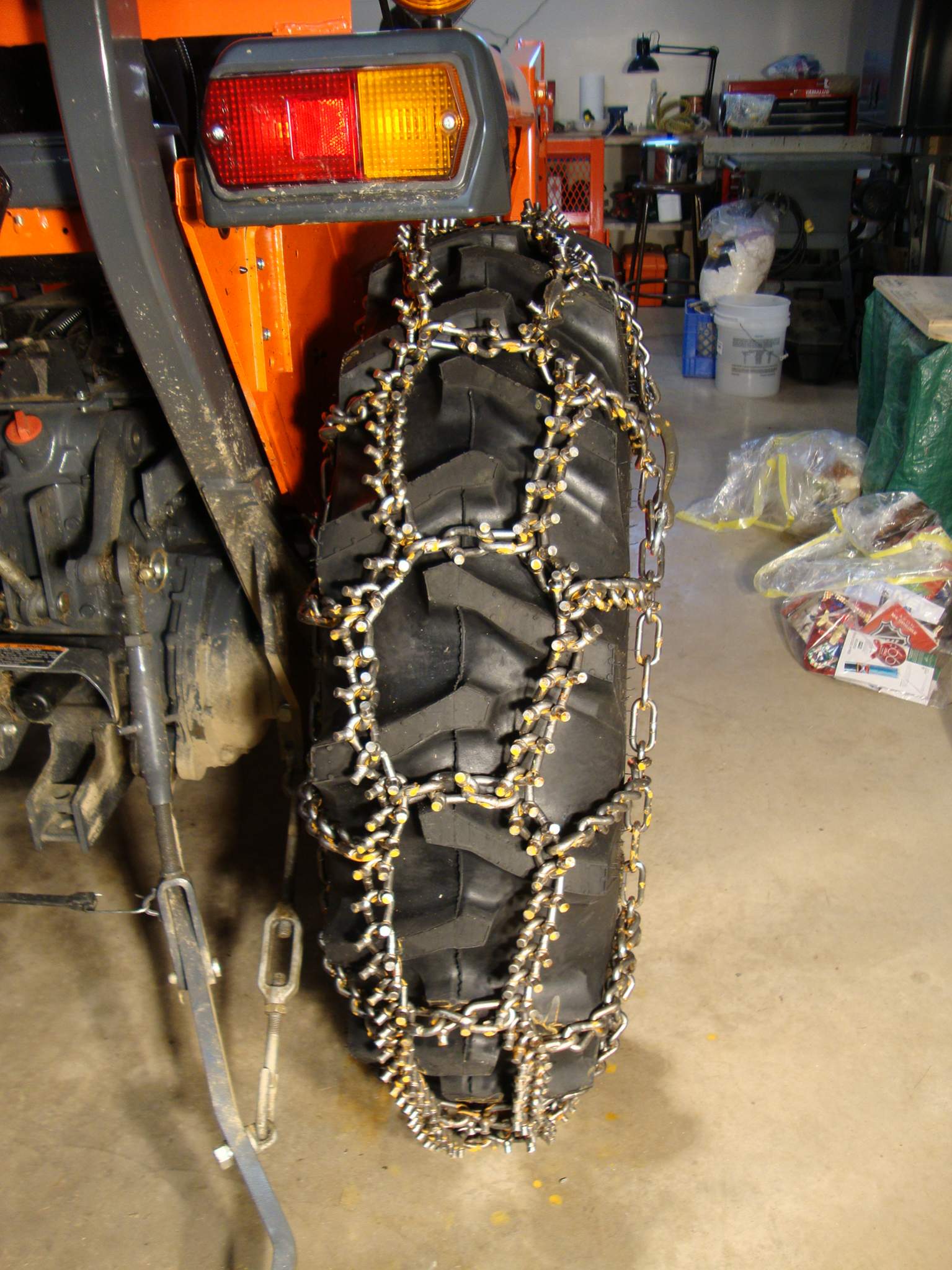

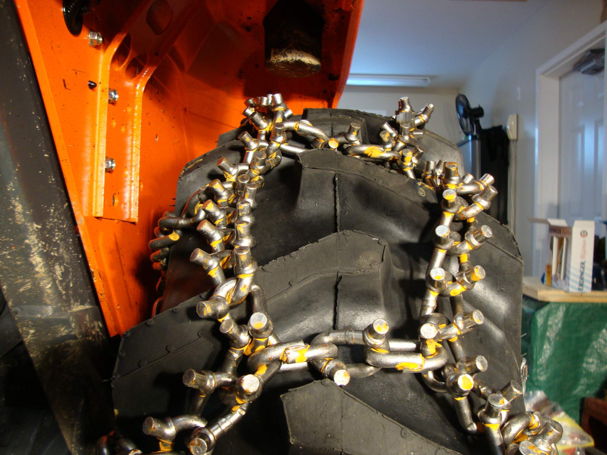

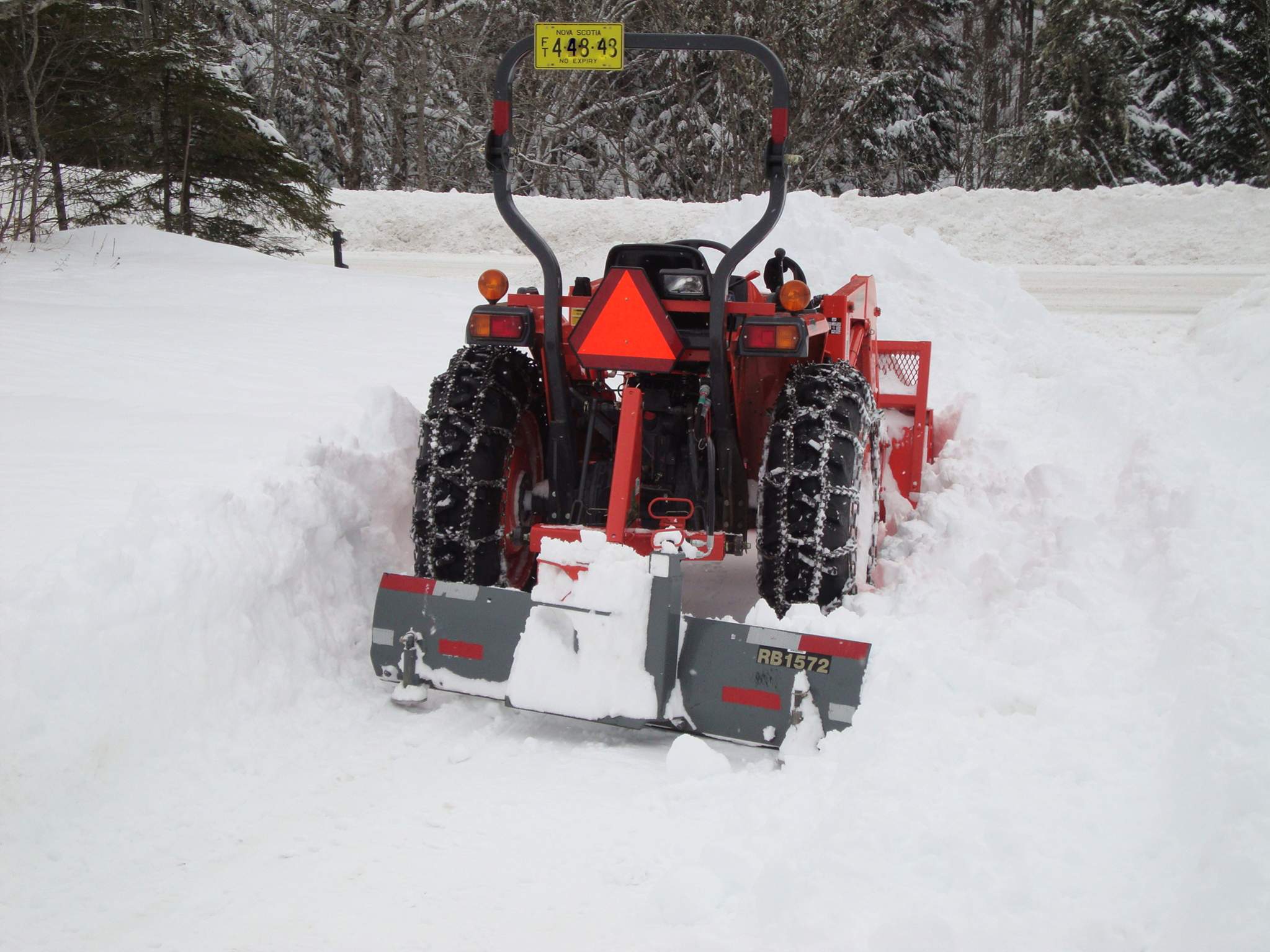

I've just started looking at chains for those snows accompanied by ice we are getting more frequently now. The last part of my mile gravel drive is a long hill up from my home. Sometimes it ices and the tractor just won't go up pushing... Or sometimes at all. But would I be better putting the chains on the front or back wheels on my 4WD JD? I see both referenced on TBN. I've seen chains around here only on rear wheels, but there are some reasons to have them on the front too.
/ Snow chains on yet? #93
Check your owners manual. Some tractors are not set up for chains in the front both on clearance with the steering linkage and the loader arms. Others don't like the extra stress put on the front driveline so just chaining the rears is advised.
/ Snow chains on yet? #94
Your tractor is about the same size as mine, unless you have one **** of a hill you won't need front chains. I can make do without if I really had to, but can't use the machine to it's full potential. I'd recommend getting them for the back first, then if you still have trouble look into chaining the front if you can. Also there are chains, then there are better chains.. I got these from my Kubota dealer, made by Tellefsdal. Smooth running good quality chain with great traction. They're hard on paved surfaces though if you spin them.
Sean
