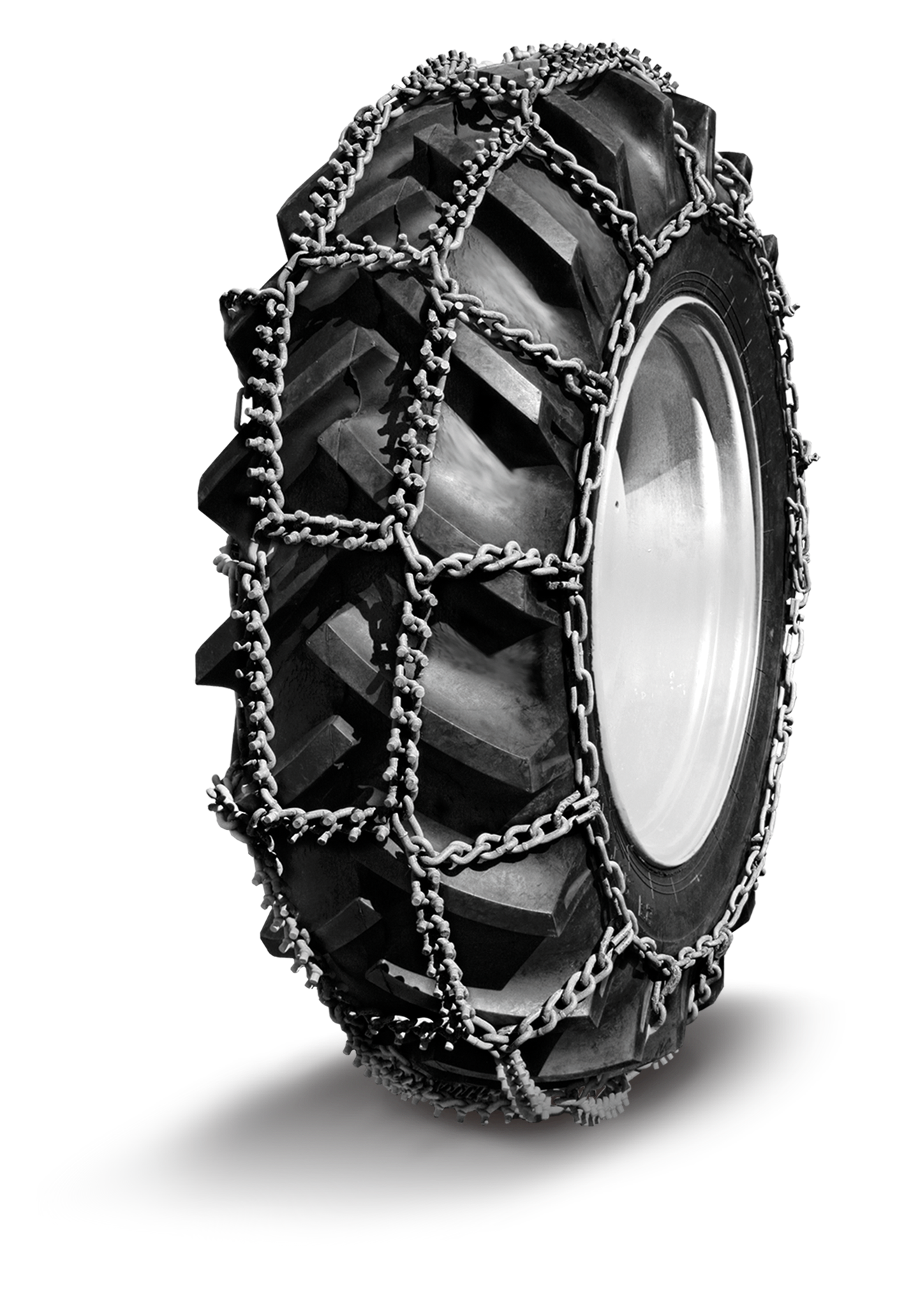

The only style of chain I could ever recommend is the studded Euro type such as the Aquiline Talons, or the OFA's, or the TRYGG SMT's.
Tractor and Snow Chains | Products | OFA
I have used all of these brands and have been pleased with them, my last ones were OFA 9's
One set of the TAPIO's they are quite agressive, last year I got 3 pair of the Eko 9's. Mainly because they cost less.
This picture is the Eko 9's;
this style of chain has the best traction and the best ride characteristics of any tire chain,

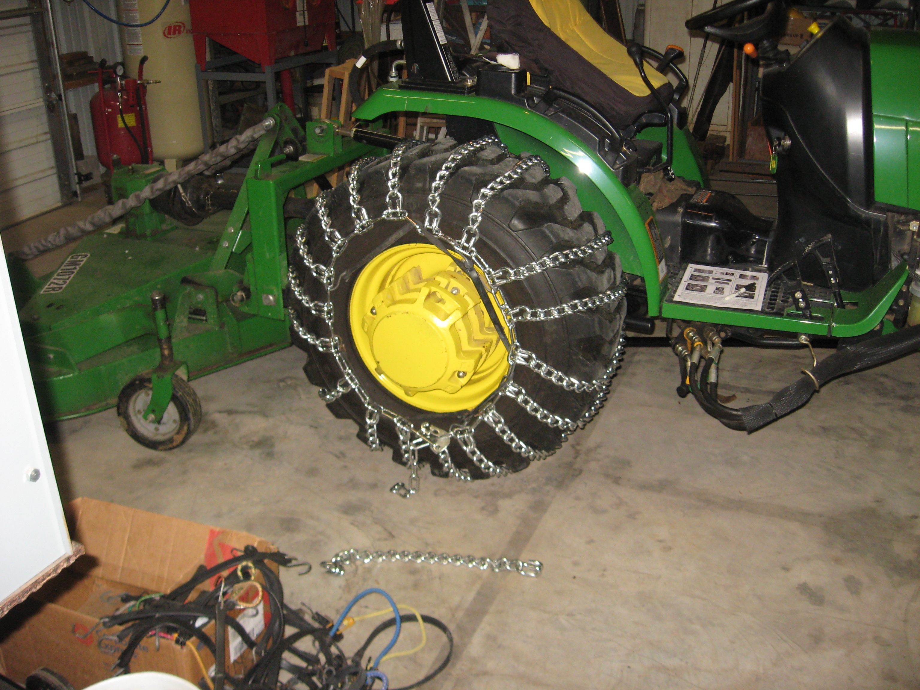

I ran ladder style chains on my Ford 1700 4 WD. They were a REAL PITA to install because they were so BLOODY heavy. But once installed - all four wheels - I could climb right up the side of my tool shed. They made the tractor ride like a cob.
Chains on the rear tires for traction. Chains on the front tires for added traction and steerage.
Their cost is now not material. Bought them thirty years ago. In 2009 I bought the Kubota M6040. All loaded up it weighs a tad over 10,000 pounds. It's heavy enough to plow my mile long gravel driveway w/out chains. I have a Rhino 950 rear blade for plowing snow.
If, for some strange reason, I had to buy chains again - Aquilline Talon tractor chains. More aggressive than ladder chains and not quite as heavy( weight wise ). And the ride is supposedly better.
Man - I mean to tell you that set of chains I had were REALLY heavy - weight wise. Bought them at Les Schwab tire store.

My Aquiline Talons in 18.4-30 are about 230 pounds for the pair, My Eko 9's for the same tire are the same weight, for the 18.4-32's the Eko 9's are about 240 pound for the pair.
