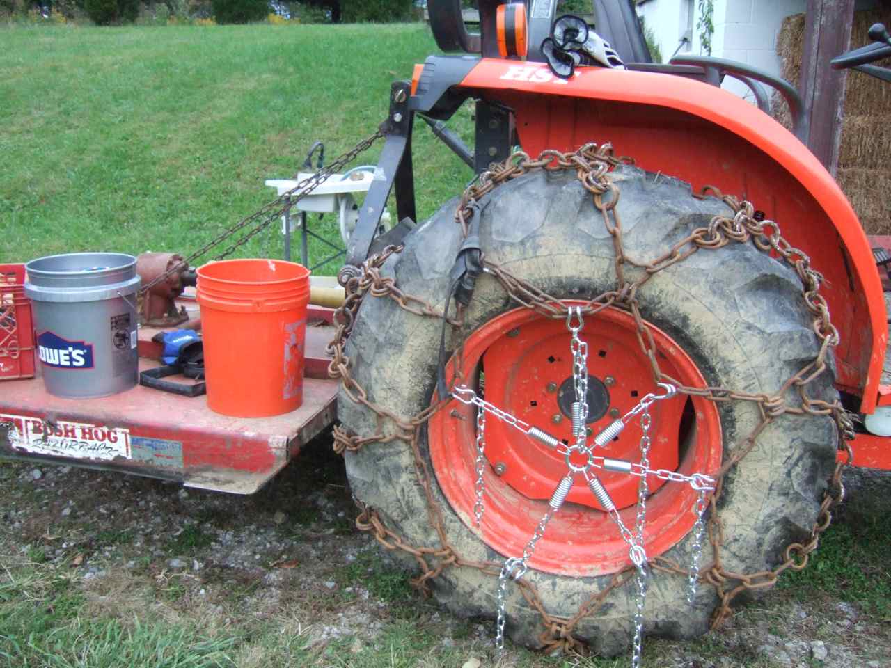

Those spider bungies are sweet! I'm going to call them tomorrow to see if they make a set that will fit a tractor tire. I had clearance issues also and got the tighteners that are in the attached picture. Since then I moved my wheels out and now have good clearance. Problem is, these the top of the line spring tighteners work great but take as long to put on as the chains do. That spider bungee would be all I need now.

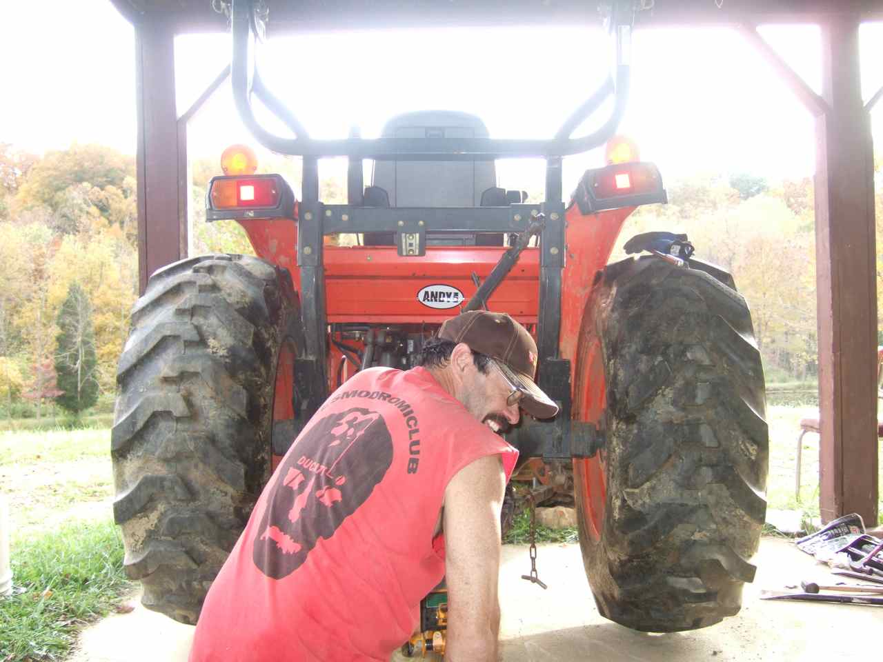

PS here's also a picture of my buddy when we moved the wheels out... left is in, right is out.
