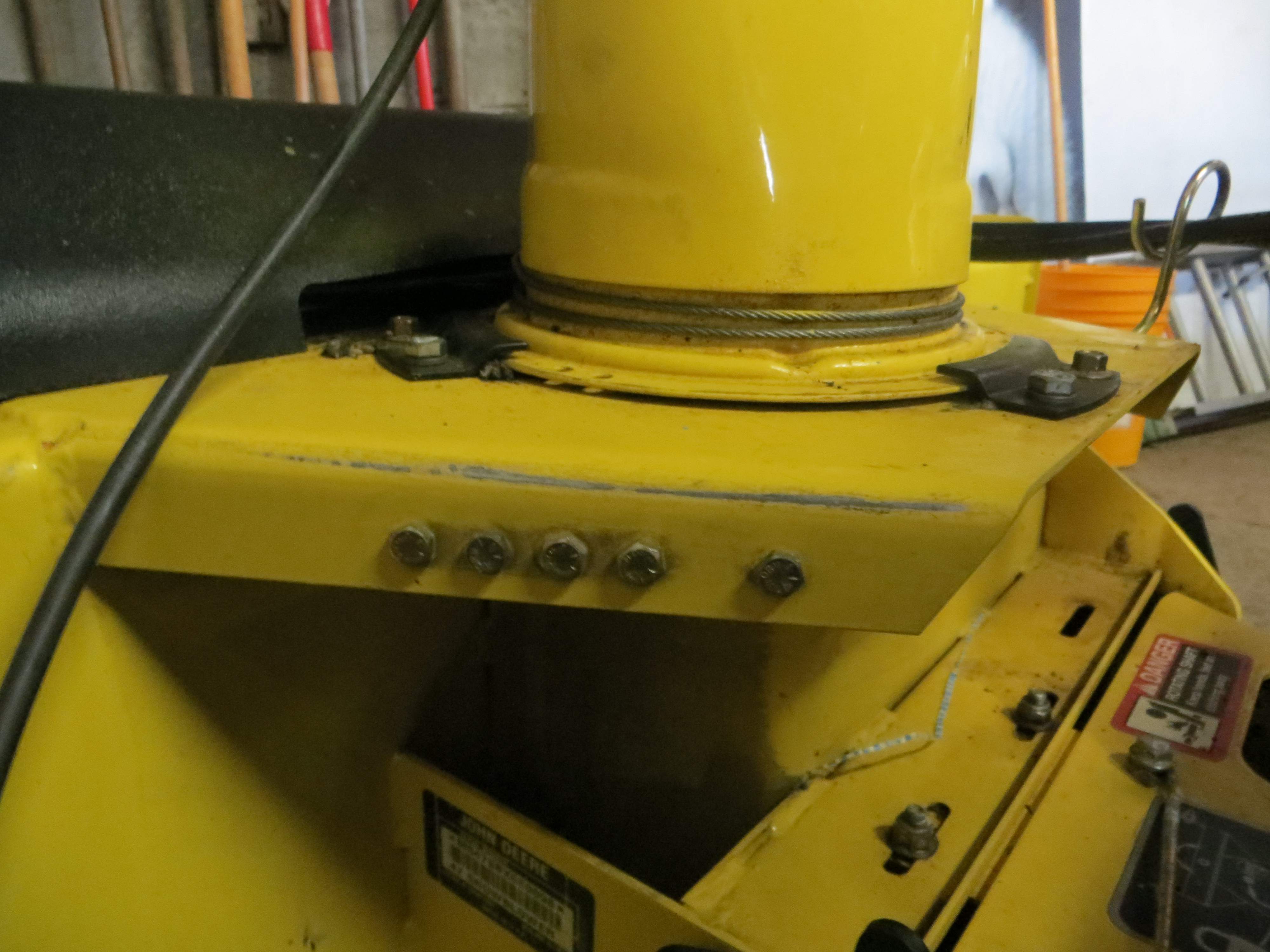

Agree with fdmars, grade 5 should be fine. You may also look on your blower, there is a place to store your shear bolts. There might be some spare ones their already. I will post a pics of the location on the blower. Now as for the chain I can not say as I have no hill, so no need for chains, but I can tell you what works for me. I don't use chain or load tires. Like nickc, I have a ballast box that was strongly recommended by my service manager at the dealer. I did not really need it because of the weight of the cab, but he said the counter weight in the back will put less stress on the front end of the tractor. Had to agree with him. I just have to be careful not to put in to much weight or else you lose front traction when the blower is down and you want to turn.

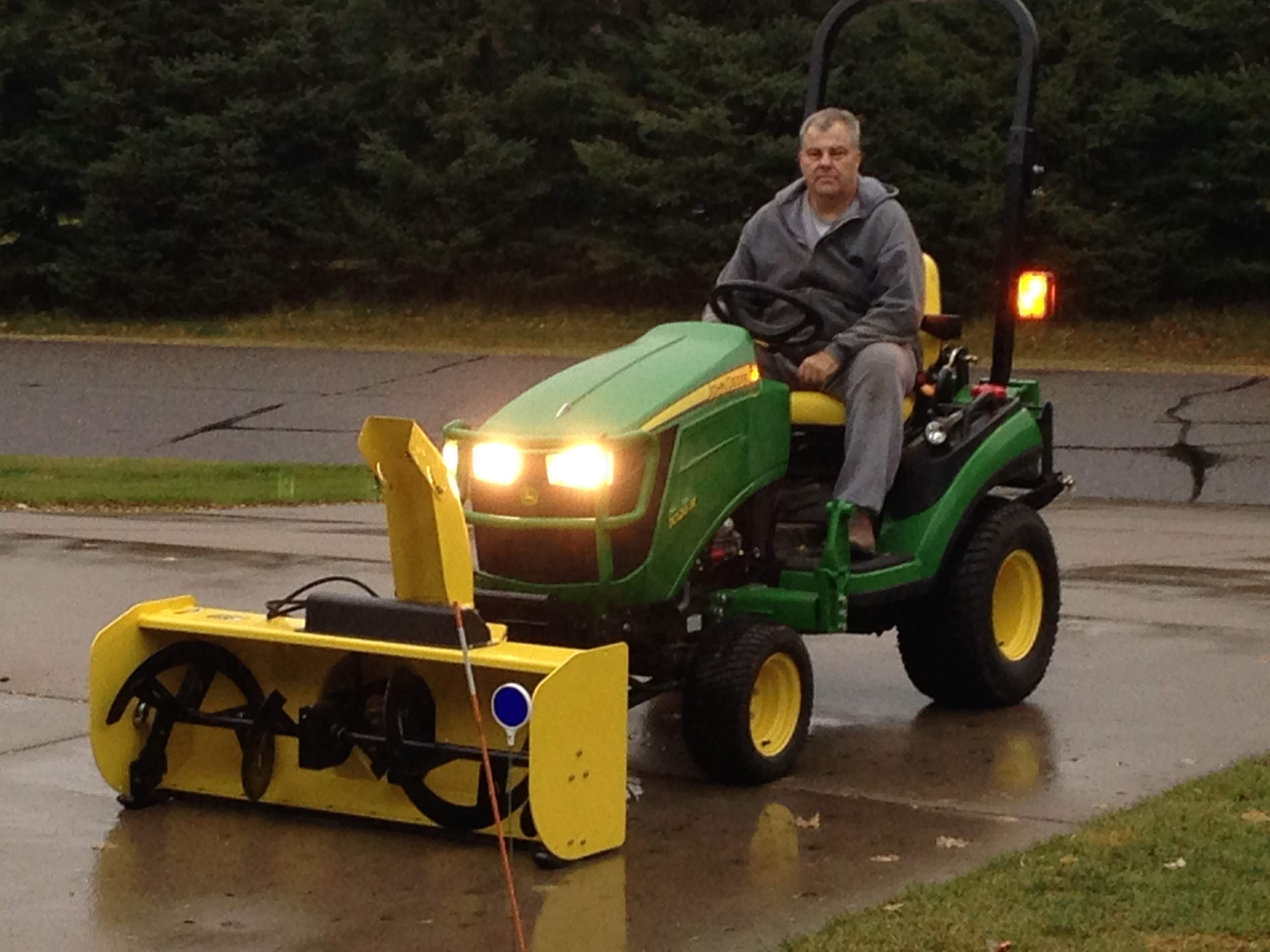

My dealer said I wouldn't need chains with 4WD. This is my first 4WD tractor so I'm about to find out!! Have turf tires & 240 lbs counterweight on back. Tires not loaded.
The dealers must all read from the same playbook. I heard the exact same thing when I bought my 2720... "4WD, no chains required". Wrong! I was coming from a 2WD Ford NAA which had loaded R1 tires and 800 lbs of wheel weights. Needless to say that coming from a 4000+ lb tractor with R1 to a 2000 lb tractor with R4 made a big (bad) difference in traction - and four (3 max) tires spinning did nothing for me. I ended up loading the rear tires on the 2720 and running chains on all four tires. Obviously it all depends on your environment. If you have a relatively flat driveway you may get away without chains. Regardless, when it comes to icy conditions 4WD does nothing to help you stop.

1/2 Main drive has fairly gentle slope, then 1/2 level next to garage. You can see it in my photo above. Pole Barn drive is flat @ street-level. I will try it w/o chains first - chains are expensive & a pain to take on/off...from past experience w/ JD 445 & 318.
Will advise results.......snow coming soon! Already in Western CA & US.
