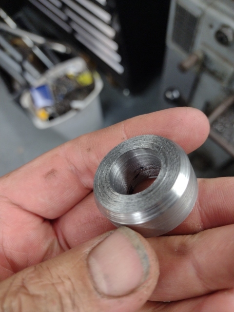

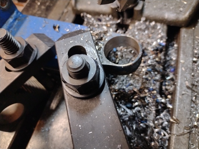

Hopefully your issue is in the ball joint itself where you can weld in a replacement. 1/4" is a lot of movement for a single ball joint.
Hopefully the tapered seat in the knuckle is not wallowed out like a much older/higher hour tractor I repaired recently. The tapered seat part that bolted to the knuckle was unobtainium so I had to bore out and weld in a tapered bushing I machined for the purpose

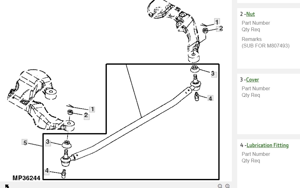

I’ll try to post a video tomorrow. I went and looked at it again tonight. Now have a better understanding and a plan. #1 in the diagram is the complete assembly. A tie rod has been welded on at each end. The bar appears to be hollow. So I’m pretty sure I can grind off the welds and pull it out of the pipe. Match one at auto parts store and re weld.

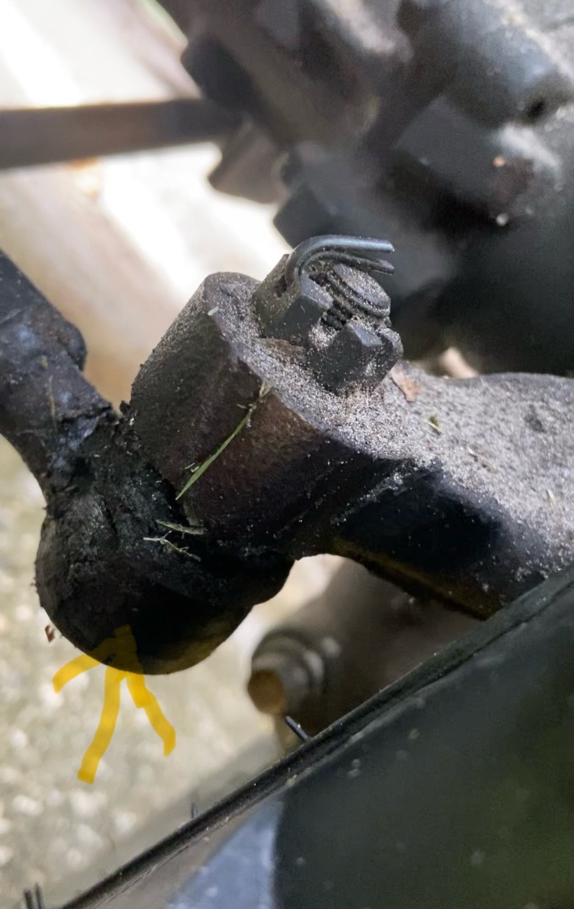

Tried to upload video from iPhone. Some reason the app wouldn’t take it. The arrow points to the part that’s worn out. Bottom part of tie rod is the part that moves 1/4” back n forth.
