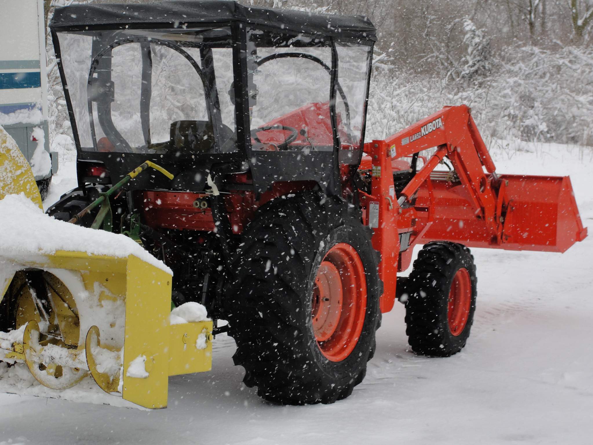

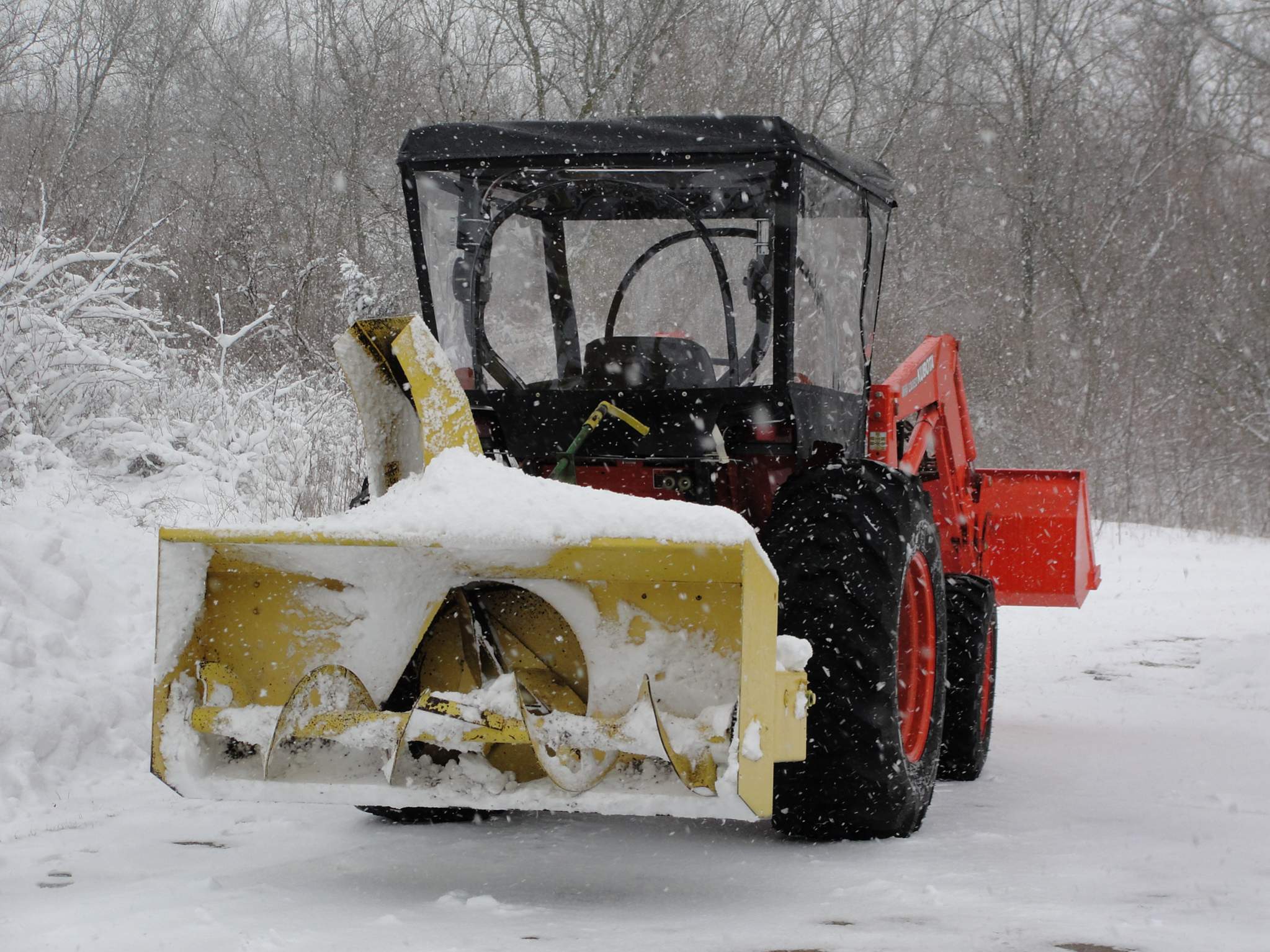

Hi Carl,

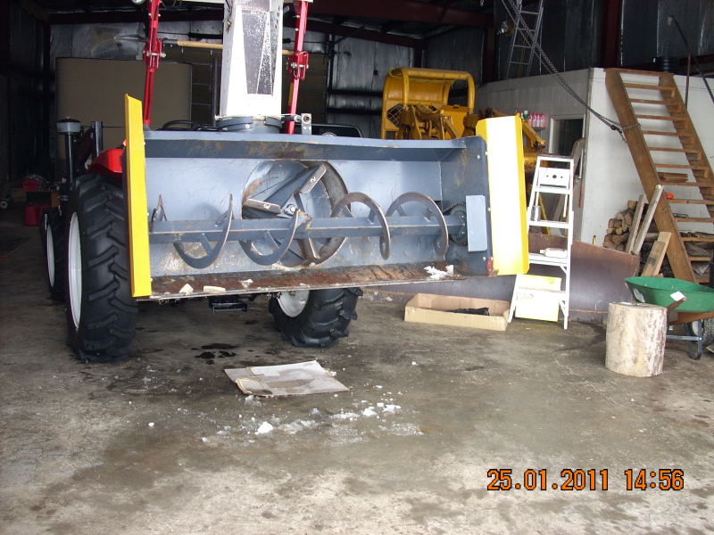

I just went to a metal fabricator and explained what I wanted. He made them to my measurements and was charged $40 IIRC for two. I then took them home and clamped them where I wanted to fit them, drilled and put in bolts. I painted them myself usinga can of spray paint.
They work well and leave a nice clean edge to the snow bank. I have had four wings made - one got bent backwards (large piece of frozen ice that wouoldn't move) and was replaced with a spare. I have one more spare if I need it.
My wings give me another 9 inches of effective width - from 73" to 81"/82". For me an ideal sized blower would be around 86" or so, but I am not sure what sizes are made. Definitely need at least eight inches wider than the outside measurement of the rear wheels, for decent performance.

Carl,
My snowblower height is around 33" IIRC and the metal thickness is 0.110" or around 11 gauge mild steel.The offset I used works out to 4.5 each side and the angle I used is 45 degrees. Flat metal dimensions were 12 x 33 and the lead edge at 2", 45 degree works out at 6" and the rear edge 4". It is strong enough to resist most pushing but gives (i.e sacrificial) when a serious resistance is felt - a good thing as it doesn't damage the side of the blower or throw the auger alignment out. I also put a piece of 2" x 1/4" flat bar under the back edge to act as a support. It doesn't need too big a metal brake to bend the sheet material - though the shop I went to had a big one nonetheless. I have been able to straighten shallow bends etc. with the a big hammer and the concrete floor of my shop :)
