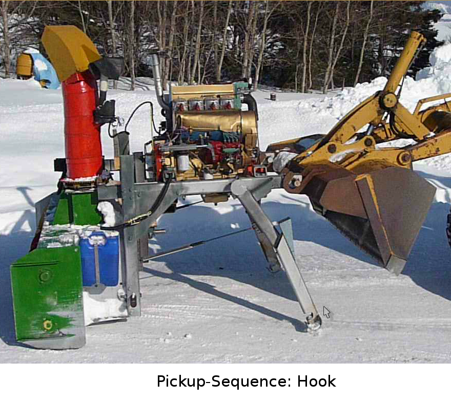

Hi,
I'm a new member, just signed up...
I'd really appreciate some hydraulics advice or link to some pump/motor matching facility to help me select a right pump & motor for a snow blower. If anyone is familiar with the free online Gates belt simulator something like that would be ideal.
I built a mechanical one but want to raise the power a LOT and also convert to hydraulics. Here are some numbers for an approximately 450 hp system (anticipated 1/3 hydraulic losses included)
engine rpm 2000 range
impeller (motor) rpm 600-1000 (to be controllable either by engine rpm or otherwise and preferably no gearbox).
It's a special purpose blower to throw snow from one field right over into another one at least when throwing downwind. The one I built can only handle 4"-6" of medium consistency snow and then it has to slow down to a crawl or the engine begins to stall, it turns 600-1000 rpm using an 80hp engine & belt reduction. It throws 100-150 feet to the side and met my original prototype objectives but needs to be beefed up.

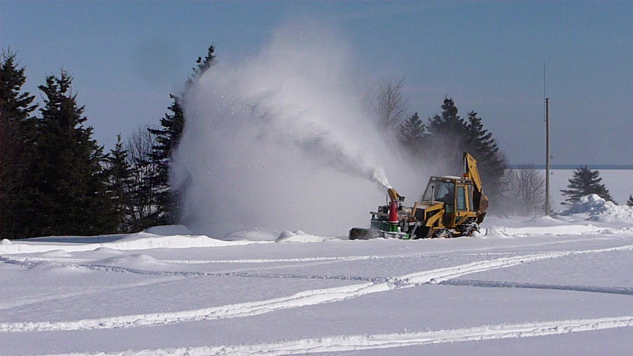

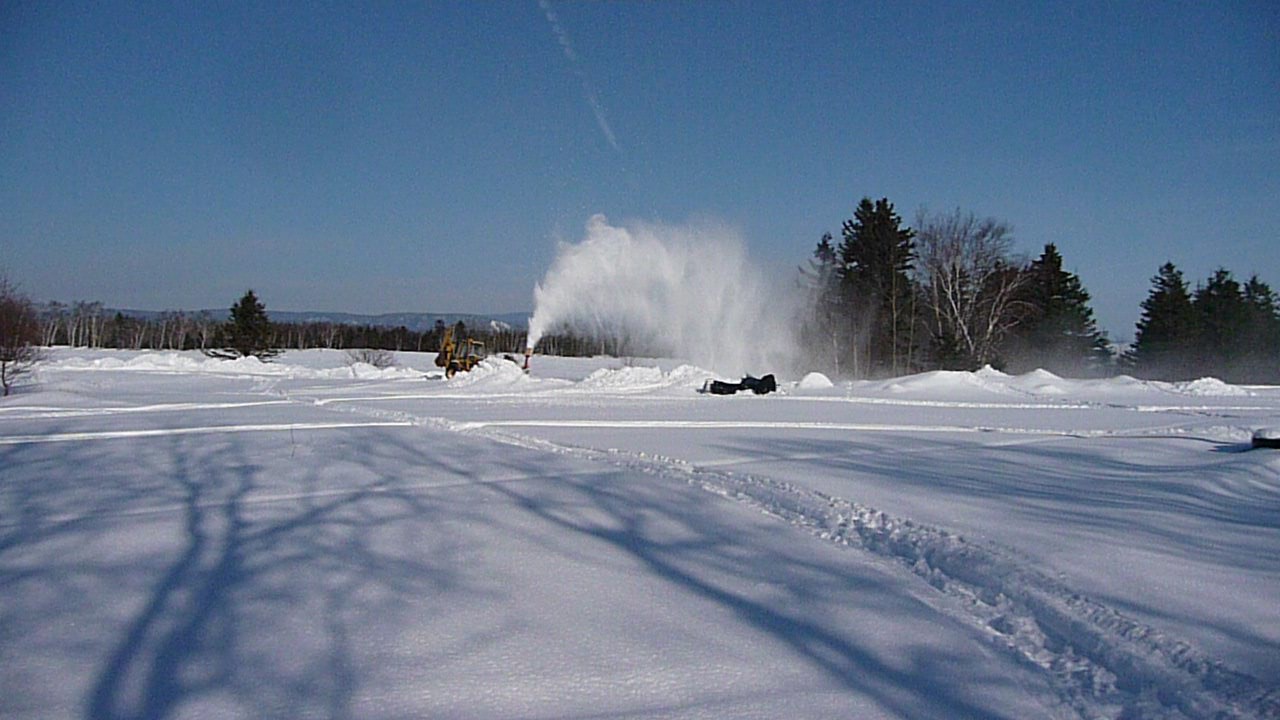

That's what I was afraid of, too much weight & price. This unit is not self propelled and is picked up by the bucket without removing it so total weight needs to be below 2000. I was hoping to replace the engine part (700lbs) with less than half that as a hyd. motor and move the pump and a bigger engine behind the tractor. I can do the mechanical version half a dozen ways but cannot take any more weight. One possibility would be to make a blower from aluminum and/or use a light weight gas as opposed to diesel air cooled unairworthy P&W R985 of 450hp also at 700 lbs (pricey). There's a picture in another thread but here it is again. The throw distance is acceptable but I'd like to process 8"-10" at 10+ mph.

Neat looking set up you have there. Most DOT snow blowers would be set up in the bucket of your front end loader with engine attached. This way you can lift blower in to a big drift 6-7 feet in the air.
/ snow blower pump & motor
"In" the bucket? You have any links to pictures?
'round here most people pull the bucket right off using quick couplings. I wanted more than that i.e. to be able to leave home to do the neighbors and once on site blow snow while retaining the ability to just drop the blower to do bucketwork. With radio control that was a 30 second affair, but I had to pull the initial radio because of unreliability (it was a $12.00 ebay job). And yes, I do let myself go at times with snowbank sculpting just to rub it in :)))
Gotta be carefull though, if your engine don't have a deep sump jug under the pan you can oilstarve with very small engine angles! I want to increase throw by 50% and feeed speed by about 100%.
