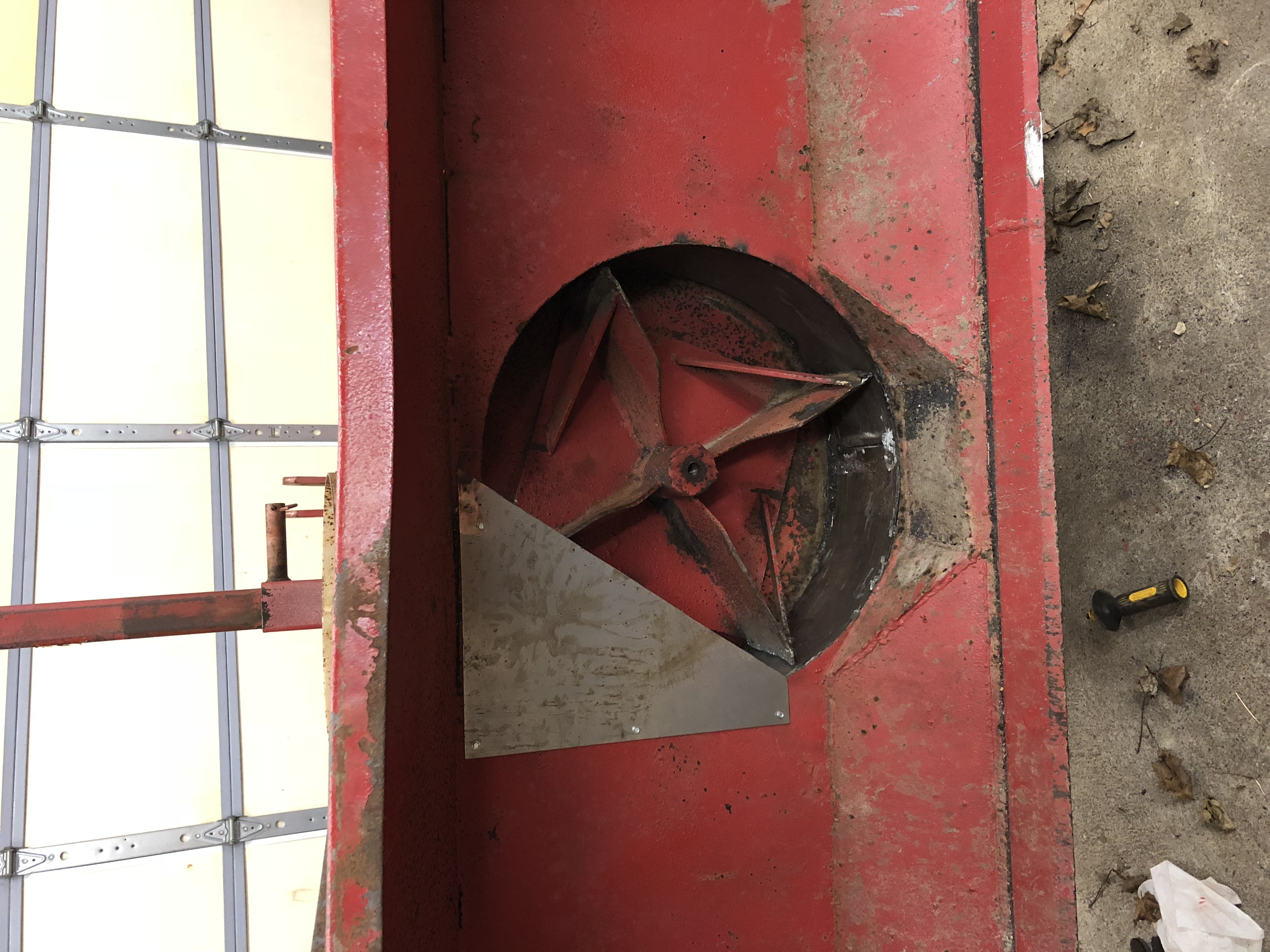

If you look at newer blowers most have a part of the circular fan opening blocked off near where the snow enters the chute
You can experiment with your blower by adding this triangle piece. Make it from plywood to start with so you can fine tune the size.
Bolt the piece on, don't weld it on when you get to the correct size as it must be removed to remove the fan should you ever need to.

Thanks for the suggestion, I already have it on there. I will post some pictures.
Just need to wrap a few things up and sandblast prime and paint the blower.

I've seen this picture before, but I still can't make heads or tails out of exactly what it is. I don't get any perspective/depth perception as to the placement.

Here is a picture. All blades are clearanced to the new smooth housing to about a 1/16
Front plate is on with 4 bolts.
Just need a few more touches and it will be ready for sandblast and paint.

The triangle wedge that is welded to the upper left portion of the impeller throat is there to keep the snow
inside the impeller housing so it can be ejected through the chute and spout.
If you look closely you will see that the base of the snow blower chute is directly above the left side of the impeller housing directly above the triangle of plate steel, and yes there is room to remove and install the impeller in the event the impeller is damaged or the snow blower drive train needs to be removed.

The gear box shaft extends a long way from the back of the fan housing to support the fan. The fan will not come off and out of the enclosure with the triangle in place
The only way to remove the fan is to pull the gear box back!!
This dimension spec from COMER shows the fan shaft of the gearbox is 6-1/4"
The fan is 10" deep x 30" diameter.
The fan has to move forward approx 6" to clear the gearbox shaft
That is why more expensive blowers have the triangle restrictor bolted instead of welded.
