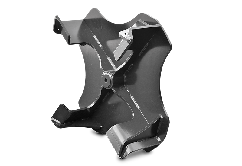

Look at various impeller designs before modifing yours. I have a WIFO blower which works great, if you scroll through the pictures in the attached link you will see how they designed their impeller. Check other designs to see which you prefer. http://www.wifo.ca/products/snow-blowers/3-point-hitch.html 3ph-snow11.png Notice how the last few inches of the impeller blades cup the snow.

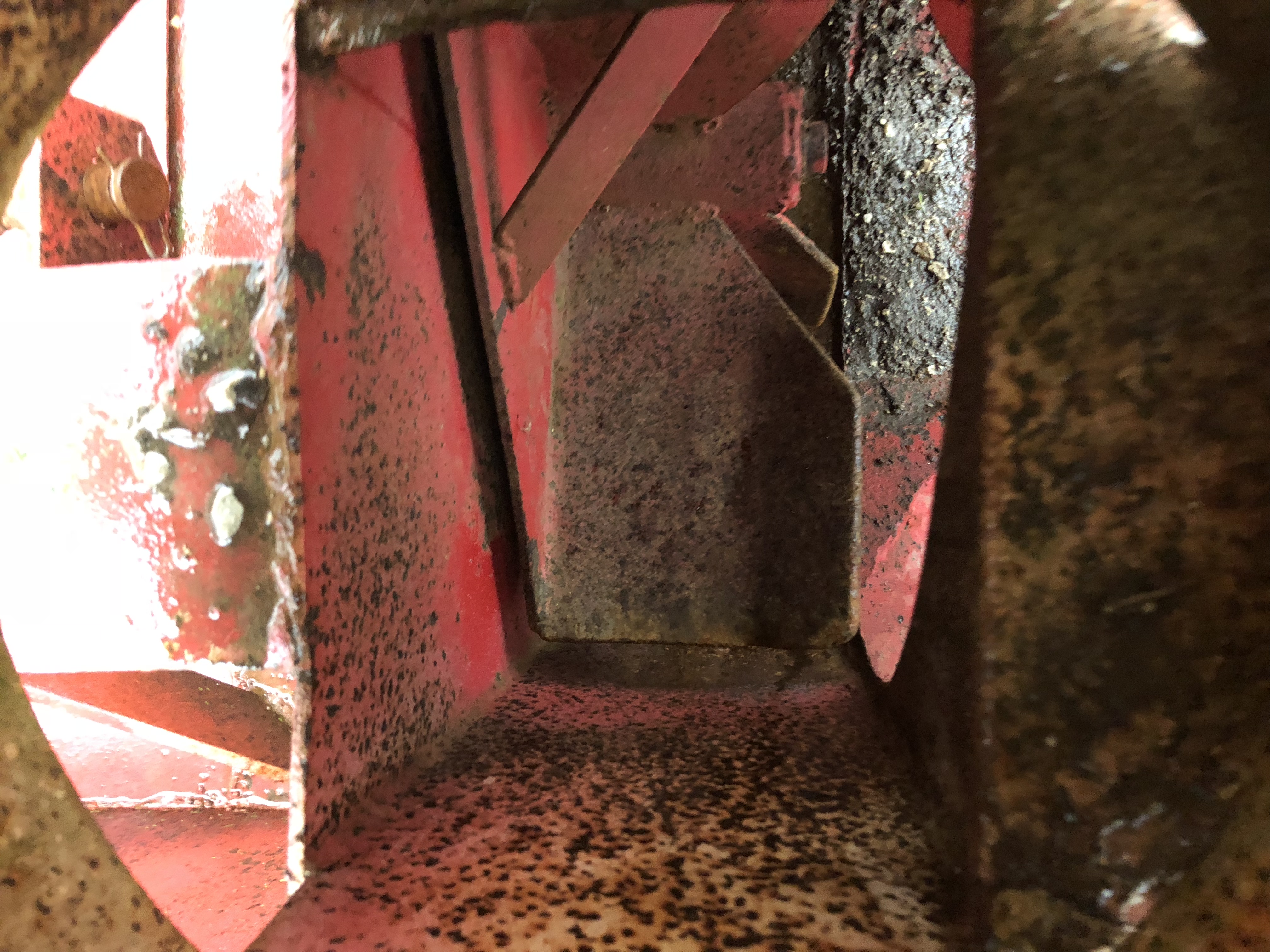

Check the passage way between the impeller housing and the chute. You have a lot of snow built up around the base of the chute which makes me wonder if something isn't disrupting the snow flow.
The surface finish inside the chute can also disrupt the flow of the snow. If needed you can pick up spray cans of pickup bed liner from the parts store. That will provide a good smooth surface that is also durable.
You may have several problems that need addressed, cover them all while doing this. A few better pictures of your impeller/housing might get you better input.

That looks like a good design on the impeller. Unfortunately I don’t think I will be able to remove mine.
I plan on probably relining the drum and clearancing the impeller to fit. And a coat of paint. If it don’t perform any better next year I will send it down the road.

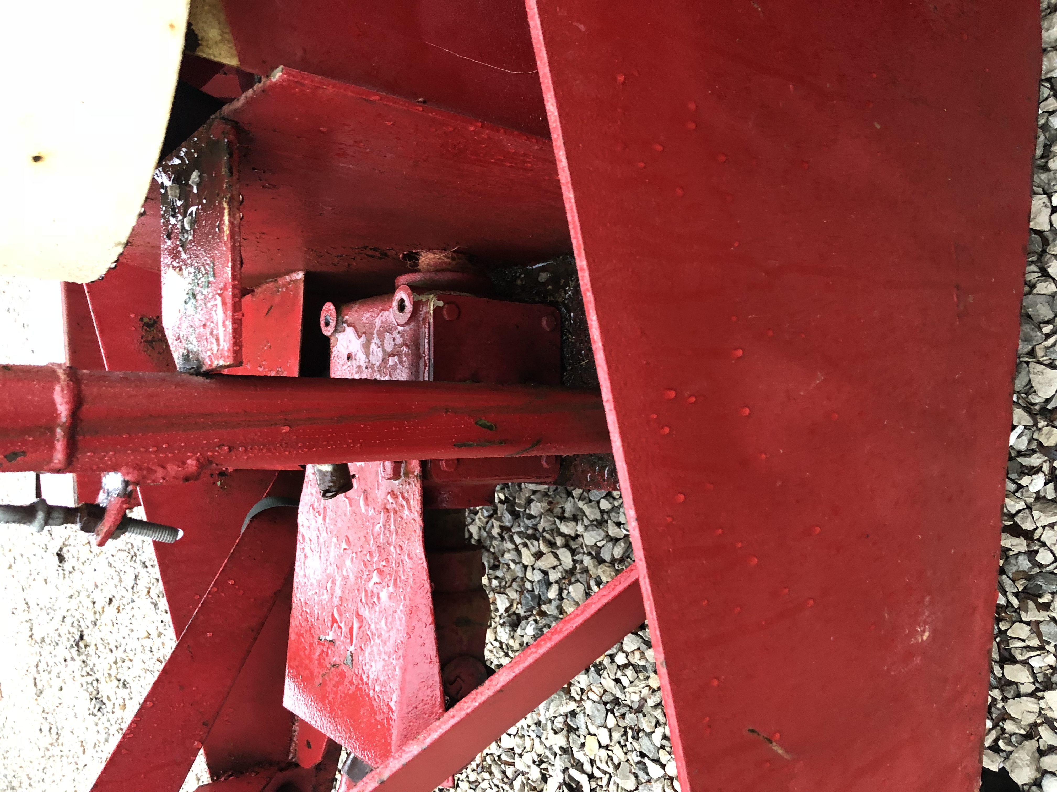

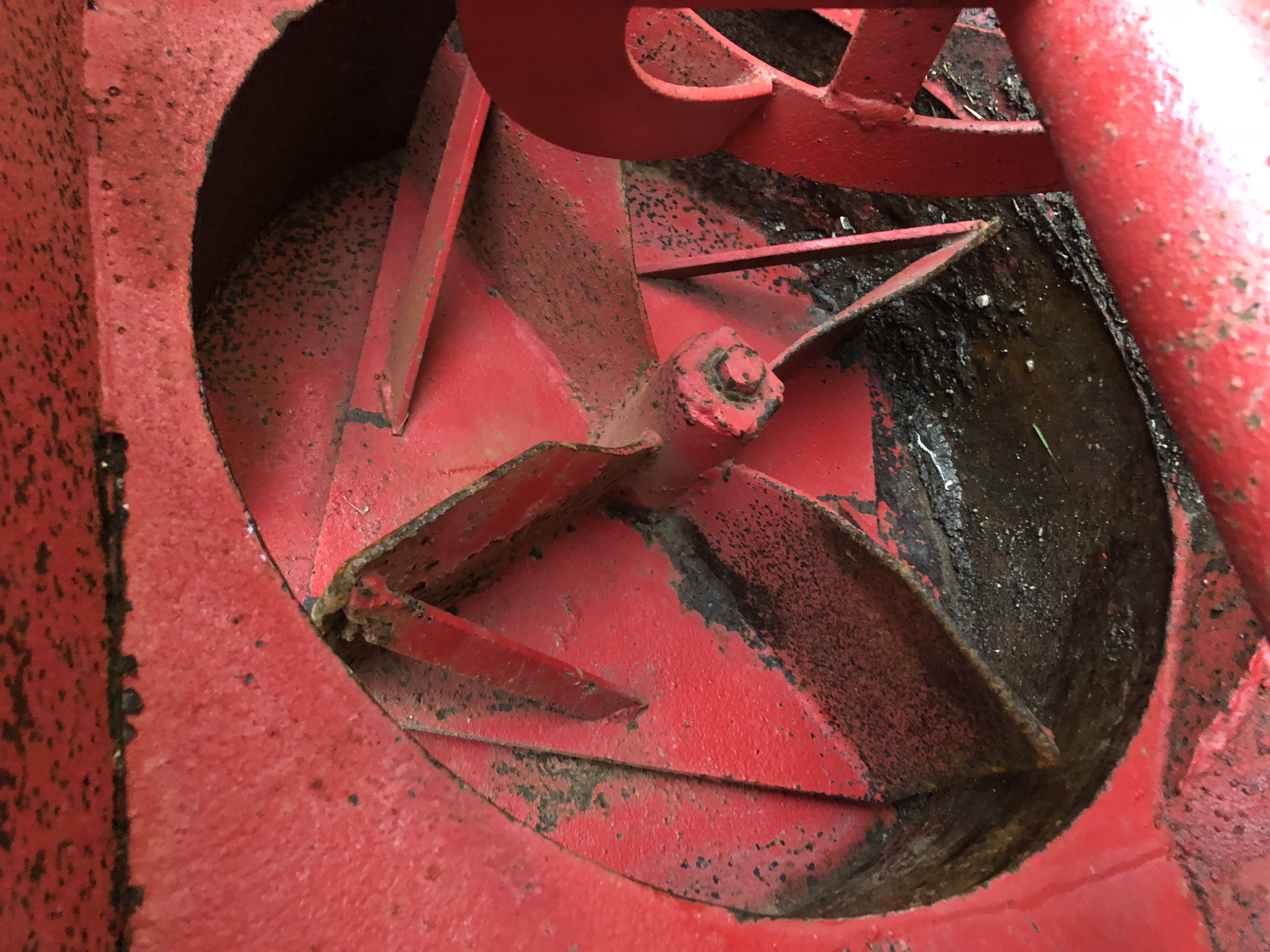

Here are some pictures. Showing the shaft go through the gear box to the impeller.
Numbers welded look like 1-0-205

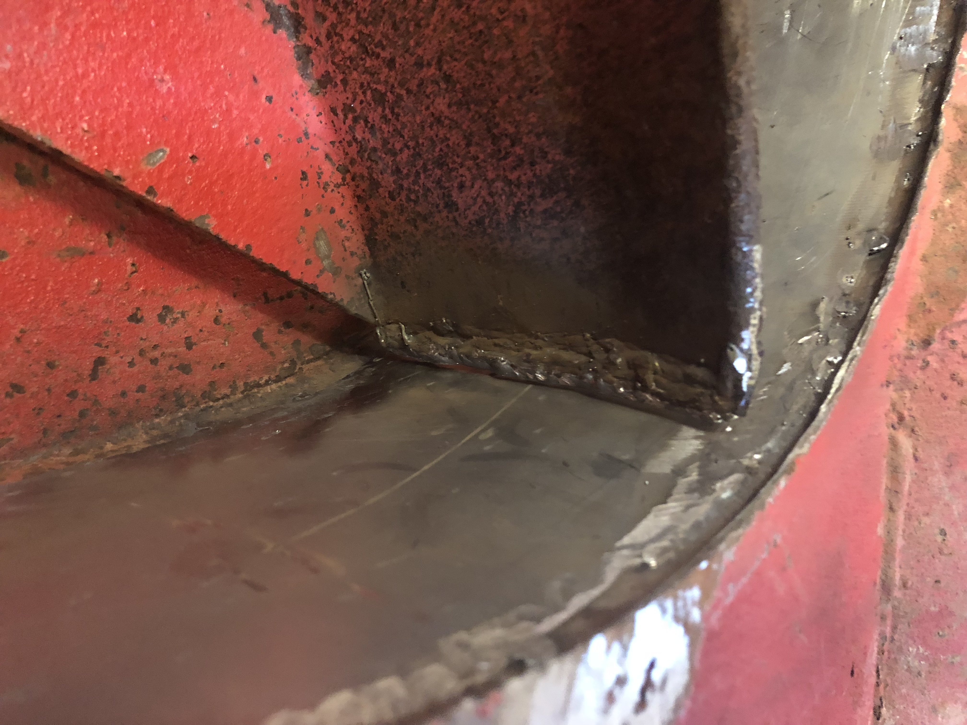

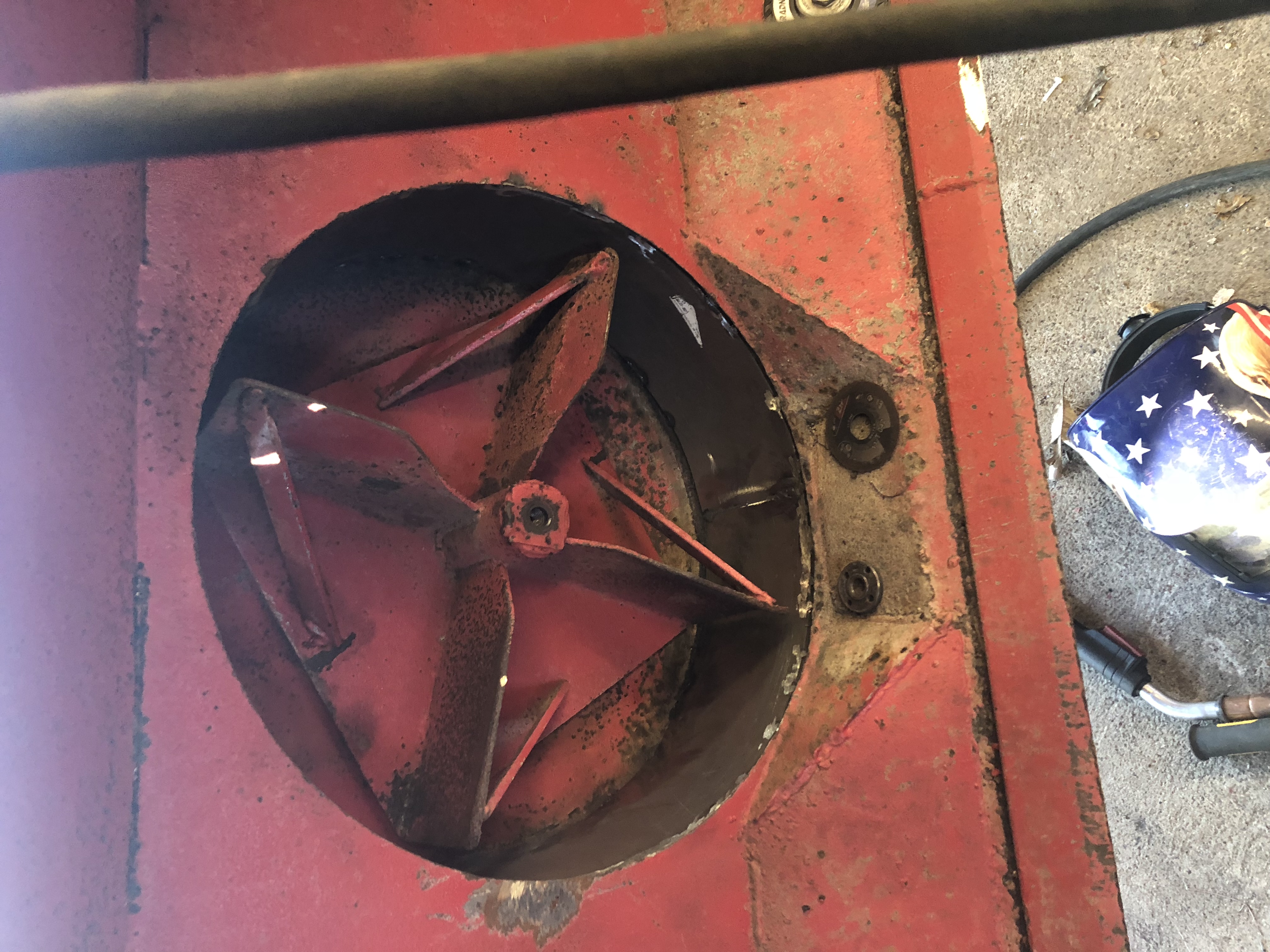

Finally got around to messing with this today.
I installed 14gauge sheet metal to line the housing since it was beat up and had a few holes.
I didn稚 have any luck removing the impeller. So I had to build up the impeller through the discharge hole.
13 passes with the welder. Don稚 judge the welds, it wasn稚 easy to do it while on the blower. If the impeller would have came off it would have been easier doing it on the work bench. Hard to get the grinder in there too. But I should be able to clean it up better.
