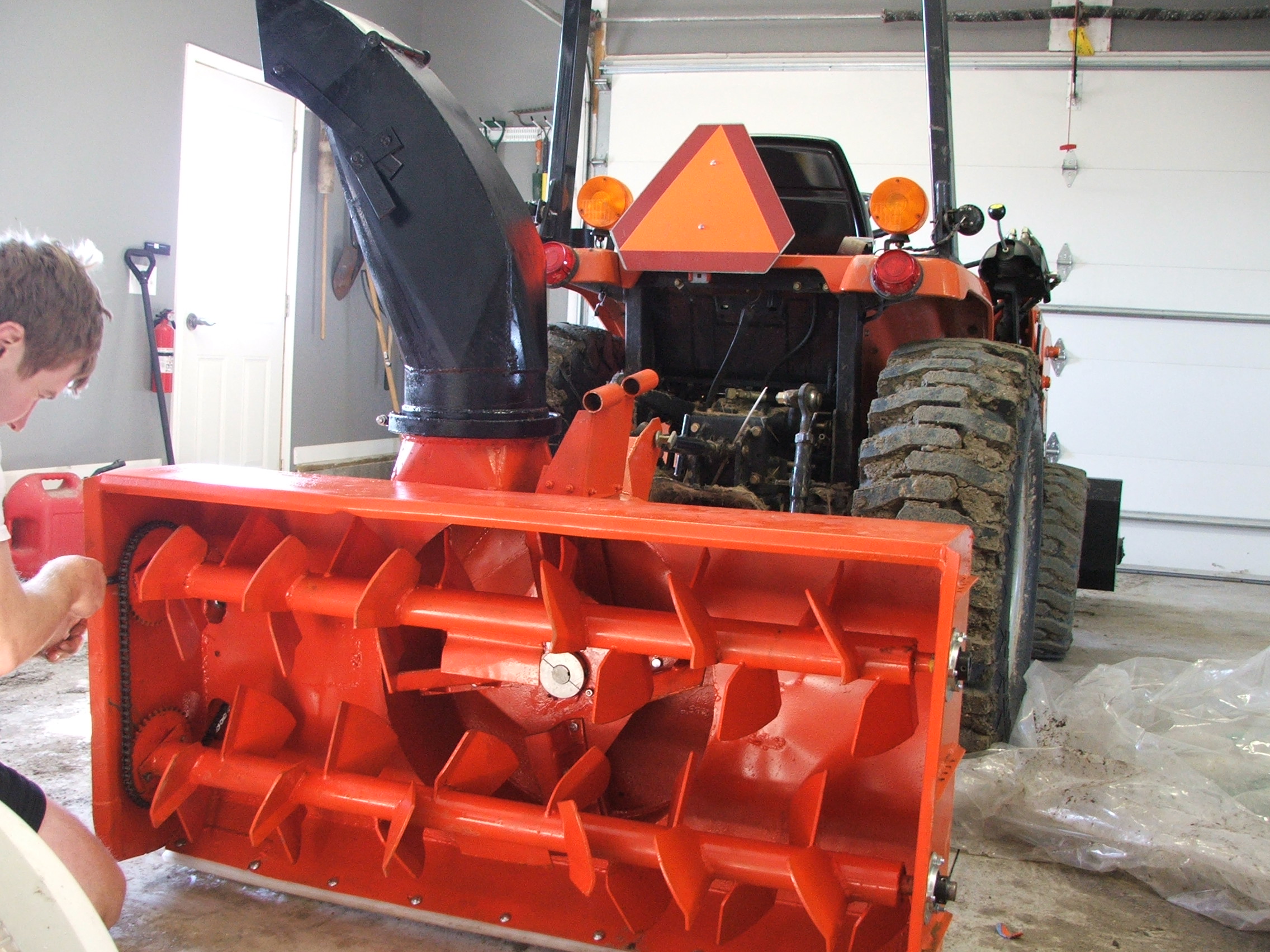

I have an old lorenz snowblower that i just rebuilt. it has a fairly large diameter fan probably around 25" or 26" and also has 4 blades. so i just finished it this morning and wanted to try it out but it was about 40 degrees out and the snow was heavy so I got the tractor up to 540 and backed into some snow and the snow just tricked out of the spout maybe went 3 feet. Is this just because the snow was heavy ? has anyone else tried to blow heavy snow and had the same results.
here is the blower

Heavy snow is the hardest to handle, tends to clog the shute as it just wants to pack things up.
Generally in that heavy stuff I just make a small cut, like maybe 1/3 of the width for best results.
Also don't back in faster than the the blower can handle as you really can pack the slushy snow in there and then you'll need a crowbar to free it up.
You'll soon develop tacticts with practice.

Hmmmm...Dunno much about the Lorenz blowers, but the last "Blowable" snowfall we had was heavy wet-ish snow and while it took a ton of power (had to go slower) I didnt have any clogging or throwing problems with my Blizzard...
Did you check shear pins, keyways, etc? The Keyway on the fan might be sheared if there is a keyway...I've seen what you describe happen with a busted fan key.
Given the size of the blower this is a long shot, but is your snowblower designed for 540 RPM input? Some of the larger models are 1000 RPM models...Easy way to check is to make sure the fan turns 1 revolution to 1 revolution of the PTO shaft.

the fan is driven right off the pto shaft so the fan is spinning 540 rpm. I think i am going to move the fan farther back in the housing. I looked and had around 1/2 inch of gap between the fan and the back of the housing. on the side of the housing there is probably about 3/8" of gap, but the housing is not perfectly round so it goes from about 1/4 to a little over 3/8. i may add some rivet some rubber to the ends of the paddles so they sort of squeegie the inside of the housing or at least get closer.

Yeah the snow i was blowing was very wet, the next day , i then set the fan further back in the housing and tried some more wet snow and i probably got about 10 feet out of it. i also sprayed some silicone on the fan and chute and i am sure that helped out too.

i also think that the curtis gearbox is a little light for the unit
https://www.surpluscenter.com/item.asp?UID=2009050320352012&item=1324&catname=powerTrans
if you look at this page it has a chart and i figure that the gearbox is going maybe 200 rpm and it says that the gearbox will only handle about 6 HP at this rpm which is pretty low, so i always find the cheapest chinese bolts i can find to use as shear pins.

1:1 on blowers usually means its a 540 RPM input...I know all the blowers in the 48-80" range are pretty much only 540 input...I havent seen a blower in that size range yet that wasnt 540.

Mike194-- in my experiences with a walk-behind, the single most important factor behind throwing distance (other than a stretched belt) was clearance between the impeller blade tips and the inside of the round fan housing. Just a little "extra" clearance will decimate throwing distance. Check to see if the impeller blades have been bent from rocks-- that'll do it every time!
You might want to look for clearance specs on your blower, but I doubt that it should exceed 1/4". Nice refinishing job!
Oh-- and a really dumb question.... I suppose you verified direction of fan rotation? Looks like it should be clockwise as you face it from the rear....:eek:
