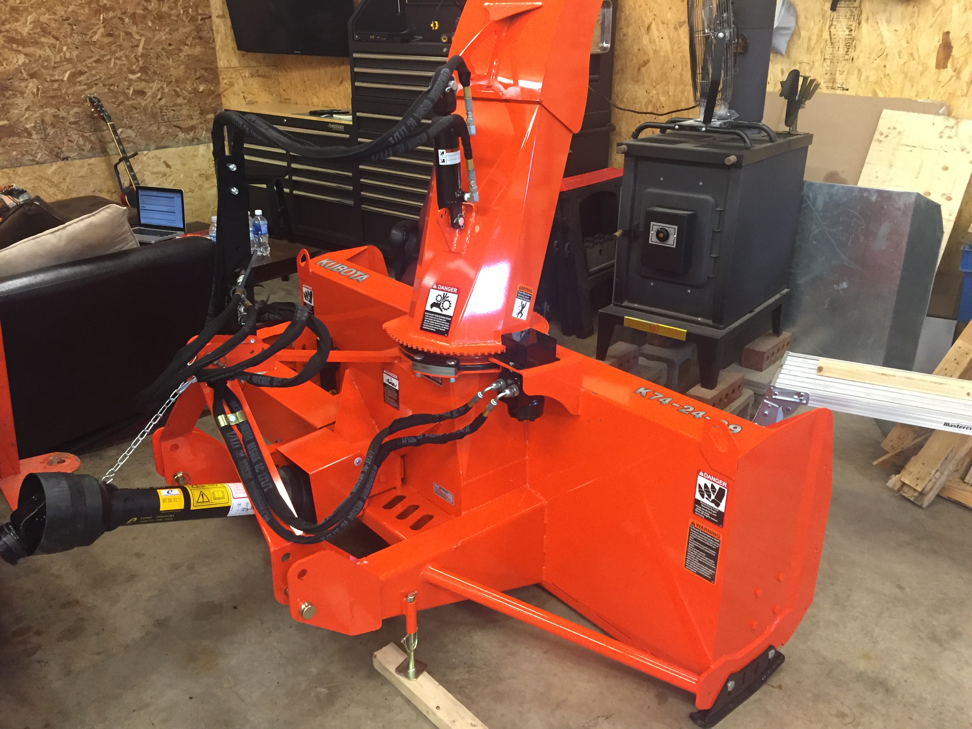

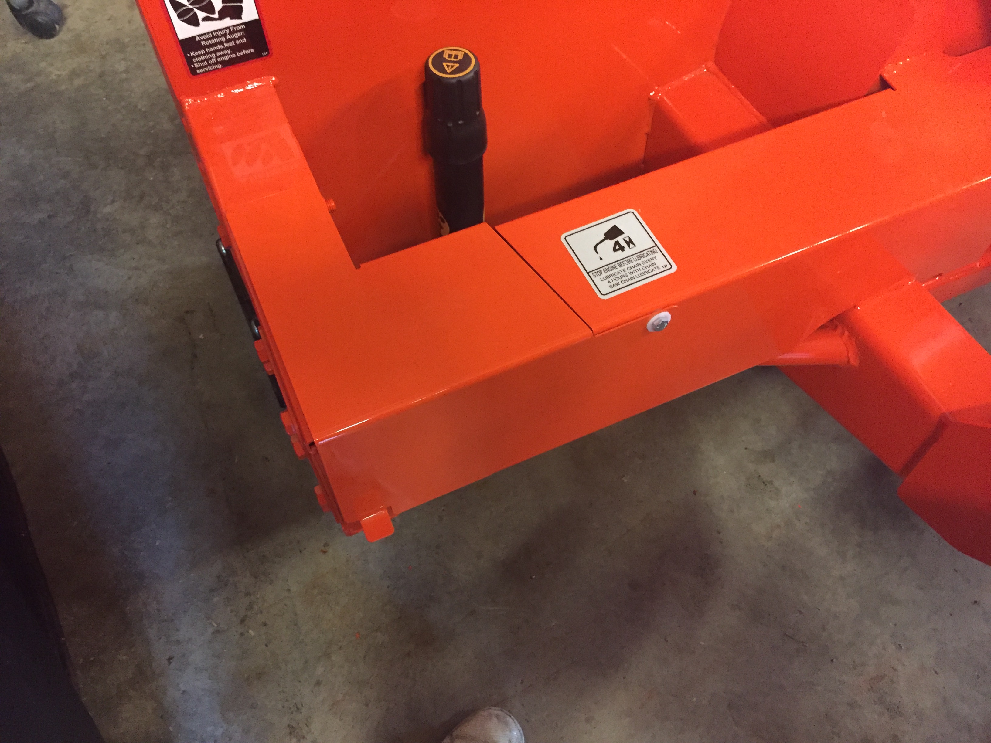

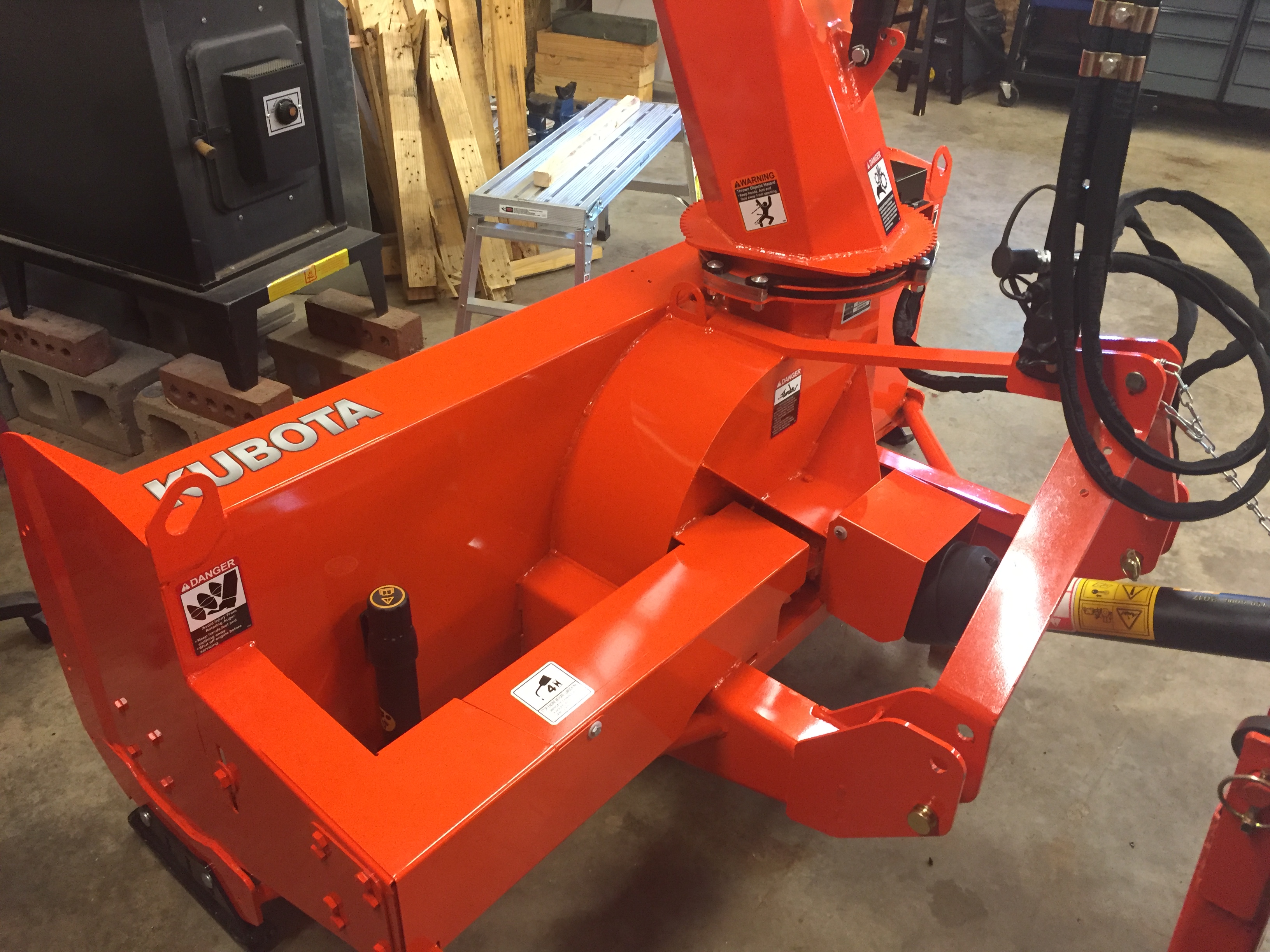

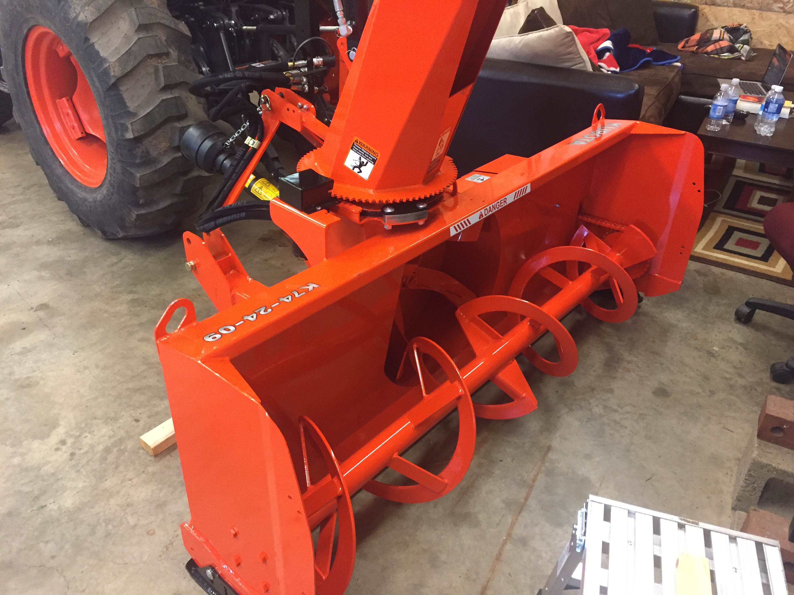

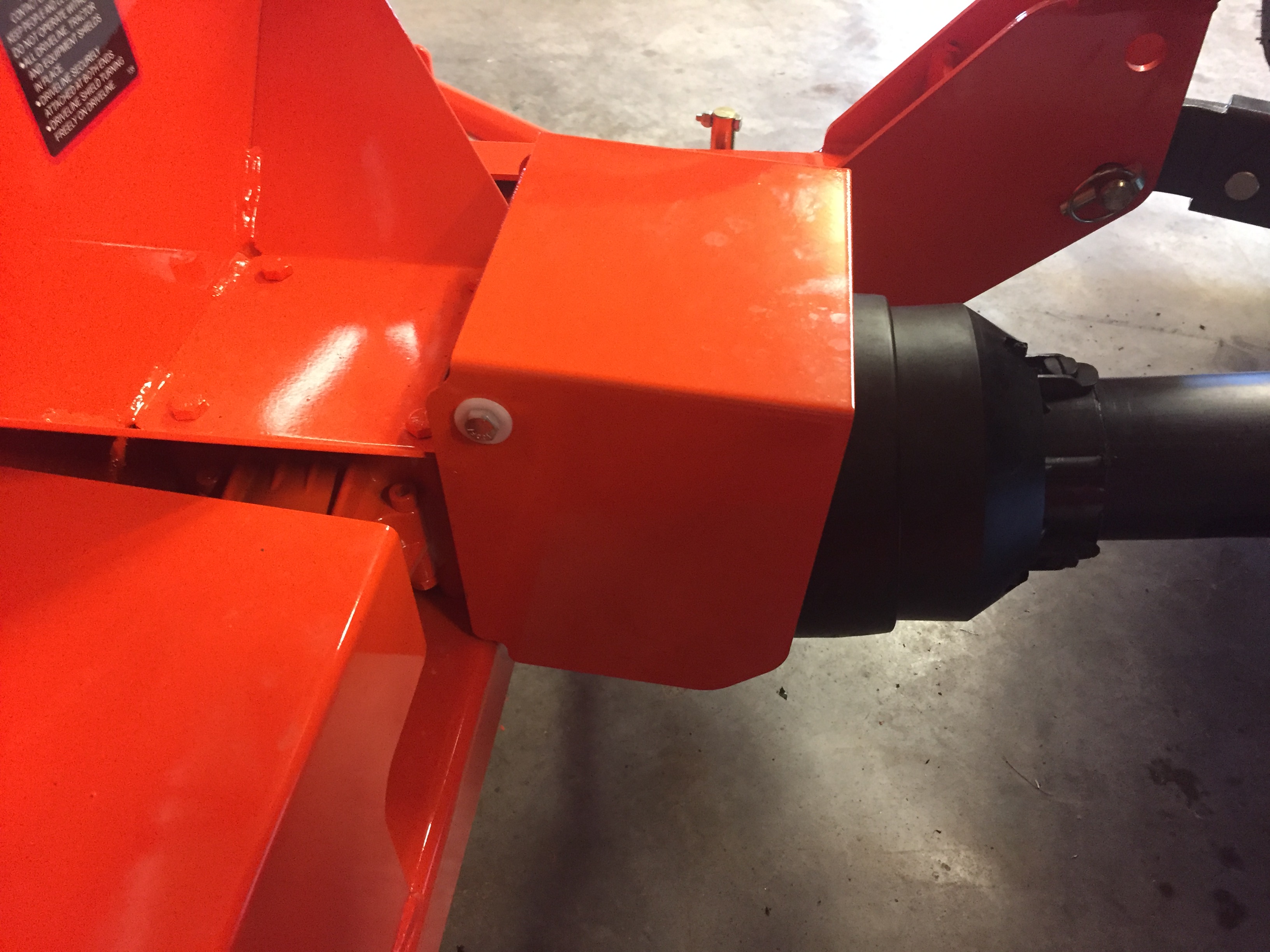

I recently purchased the K74-24-09. I haven't used it but I like the improvements they made over the previous models.
/ Snow blower brands
#28
Topesrule do you have pictures of the K74 blower. We are going to buy one but they are still in the crate. My dealer says he can sell us one in the crate to assemble our selves and save $450. Thanks.
/ Snow blower brands #29
Is there anything specific you'd like to see? IMG_1556.JPGIMG_1557.JPGIMG_1558.JPG
#30
Thanks for the pictures Topesrule. From what I am told the shear bolts have easier access than the LMX3174. This blower also 100 lbs heavier than the L2674 model.
/ Snow blower brands #31
I had a BL2664 before this one. I had real good luck with it. This one seems good to me, but like I said I haven't gotten it in the snow yet. Can't wait to though.
The shear bolt access is better. IMG_1560.JPGIMG_1559.JPGIMG_1561.JPGIMG_1562.JPG
