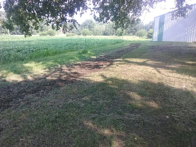

There have been several suggestions for rollers.
I have used a Cultipacker to roll my lawn. About 120 pounds per foot of width.
I have towed an 18" diameter poly roller behind my Utility Vehicle to roll my lawn.
Both ineffective.
I think a roller with a weight of at least 200 pounds per foot of width, better 300 pounds per foot of width, is necessary to flatten moist turf. As a roller rides on top of the soil, a 4-WD 1,700 pound bare weight compact tractor should be able to pull such a roller over level or moderately sloped turf. (Caution advised descending slopes.)
878 / 4 = 220 pounds per foot of width for $265. (Do not let a poly roller freeze!!)

/ Smoothing a bumpy yard? #29
You'd want to kill weeds before they set seeds if early in season. Also if you don't give 'em glypho etc and two weeks to starve and die you won't like what wraps around your tine bar. If it's late in the season let 'em dry out so they'll break up easier. Ideally I'd go over an area with the flail mower to shred and wait a few days to dry before tilling-in. Replanting at any stage will get competition from seeds tilled under or latent.
Agree with Jeff that rollers are rarely as helpful as can be imagined. My whole ten is mostly/all sand, includes a former commercial 'pit'. My 24" x 48" steel roller is filled with sand vs water as designed and is quite a bit heavier, tows best with the Mechron SxS vs smallest CUT. To mow a certain 1/2 ac of two total on my ZTR one wouldn't guess I owned a roller much less ever used it.
