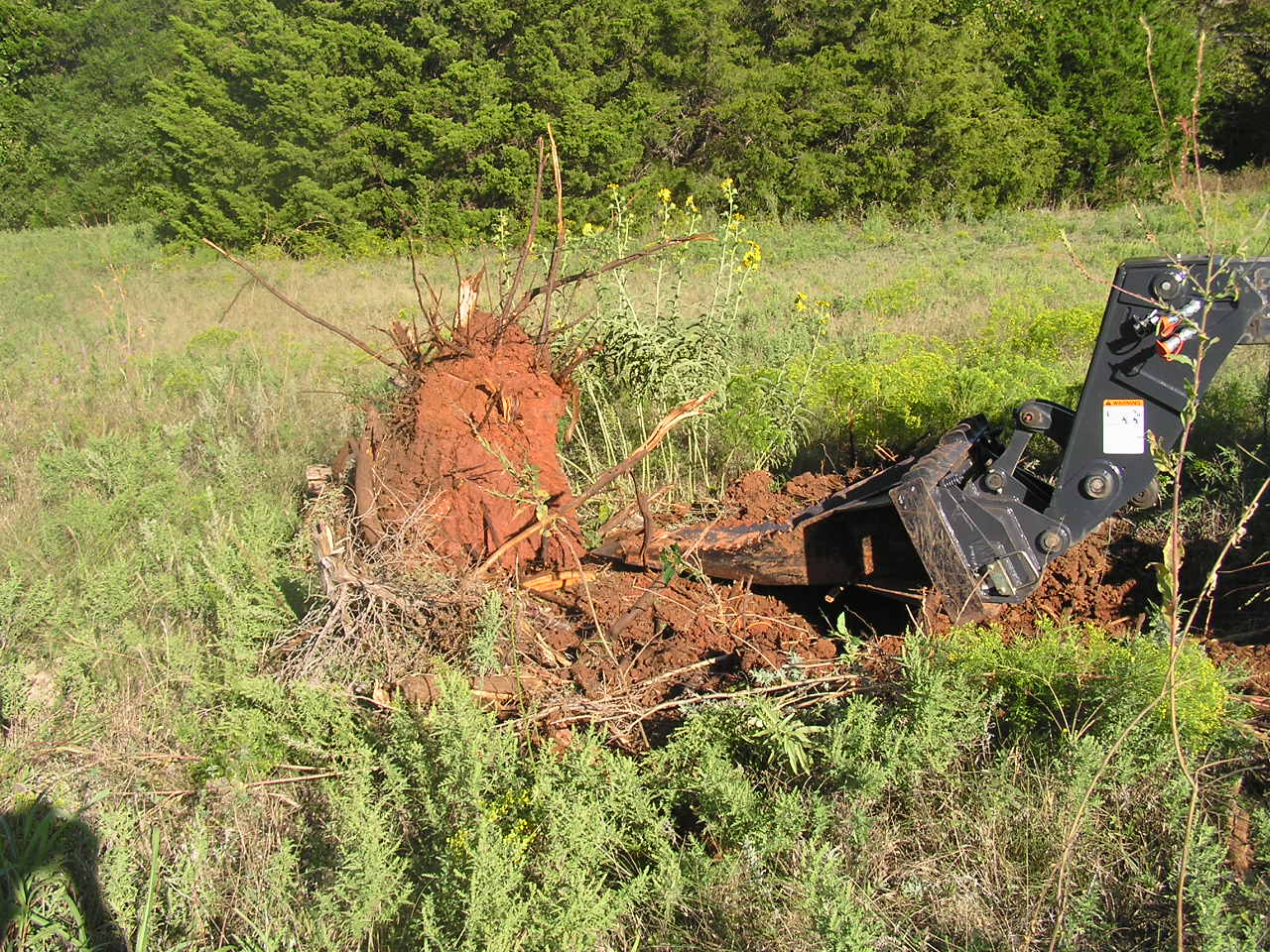

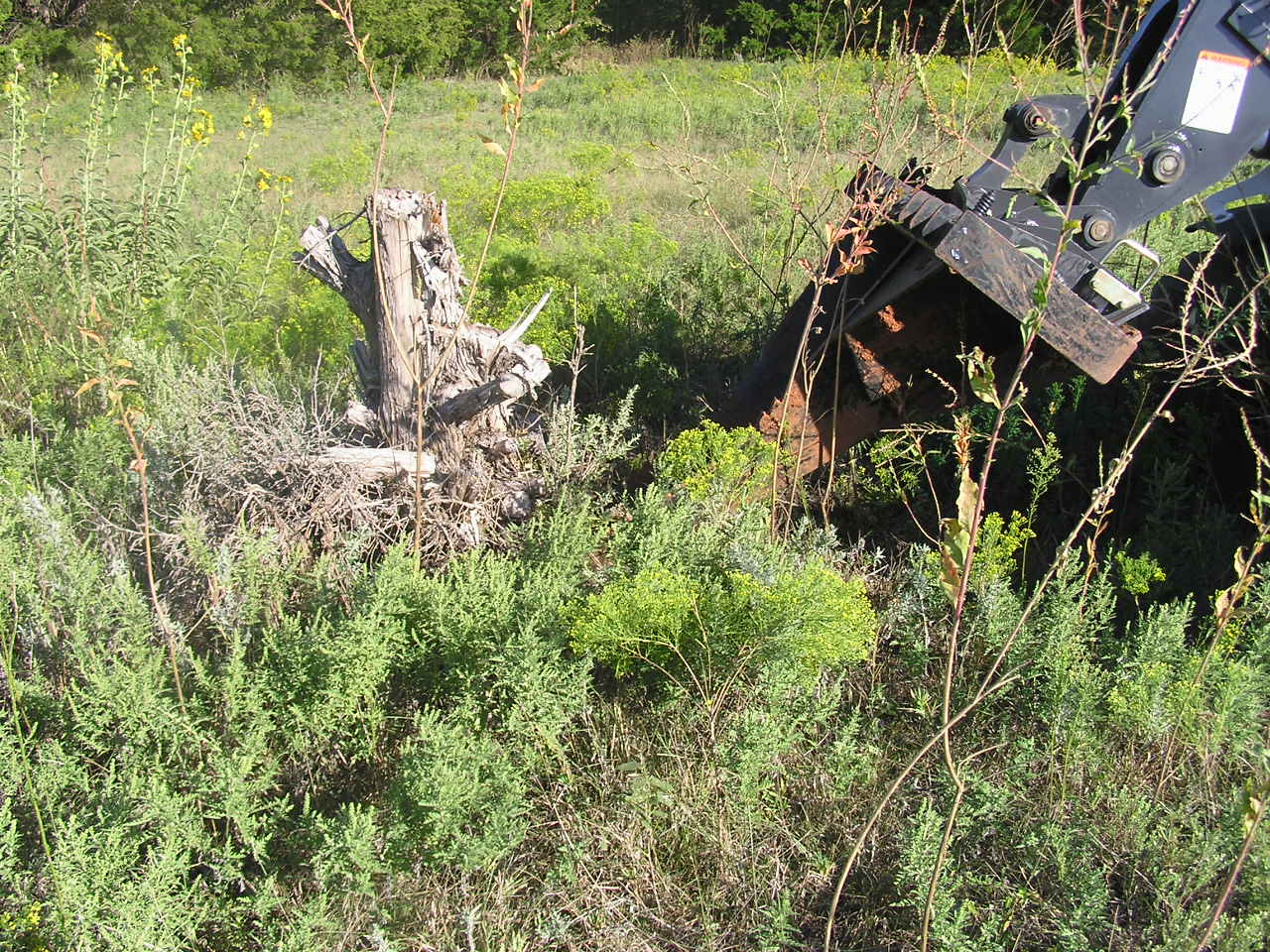

I have the CID Extreme Stump Grapple. I have used it to remove small stumps, big stumps (half the size of my TC40DA tractor), and rocks. I have dragged trees and held them to cut for firewood. I have used it to cary and stack brush. I have dug ditches and a dry well for the gutter on the house. It's about the best toy I have.

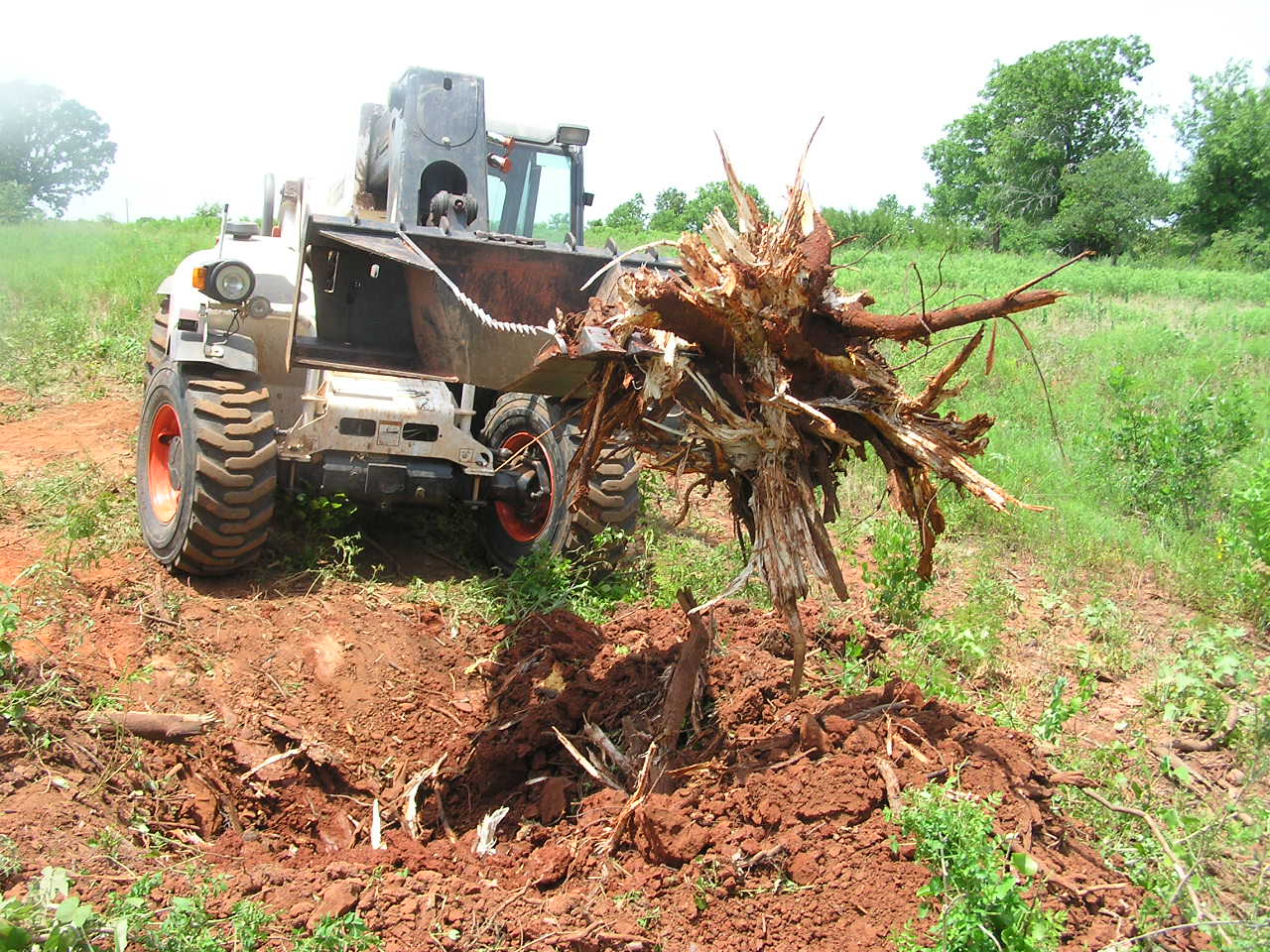

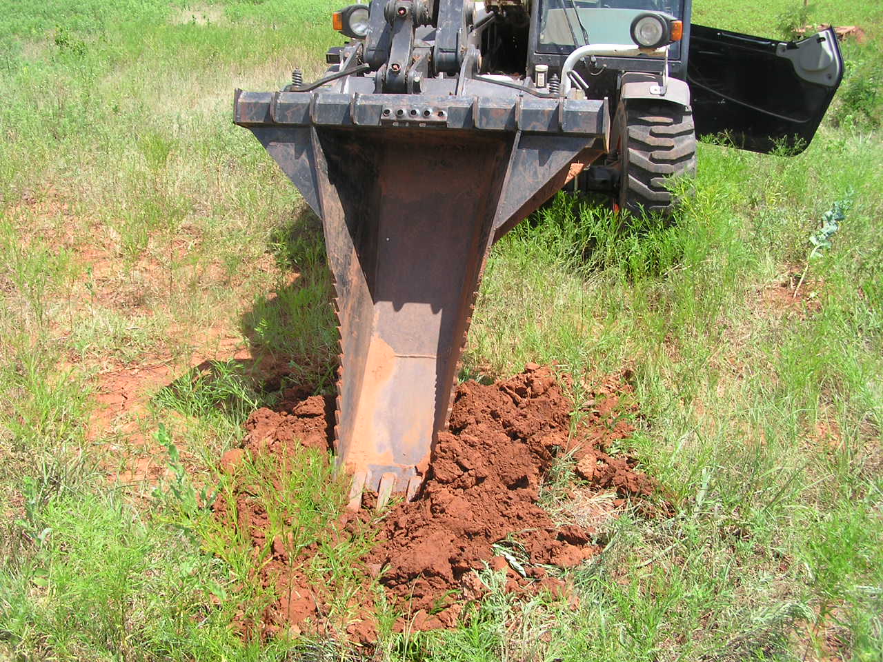

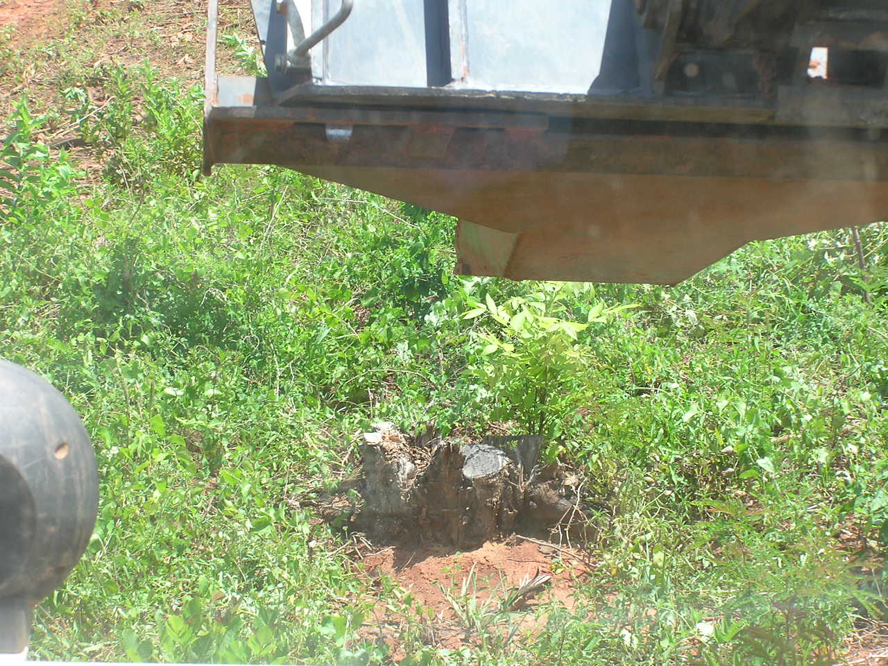

/ Smooth loader bucket vs stump #27
Small stump, viewed from the seat in the V417.
My issue, your showing actions shots of an implement on a piece of equipment that weighs 10,000 lbs and is 75 hp with over 2x the loader capacity of standard CUT tractors.
To imply the same kind of results on a 30-40hp CUT is really a disservice to the guys looking for solutions for their CUT's.

Where did I imply that a CUT would get the same kind of results as my V417?
