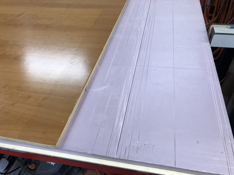

For those of you that cut up 4 by 8 ft plywood using a circular saw and straight edge. Buy a piece of 1in Pink hard foam board insulation. Comes in 4 by 8ft panels. Just throw it on a table or flat ground. Set your blade 1/8in or so deeper than your plywood thickness and cut away on your sacrificial backer board. Once you are done, it is nice and light and you can throw it anywhere to store it.

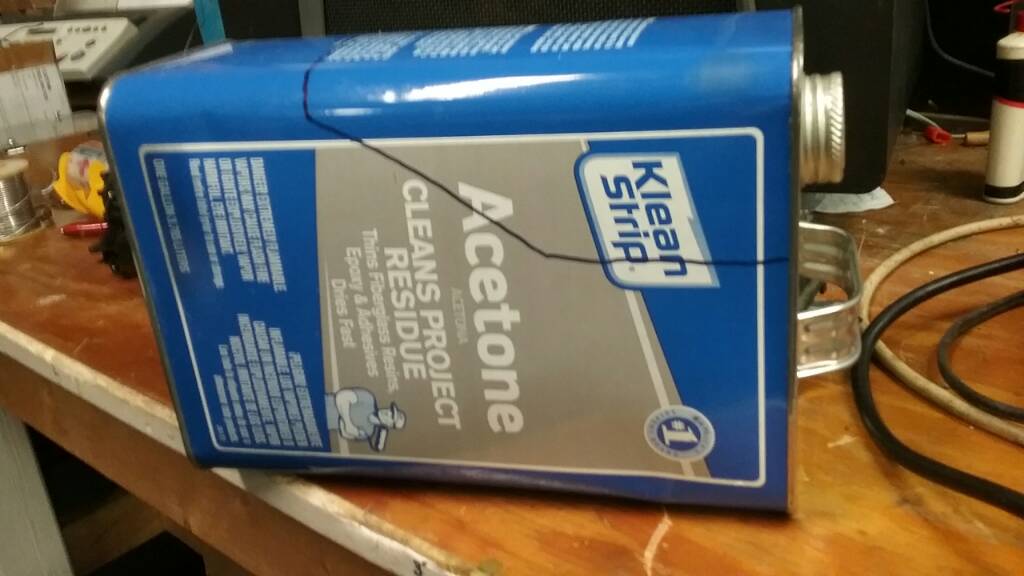

Grandad thought of this years ago (50s). Instead of throwing one gallon metal cans away he cut as shown by the black line, straight down about 5", up at angle across, down other side to match, removing the spout area. Pliers he'd bend sharp edge inside 1/4". Then lined up on a shelf. Each one different sized nails, screws, etc.
You saw what it was then it had a handle to pick it up by, contents went to bottom.20200614_201323.jpg

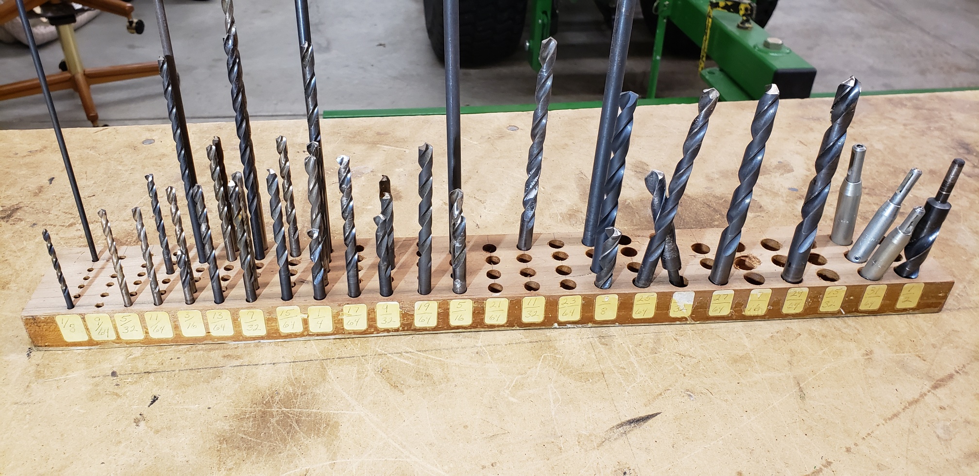

My drill bit holder in 1 inch thick hard wood. Drill each hole a 64th inch oversized to allow for wood movement and about 1/2 inch between bits to have room for getting the bit you want. Identify the sizes with garage sale price stickers and cover the stickers with clear tape to keep them on the board and clean.

Nice! I need a misc bit rack like this. So many are laying down mixed up that I have no clue what I have.
BUT what do you do to make your largest drill size hole 1/64th oversized? :laughing:

You buy a drill bit that size, drill the hole and then throw the bit away.

That’s a good idea. I use an old can opener and just cut the top off.

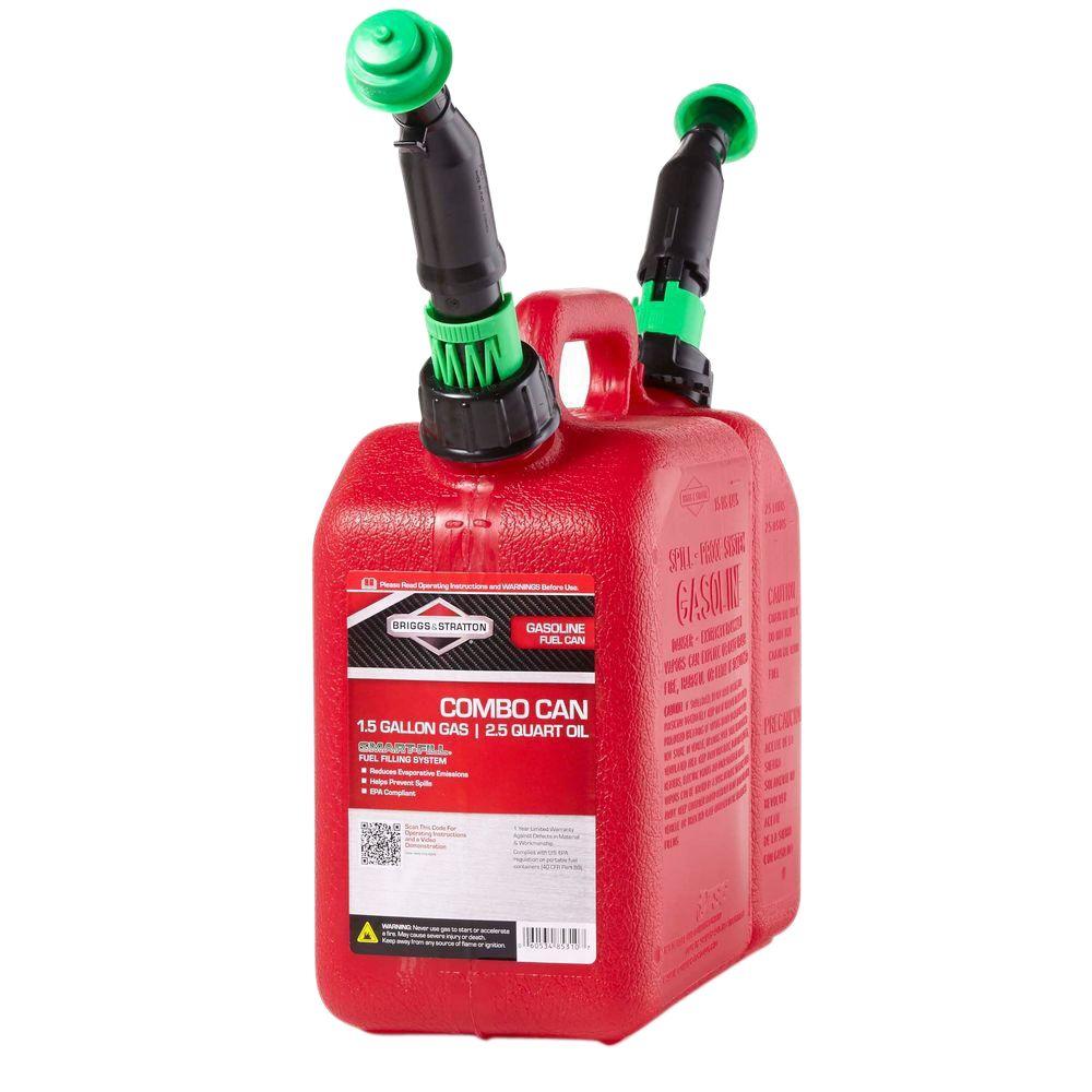

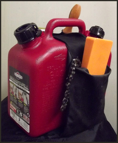

I use the 2-in-1 gas cans. One side is 1.5 gal of fuel, the other is 1/2 gal of oil. The spouts it came with are horrendous. I've just been too occupied (or lazy?) to find alternatives that work better.
In searching for an image I discovered they make a saddle pack for this type of can. This is now on my shopping list.

Easy-peasy solution as I have a similar can for 2-stroke/chain oil... I replaced the both of the spouts with the cut-off tops of 1.5 ltr (or whatever equivalent size in Imperial) plastic drink bottles.
Cut across at the 'flare' so that when you screw down the lock-collar, with the ring gasket, you get a good seal. Now you have a short spout with a screw-cap that's a heck of a lot easier to manage and fill the smaller tanks of you chainsaw, whipper-snipper, etc...

I had to read twice to picture what you said. Good idea!
