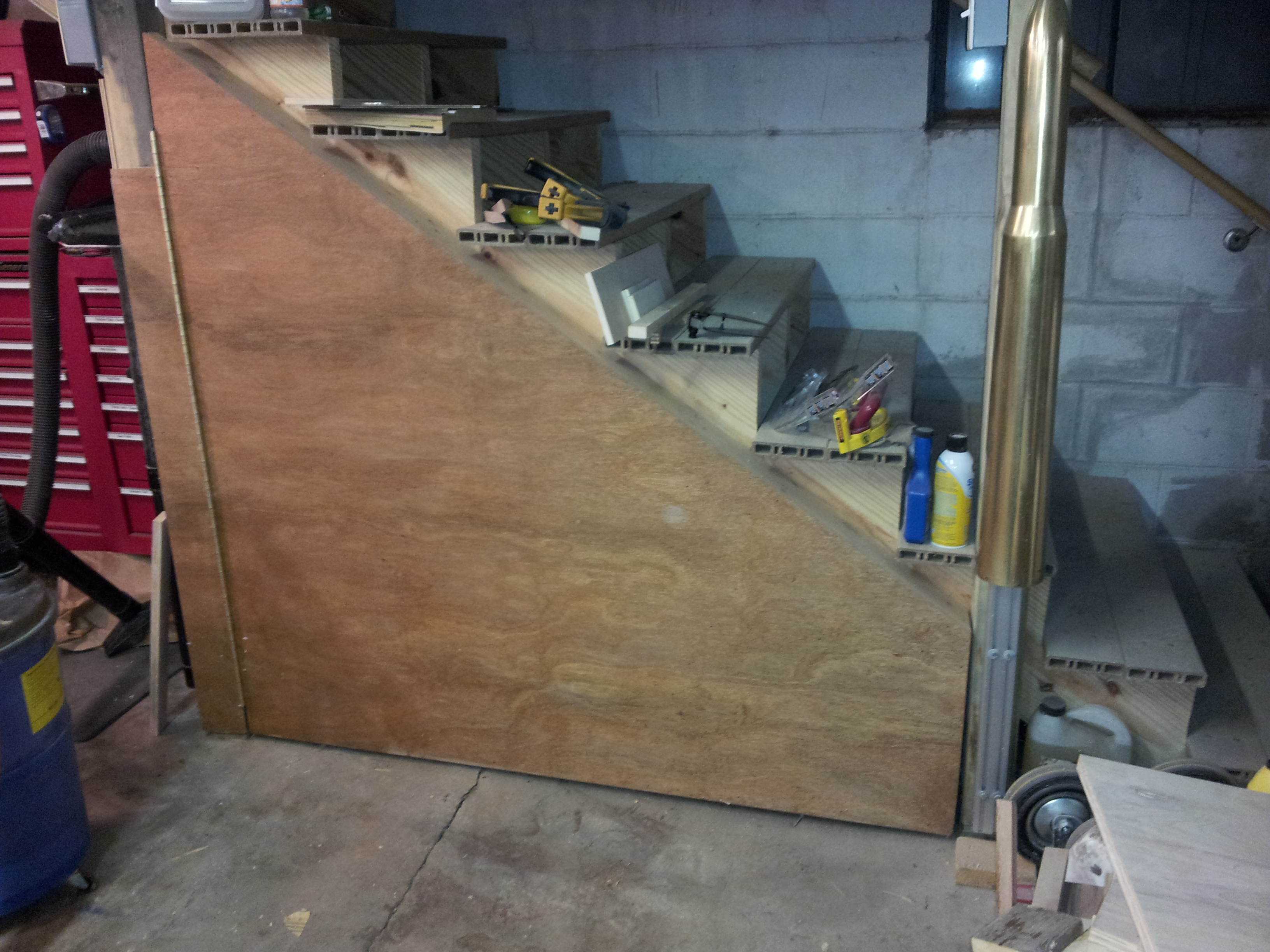

Homemade heavy duty hinge A.K.A. Mother of Piano Hinges
Bought 1/4" spring steel piano wire from hobby shop, 12 hinges from Menards. Removed hinge pins, ran 1/4" drill thru hinge parts, reassembled on 4' piano wires.
View attachment 682025 View attachment 682026
96 wood screws later, have large under stairs door for chemical storage. No problems in 16 years.
This is real smart!
