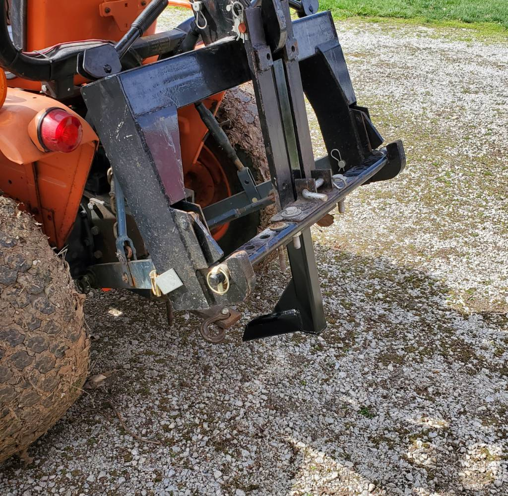

/ Small trencher
#13
We made one at work the other day, seems to work pretty well. Just too muddy to get back where I want to trench right now.
/ Small trencher #14
Love to see homemade implements. I like the use of the 3pt drawbar. Whenever im daydreaming some kind of homemade attachment I always seem to forget that you don't have to build the lower pins mounting points if you just make the thing bolt to a 3pt drawbar.
