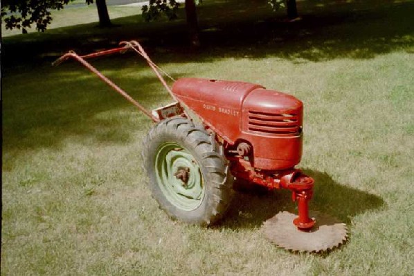

I had one like this at the David Bradley site. It worked OK but only used it a couple times as a chain saw was faster because of more maneuverability. As you can see it was a pretty simple rig, run off the motor by a twisted belt over a couple idler pulleys. I should be easy to fabricate one to run off the PTO, maybe use a 90 degree drive rather than belt.
I wish I still had that old DB as it had many other attachments with it also including a front mount buzz saw, sickle bar and reel mowers, plow, disc and cultivator. I think I sold the whole shebang for about $20
