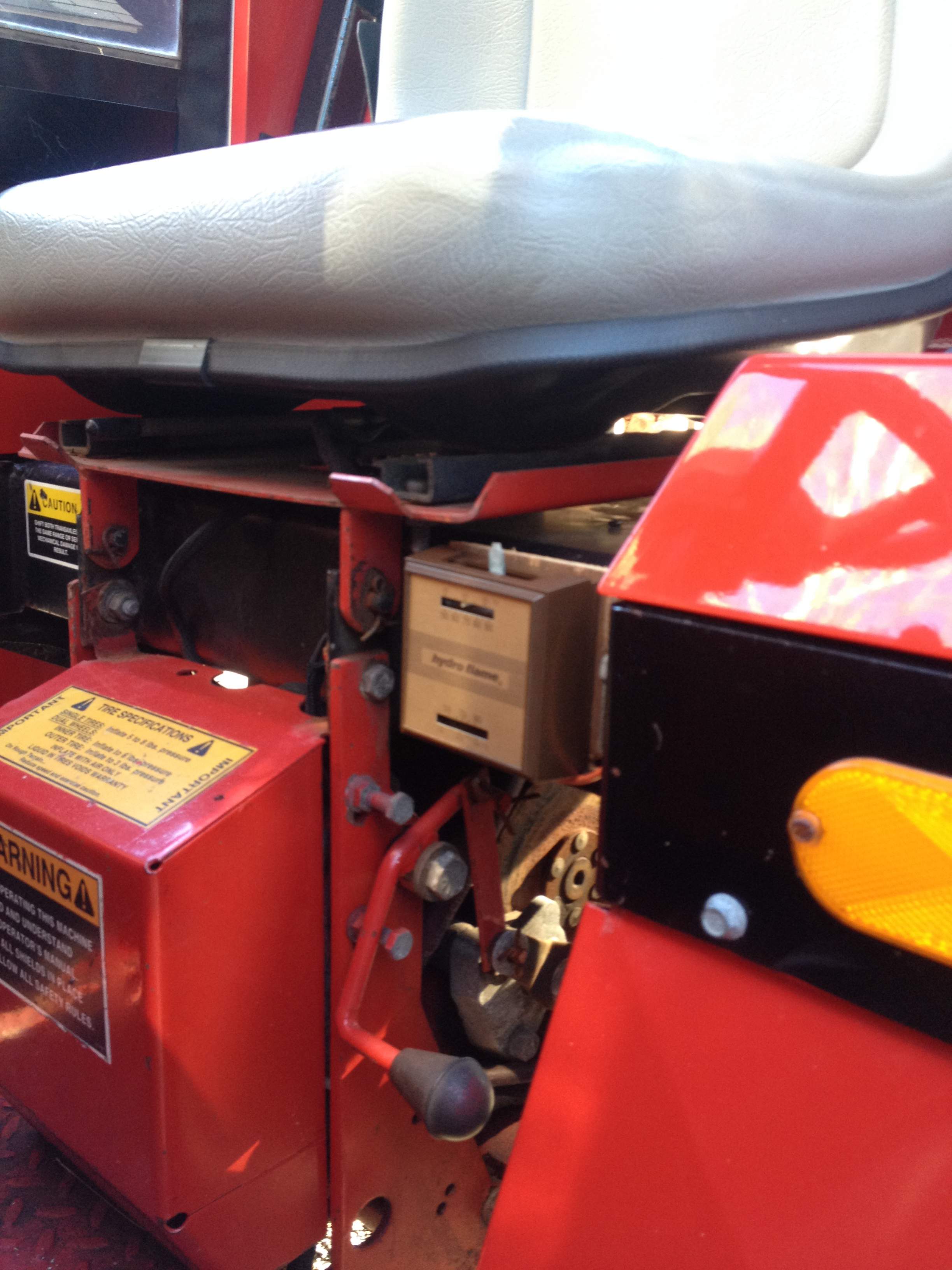

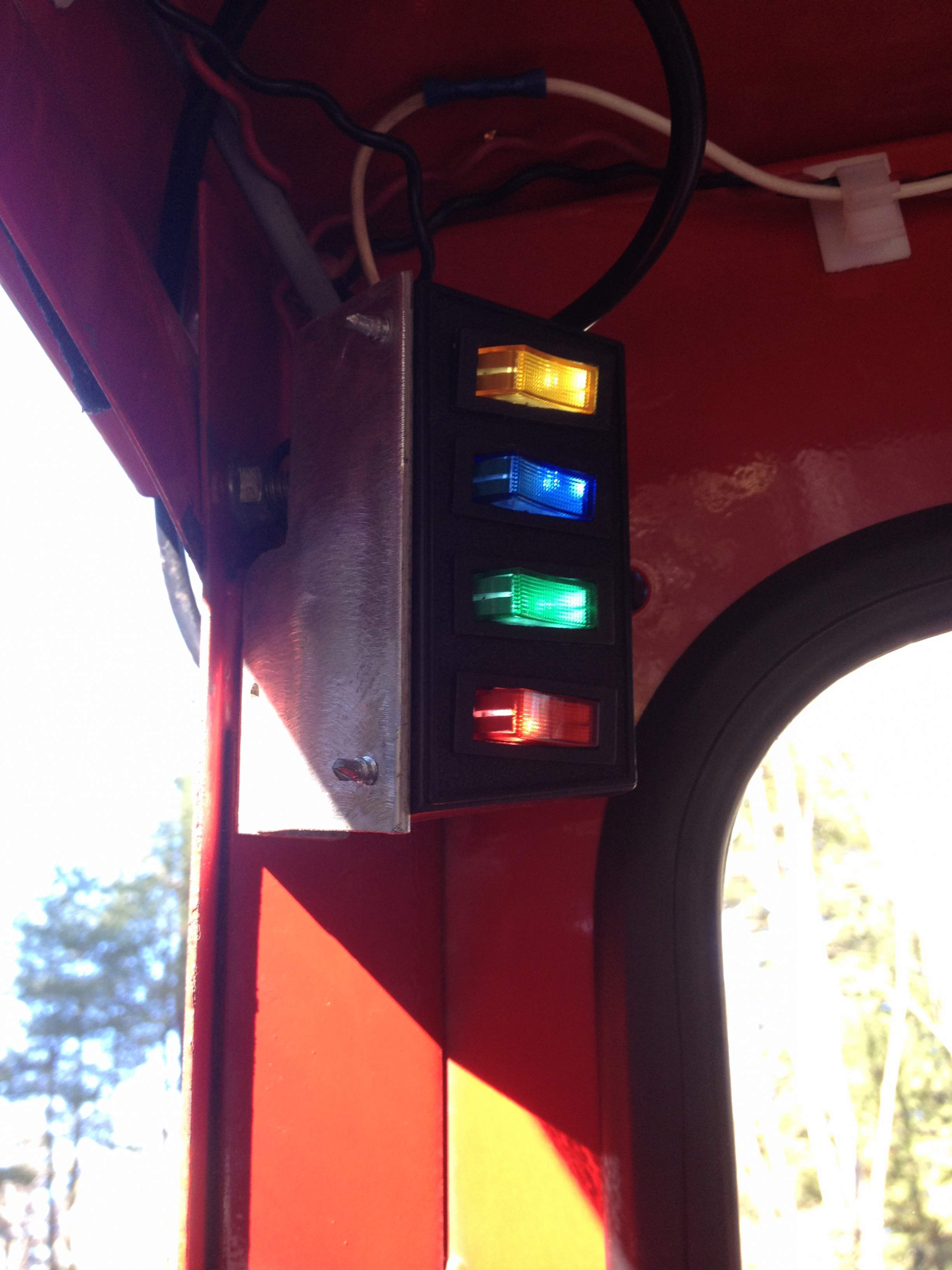

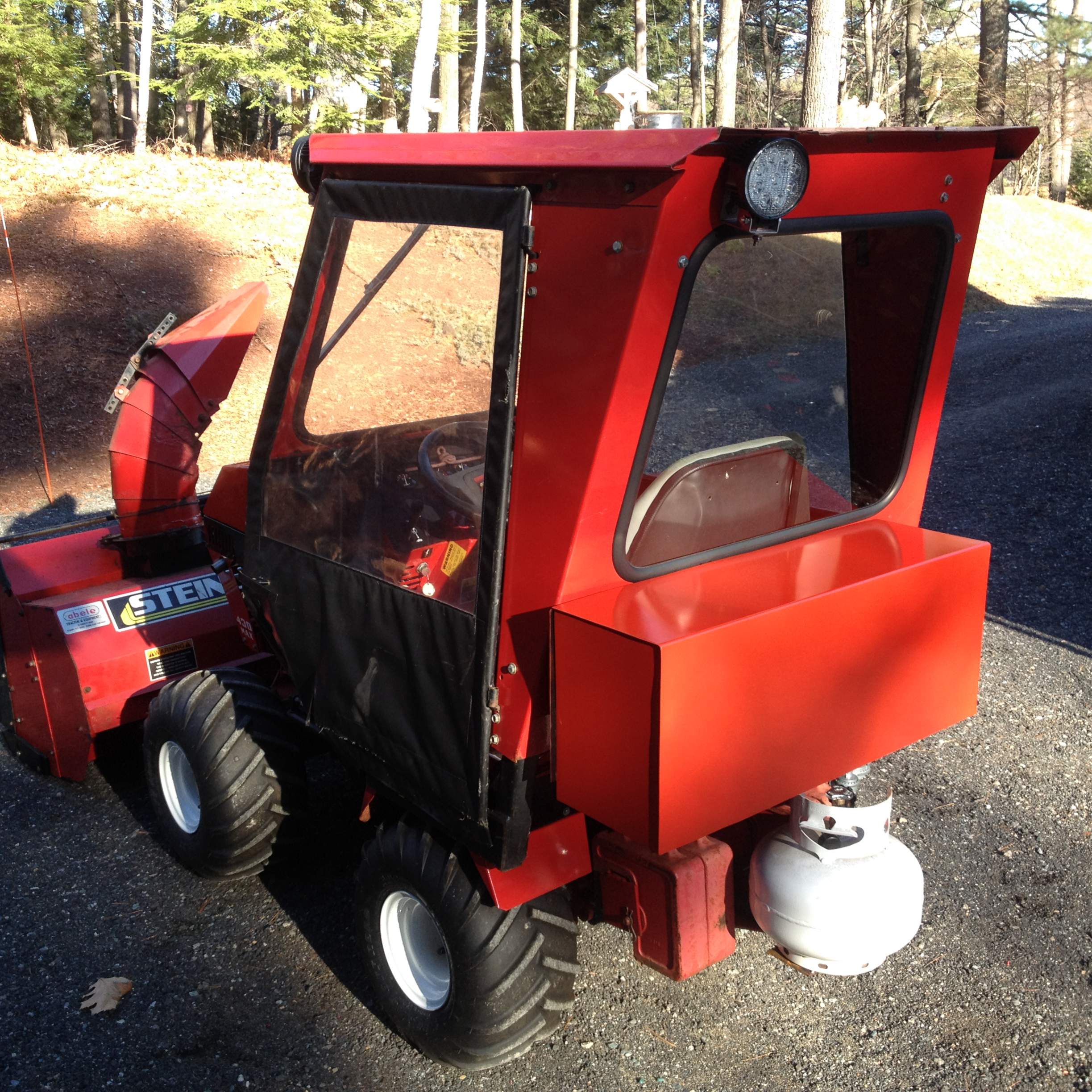

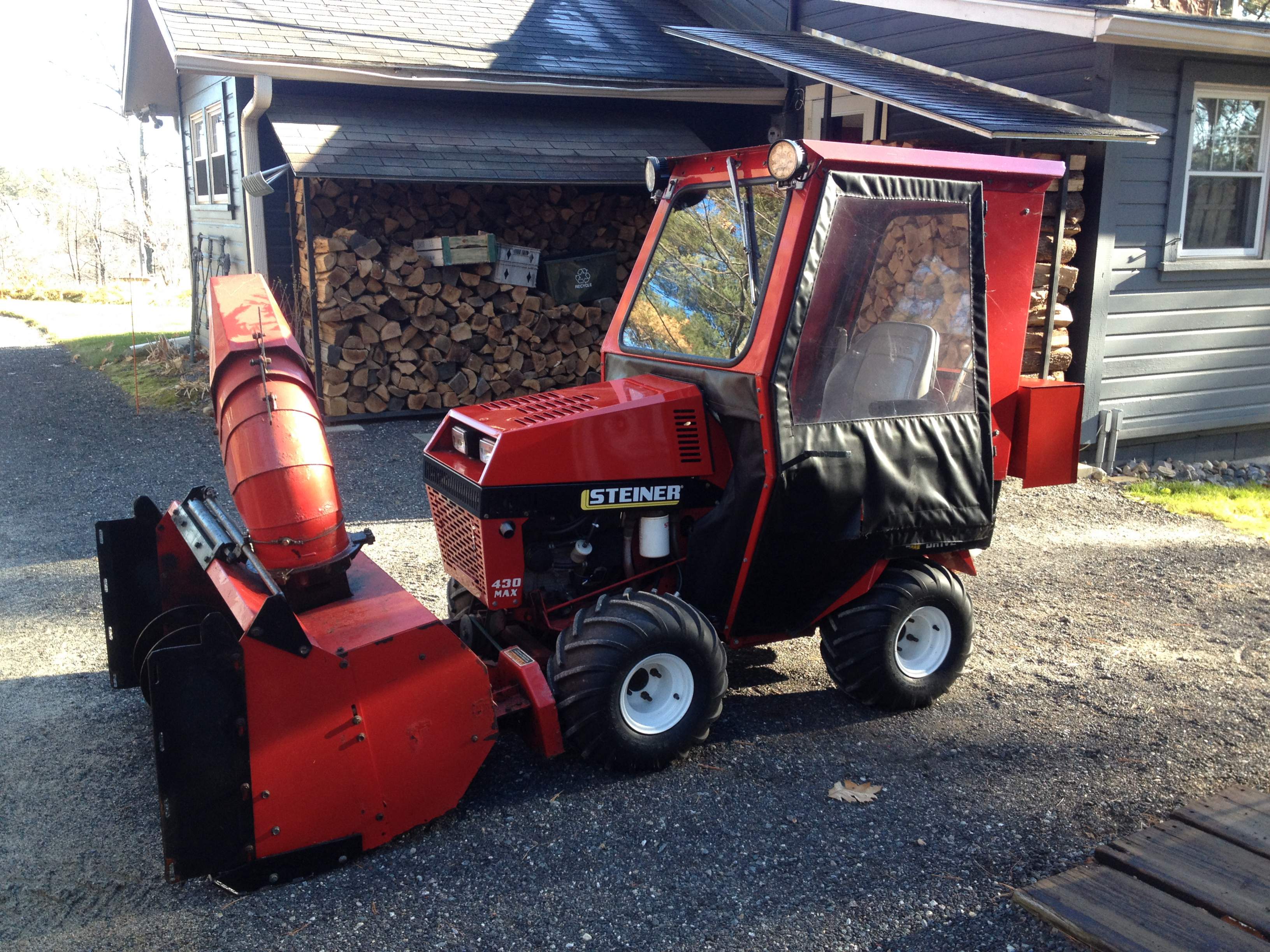

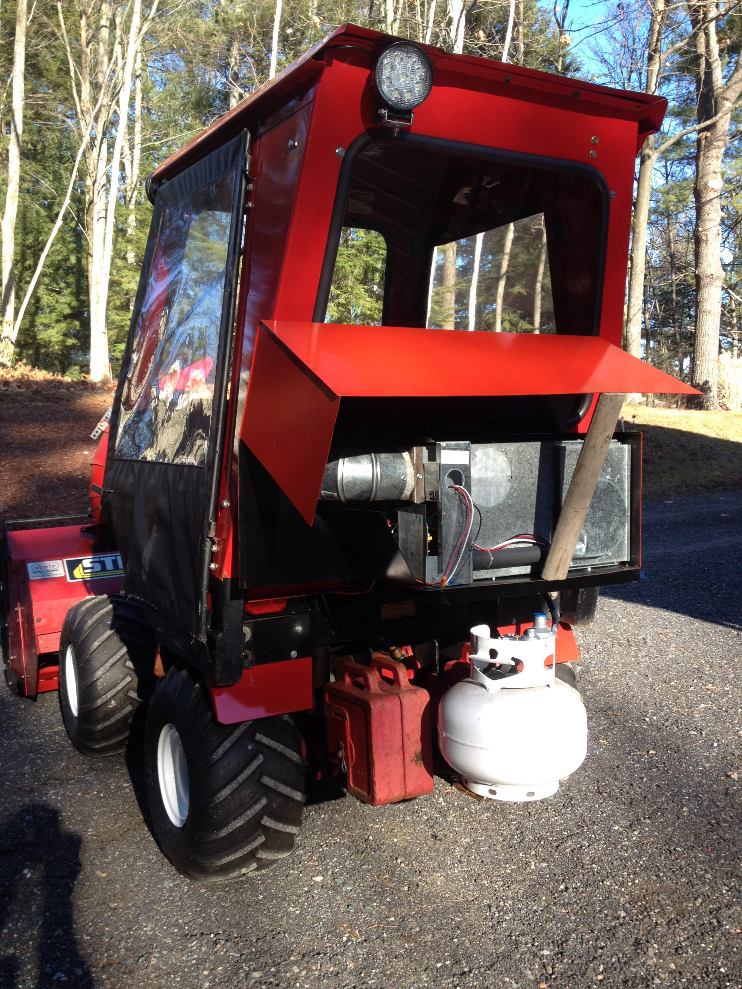

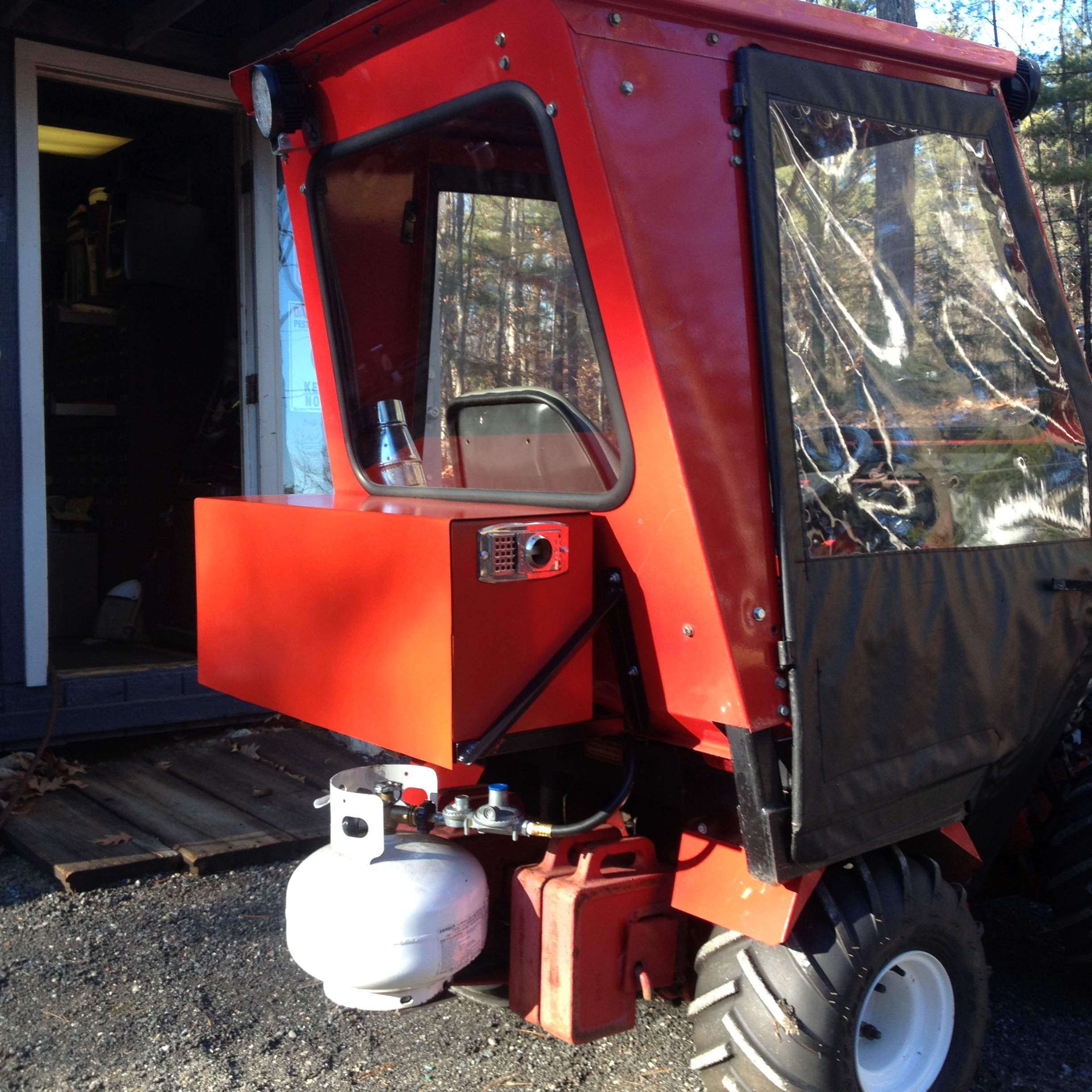

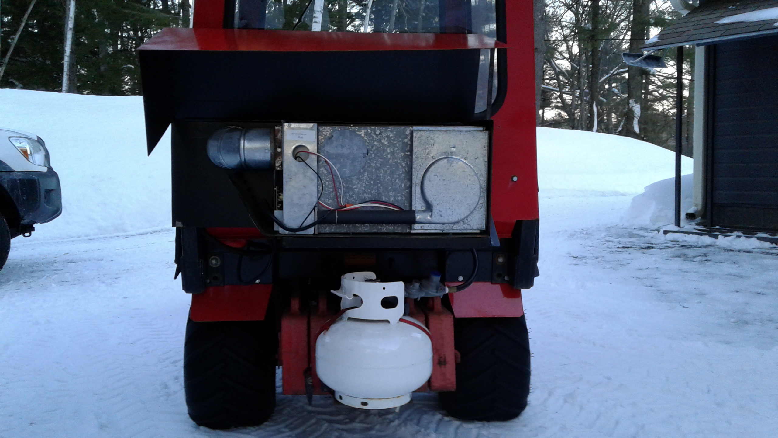

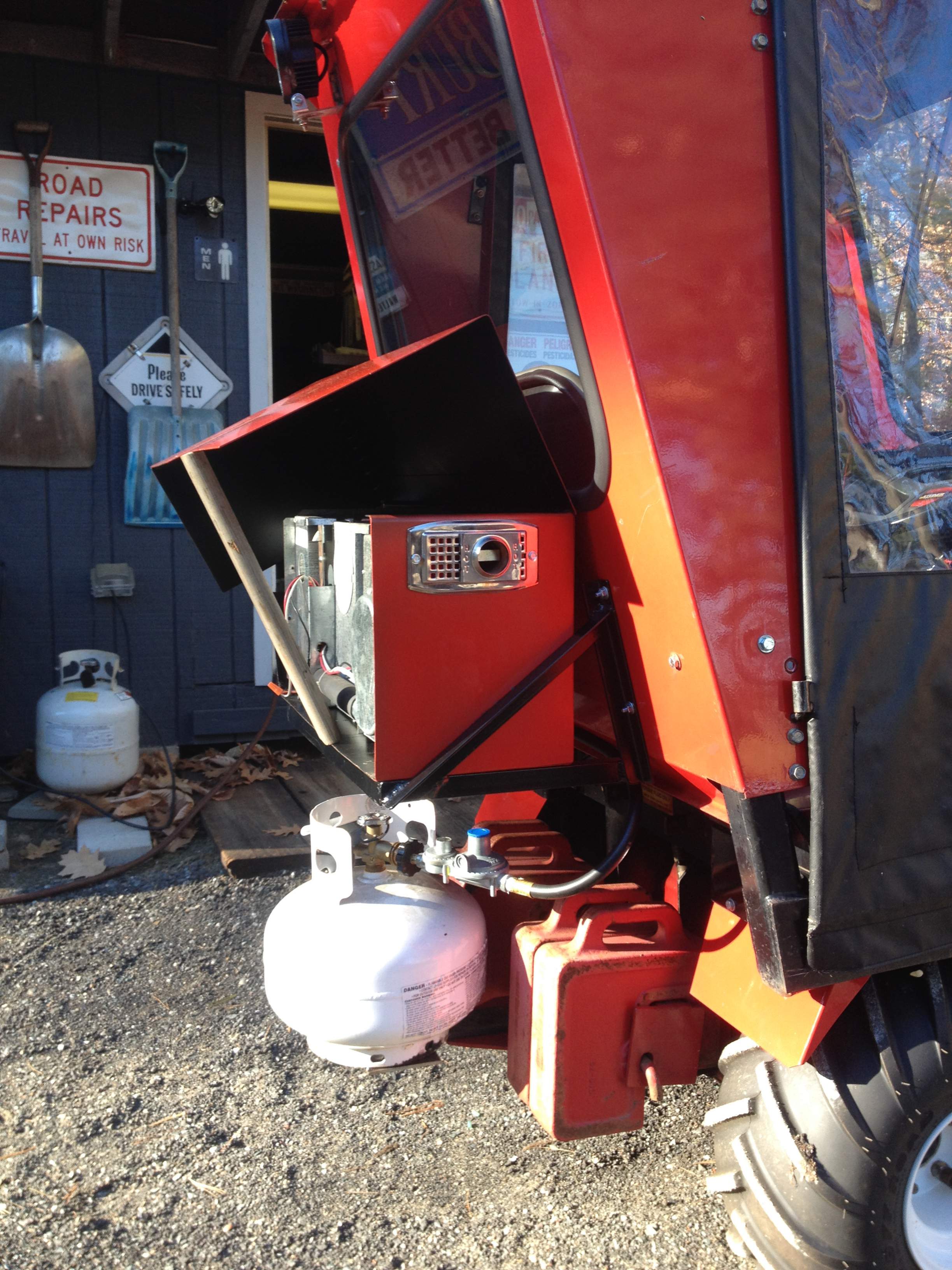

Getting closer to wrapping this project up. Painted the enclosure, mounted same with furnace and ductwork, ran the propane line, finished up the tank mount, mounted the thermostat to a magnet for adjustment purposes, wired in a switch panel for the wiper, lights, the furnace, and an extra for a fan. Test fired it for the first time today and I have to say that I think this is going to work out pretty **** good - good airflow and temp, thermostat works as it should, furnace fires easily and runs smooth. Will finalize the thermostat wiring once I find the right location for it, I think that will have a lot to do with how stable I can keep the temperature in the cab. Thanks for the input and interest, Rick

Saw the hydro flame tstat in your picture. Do you know if it has an anticipator circuit? Some of the older hydro flame stats don't and in a small space, you could get pretty wild temp swings. If it does, I'd adjust it to max anticipation as a starting point. If you get wild temp swings, you could replace it with a new solid state digital thermostat. You can get simple Honeywell units for about $20. I also think some protection around the propane tank is a good idea. At best, a punctured tank is a bad day for the environment. At worst it's an inefficient rocket motor or low yield IED. Either way, I wouldn't want the last two strapped 18" behind my but. Just my 2¢.

Thanks for the kind words and the suggestions. I have a tank guard/bumper fabricated from heavy wall tube stock and some plate almost finished at work, that will mount to the counterweight assembly and should prevent, or at least minimize the chance of unintended explosions. I will have to examine the thermostat more closely - I didn't notice any adjustments but will look again. Working out how to maintain a relatively constant temperature is going to be the next challenge. Thanks for the input and interest, Rick

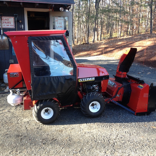

Two years later and this setup is the stones......Uses a minimal amount of propane, keeps me warm and toasty, defrosts the windshield, and makes snowblowing just plain fun, which is important 'cause I spend three to four hours taking care of not only my own driveway, but the road and the neighbors place too. Not a lot of ground speed, but a ton of volume - my next project is an impeller clearance setup and an electric chute angle control system .
