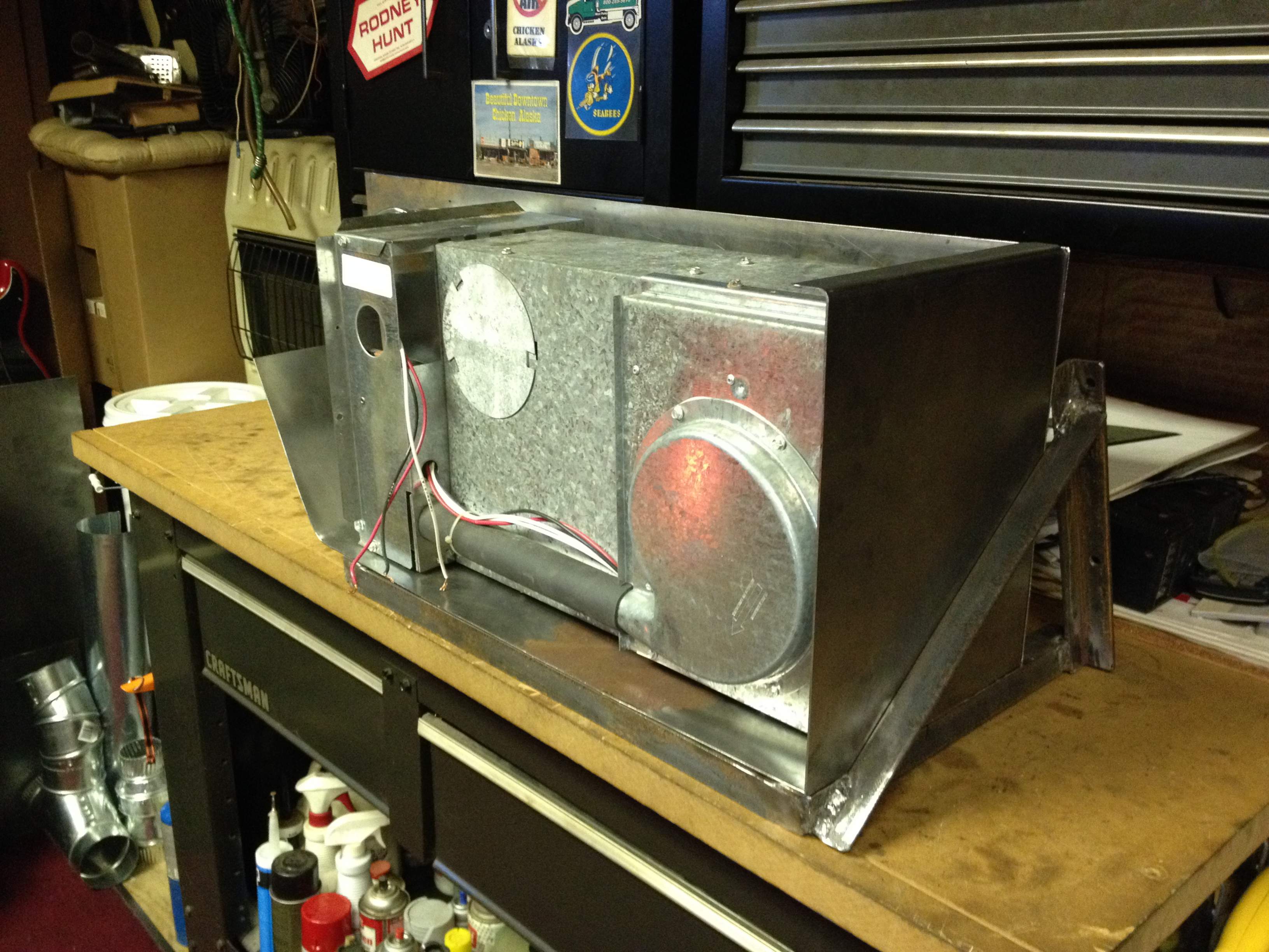

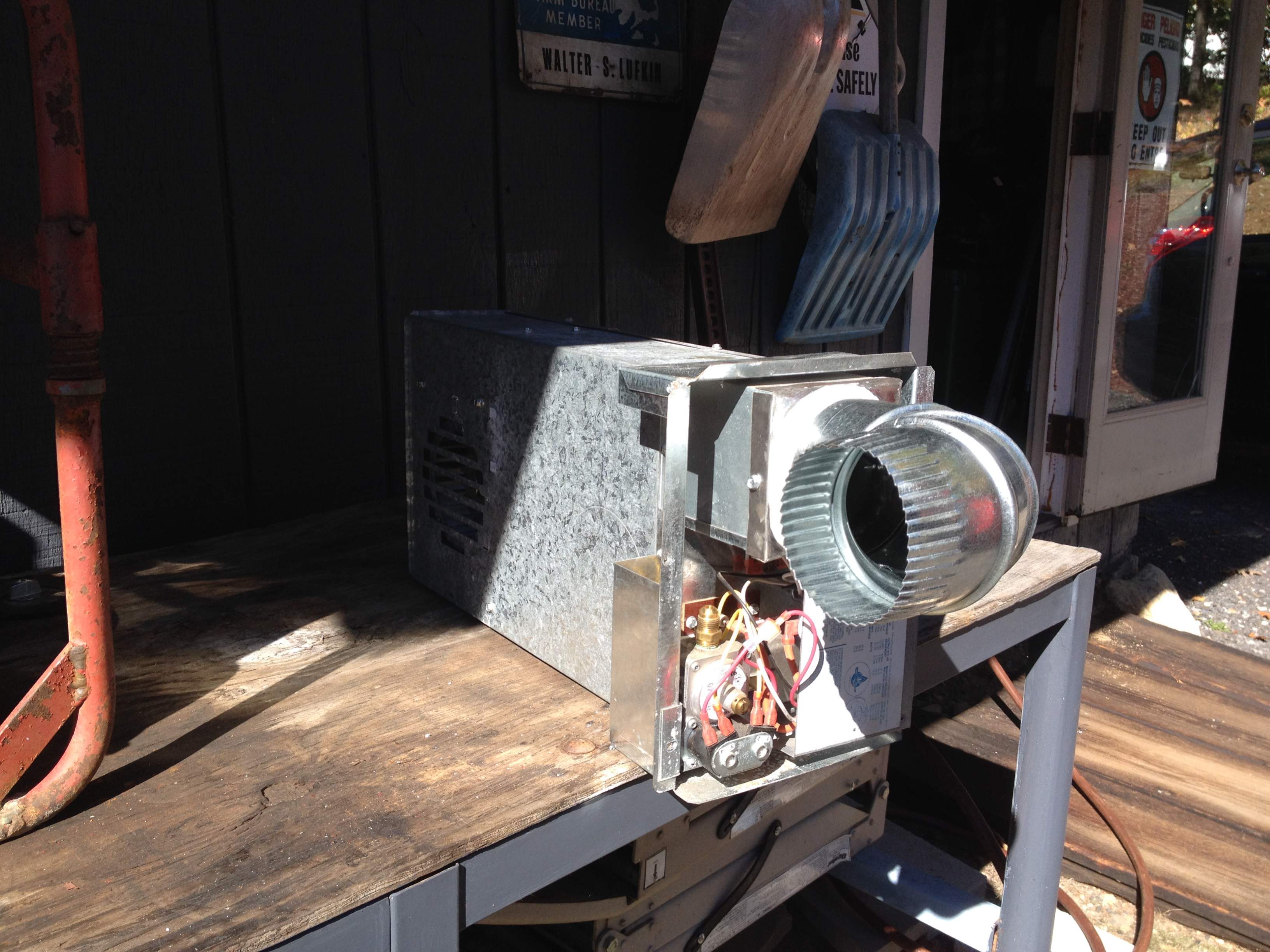

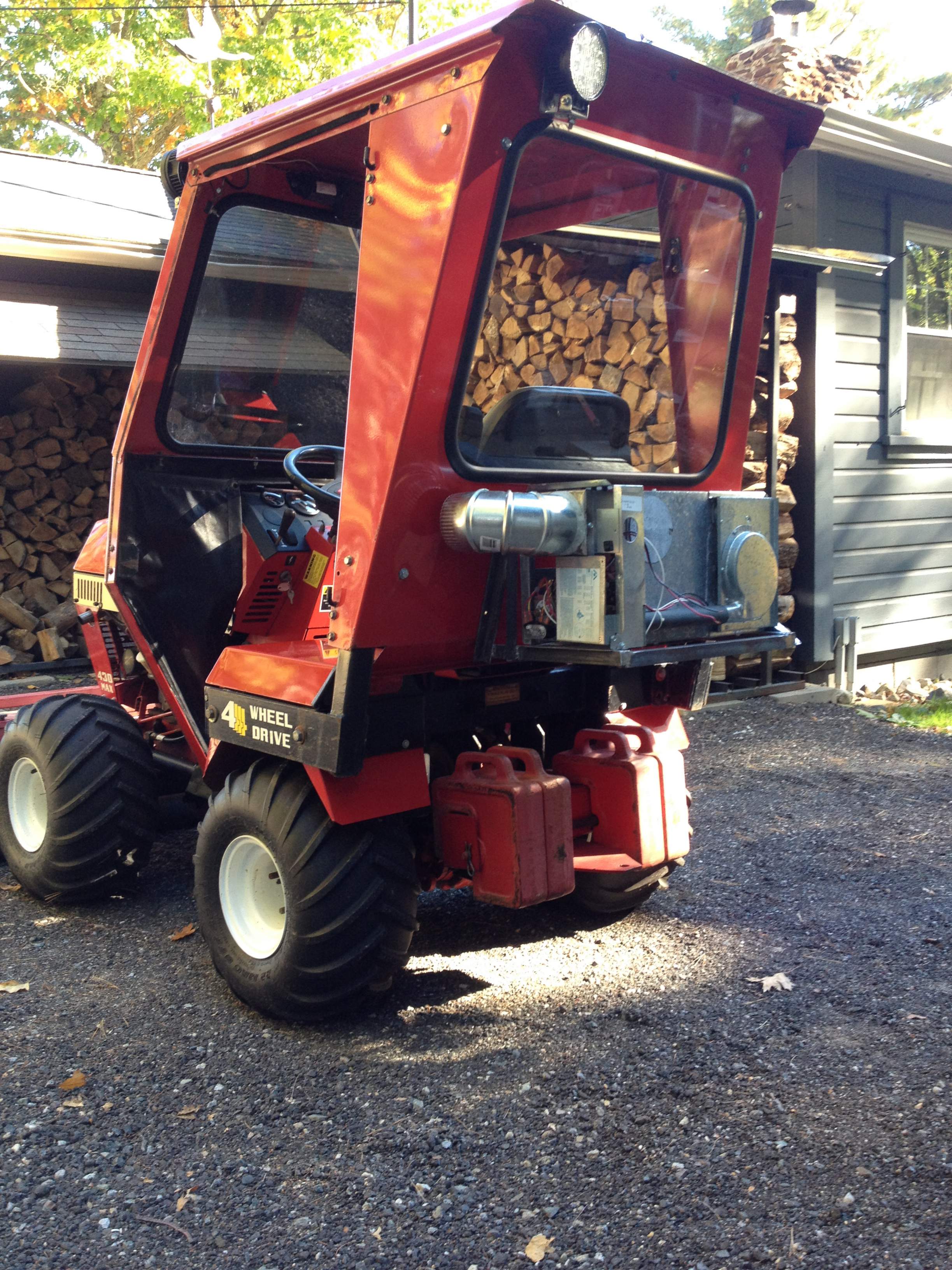

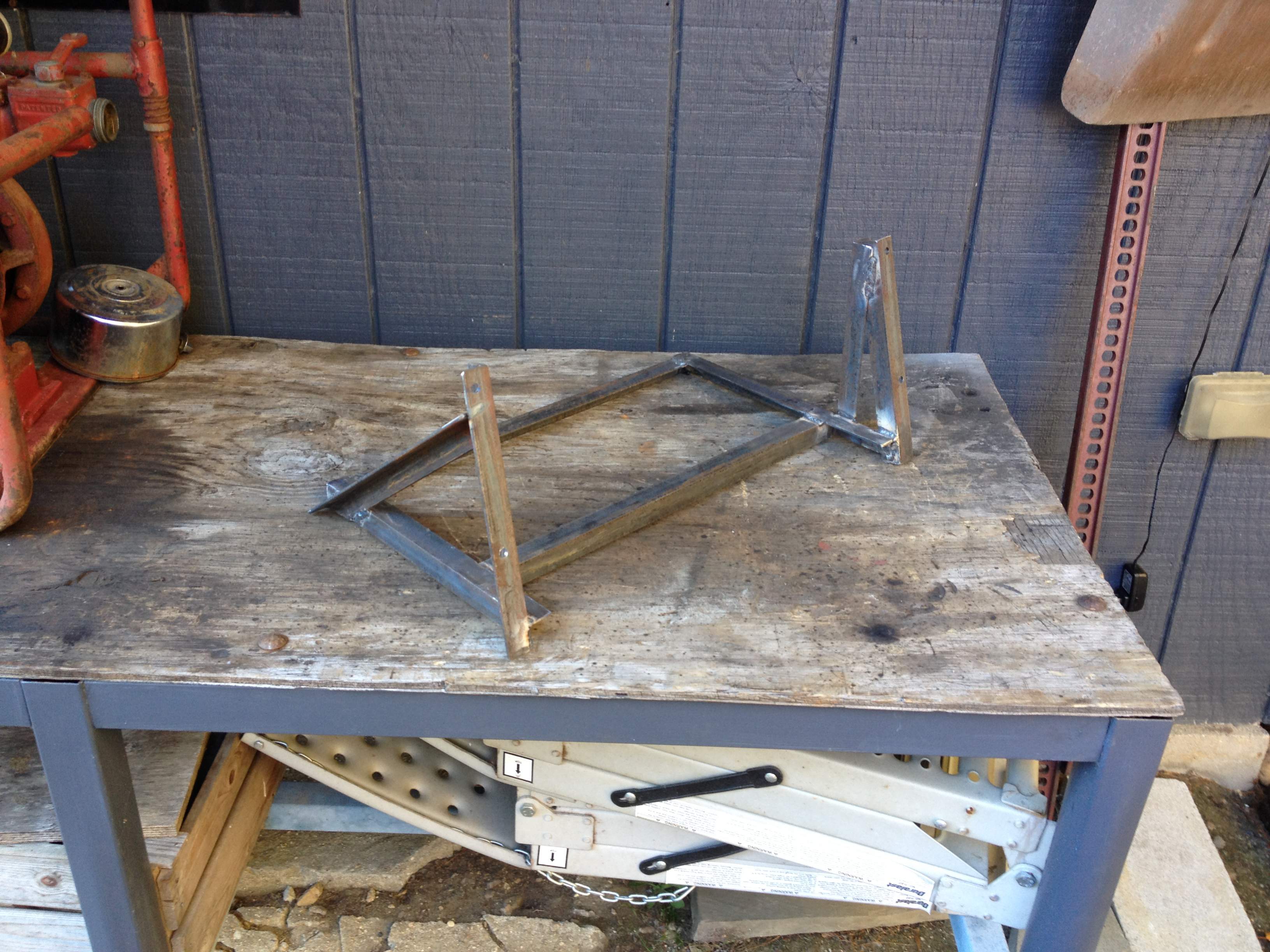

#25

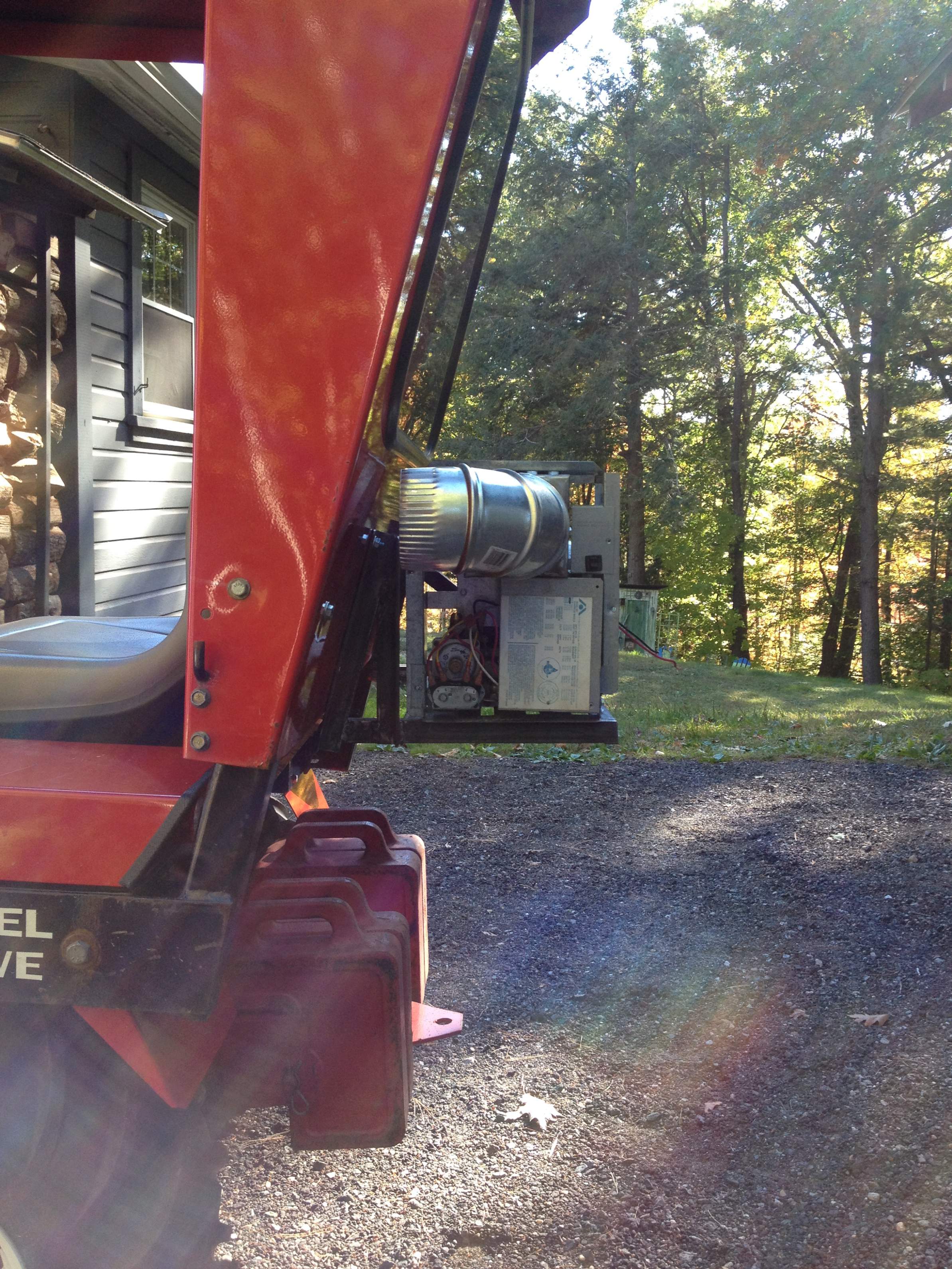

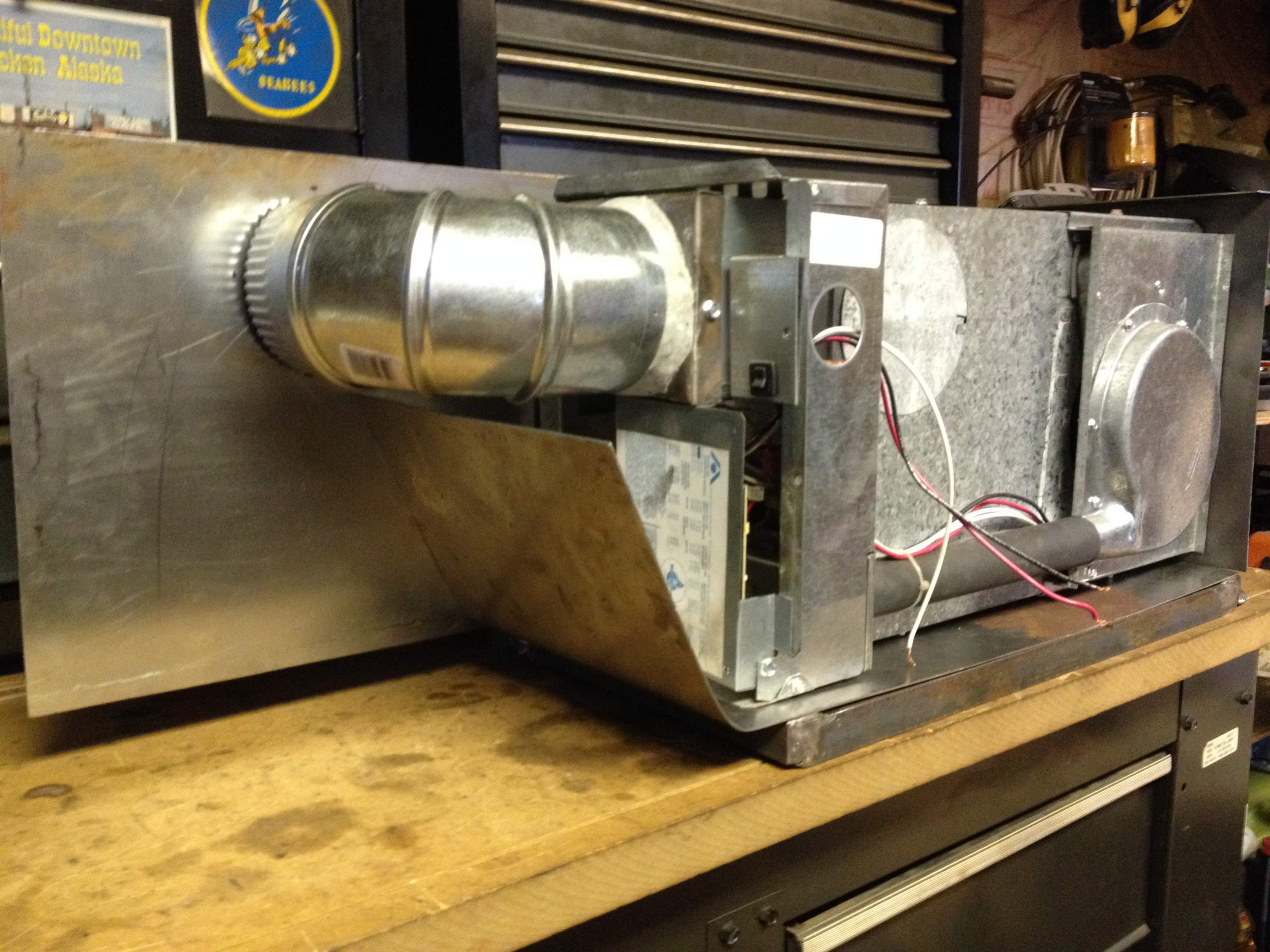

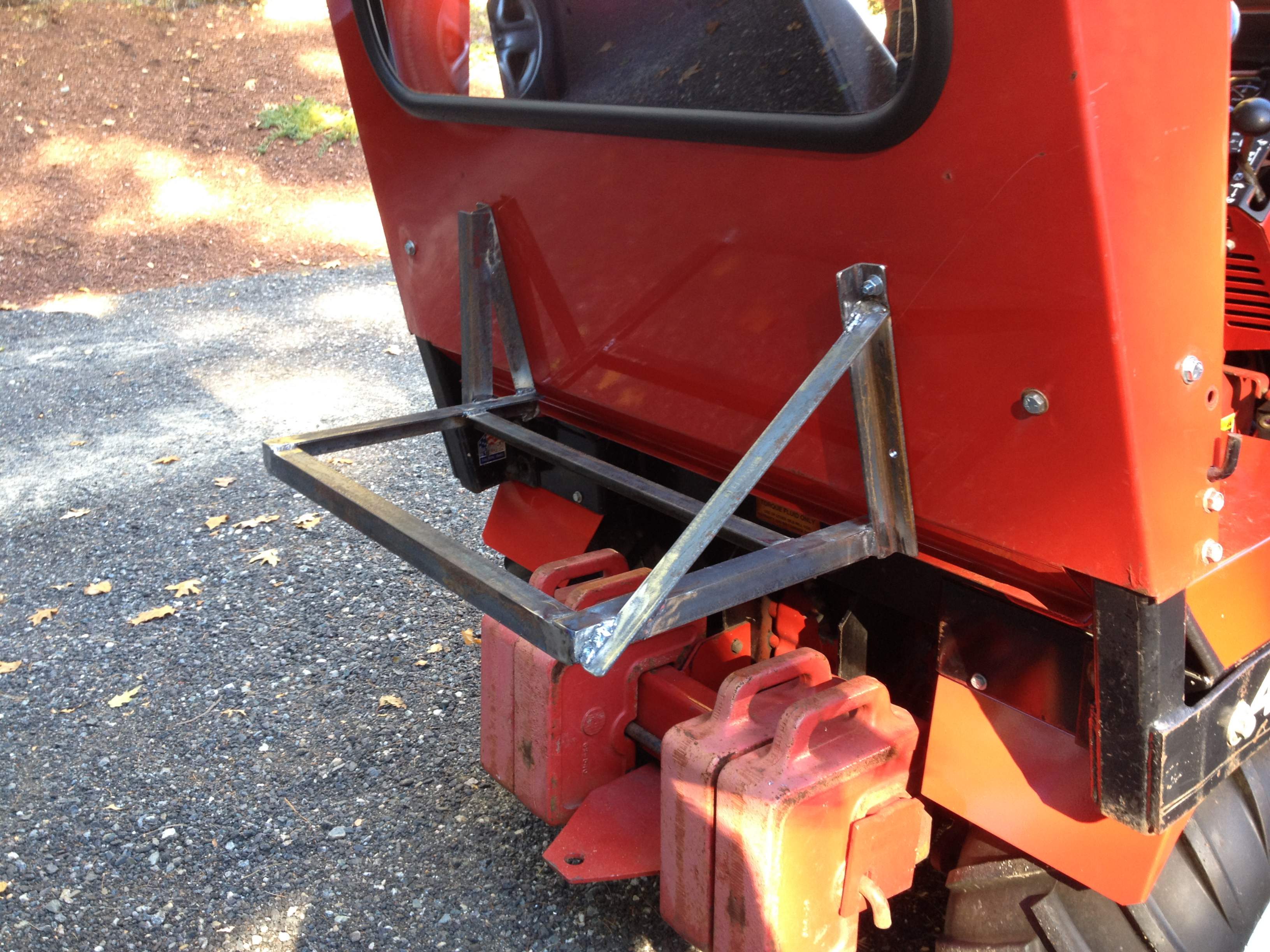

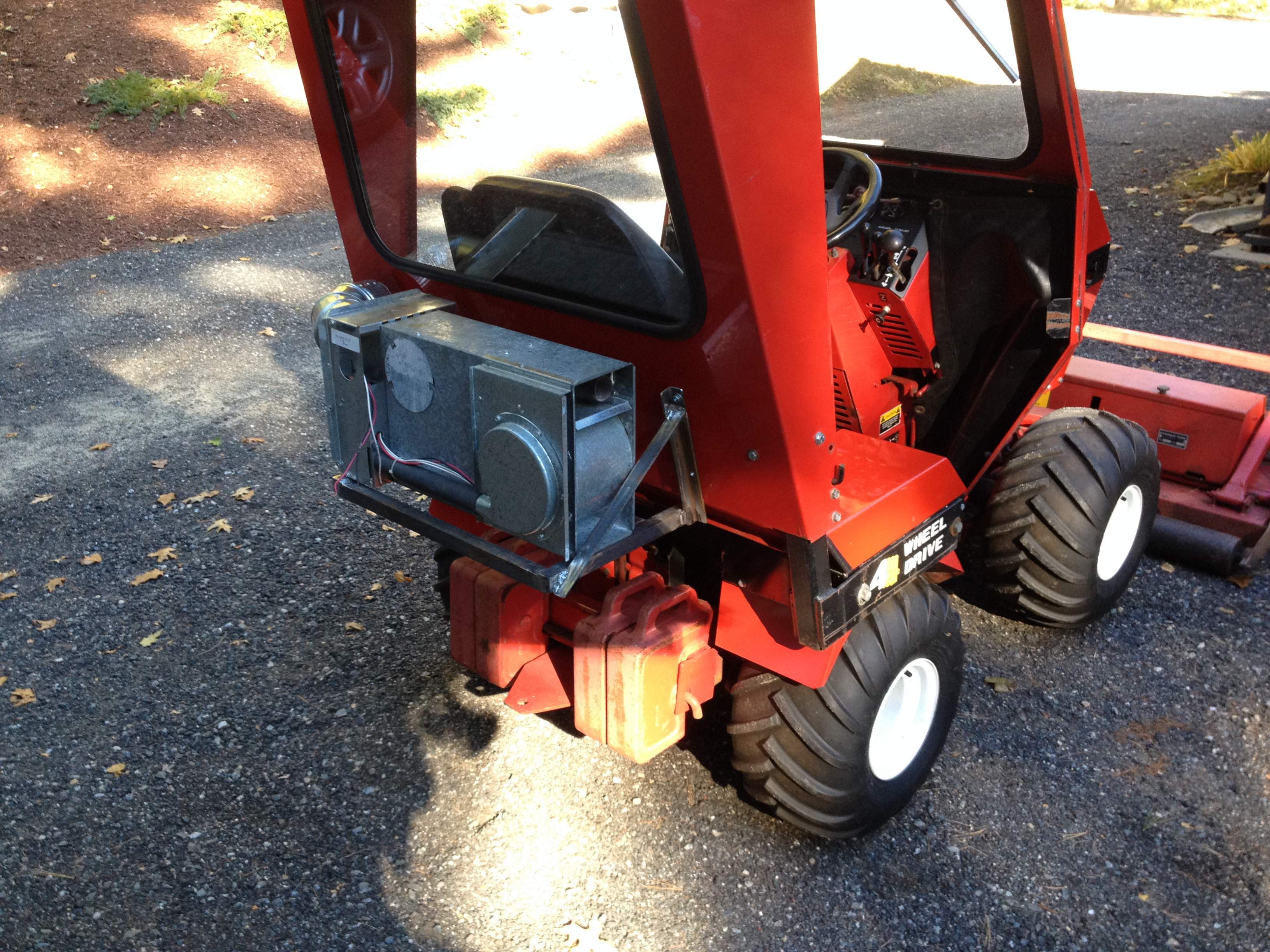

Made some progress on the heat project. I have been acquiring material and parts for the past couple of weeks and today began actual construction. First I made an adapter to go from the 4" by 4 1/4" square furnace outlet to a 4" round 90 degree duct. This will enter the back of the cab and connect to a T, splitting the airflow into two ducts, one to my feet and one along the roof of the cab aiming toward the windshield. Next was the furnace mount itself, which I fabricated from some light angle and is bolted through the back of the cab. For the body of the enclosure I had a piece of 16 gauge bent on a brake to a 90 and will use this as the top and front. The bottom, rear, exhaust end panels, and intake end ducting will be fabricated out of 16 gauge sheet as well. Here are some pics of todays events. Thanks for your input and interest, Rick

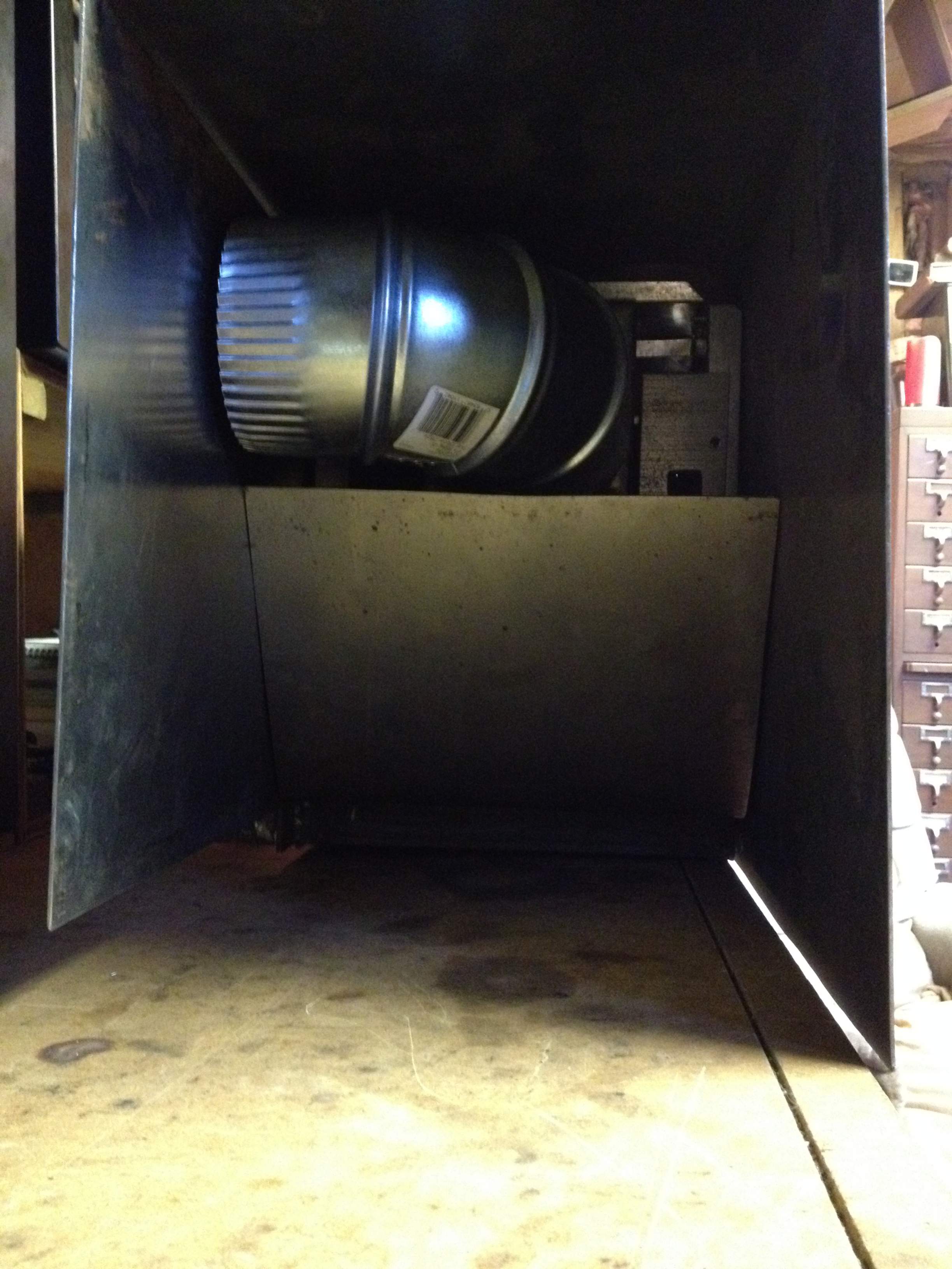

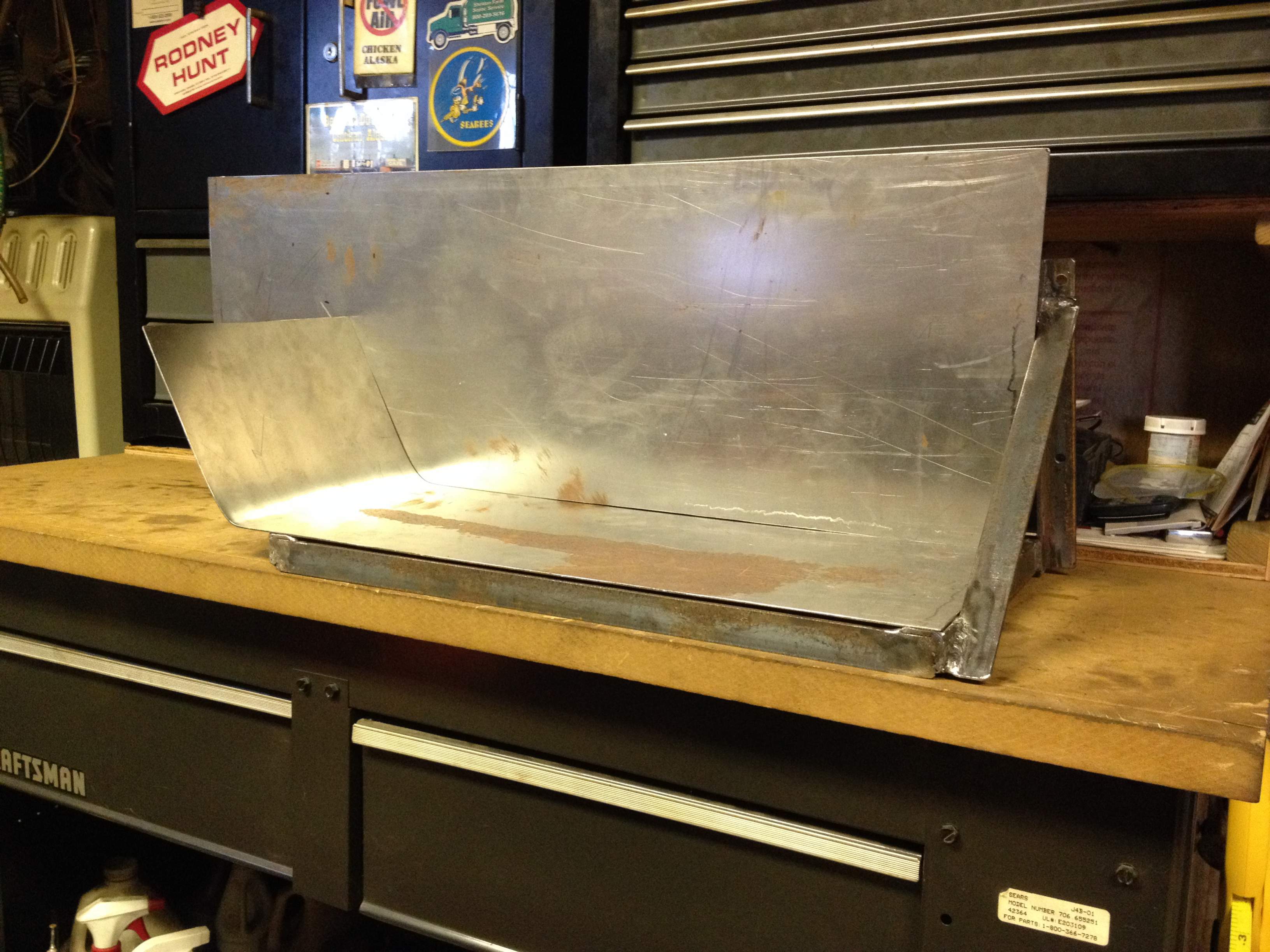

#26

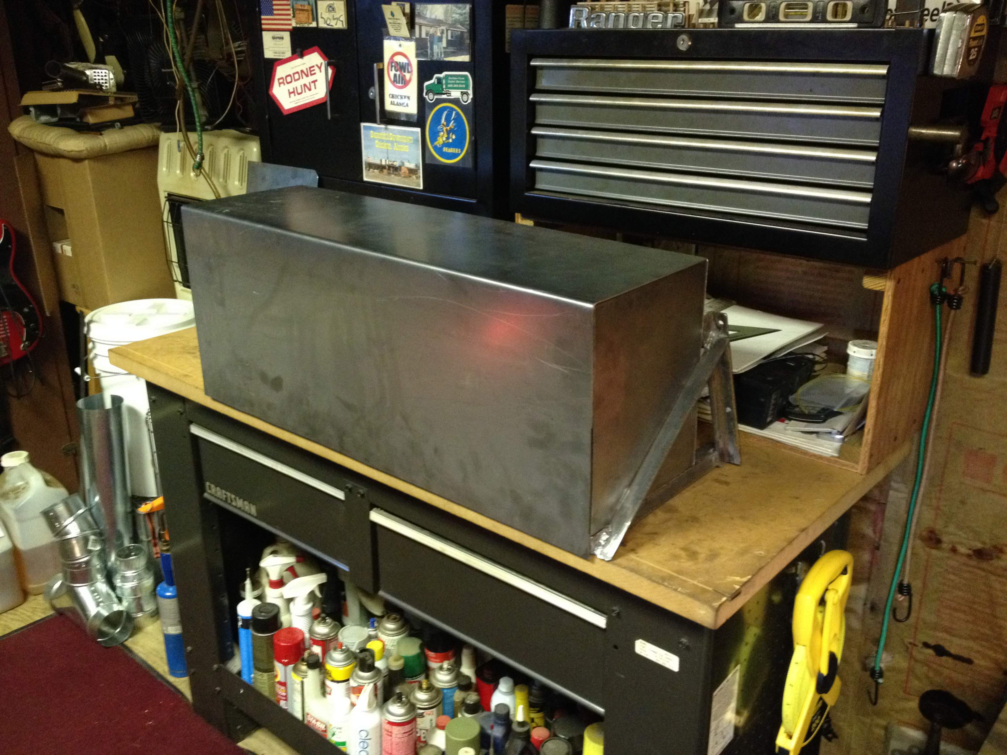

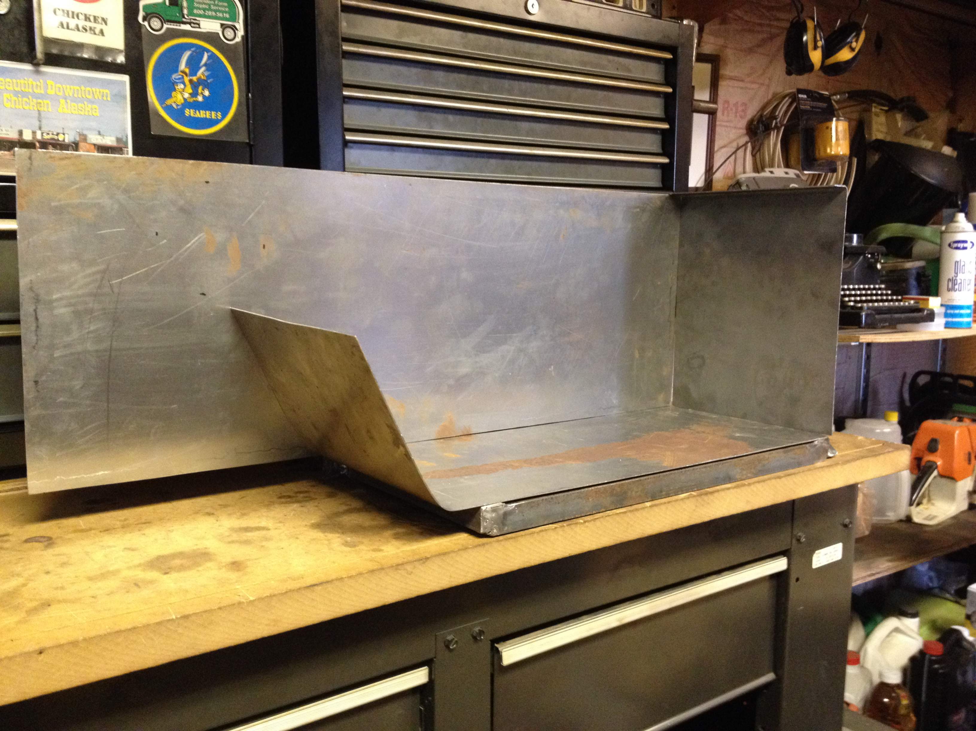

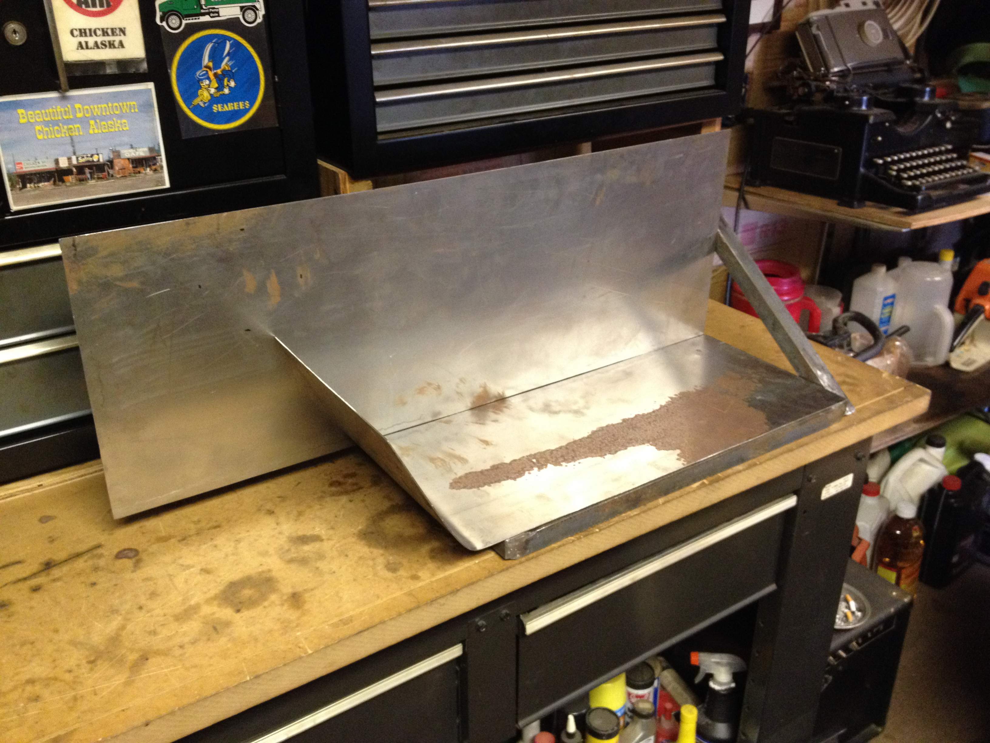

Made a little more progress on the body of the furnace housing. Fabricated the panels and hood yesterday and will bring the whole shooting match to work tomorrow so I can weld it up. I still have to cut the holes for the hot air duct and for the exhaust. Not sure if it is clear in the pictures but the idea is to draw the intake air in from underneath, around the baffle and over the exhaust elbow in an attempt to minimize the amount of snow that reaches the furnace itself. Still have to cut the hole in the cab and run the ductwork, wire the thermostat, and make the propane tank mount - sooner rather than later 'cause this morning I woke up to snow on the deck...........Thanks for the input and interest, Rick

   / Small RV furnace for cab heat......... #27
I think this will work, well. If fact it will almost work too well, unless you can de-rate it. Nice work!
#28
Thanks. I can de-rate it to 9K BTU's if necessary - temperature control and airflow are what I'm trying to figure out. It's going to take a balance between all of it to get it to run as evenly as possible, minimize the on/off cycles and maintain an even cab temp. The furnace moves a decent volume of air at I think enough velocity to still be effective when ducted.......I come out of the furnace to a 4" 90 which will be close coupled to a 4" tee with opposite outlets reduced to 3" then through 3" flex duct to the windshield and footplates - all of which still has to be made and installed. I hope this will work well, I think it ought to, but I think there is going to be a fair amount of tweaking involved before this thing runs the way want it to.
