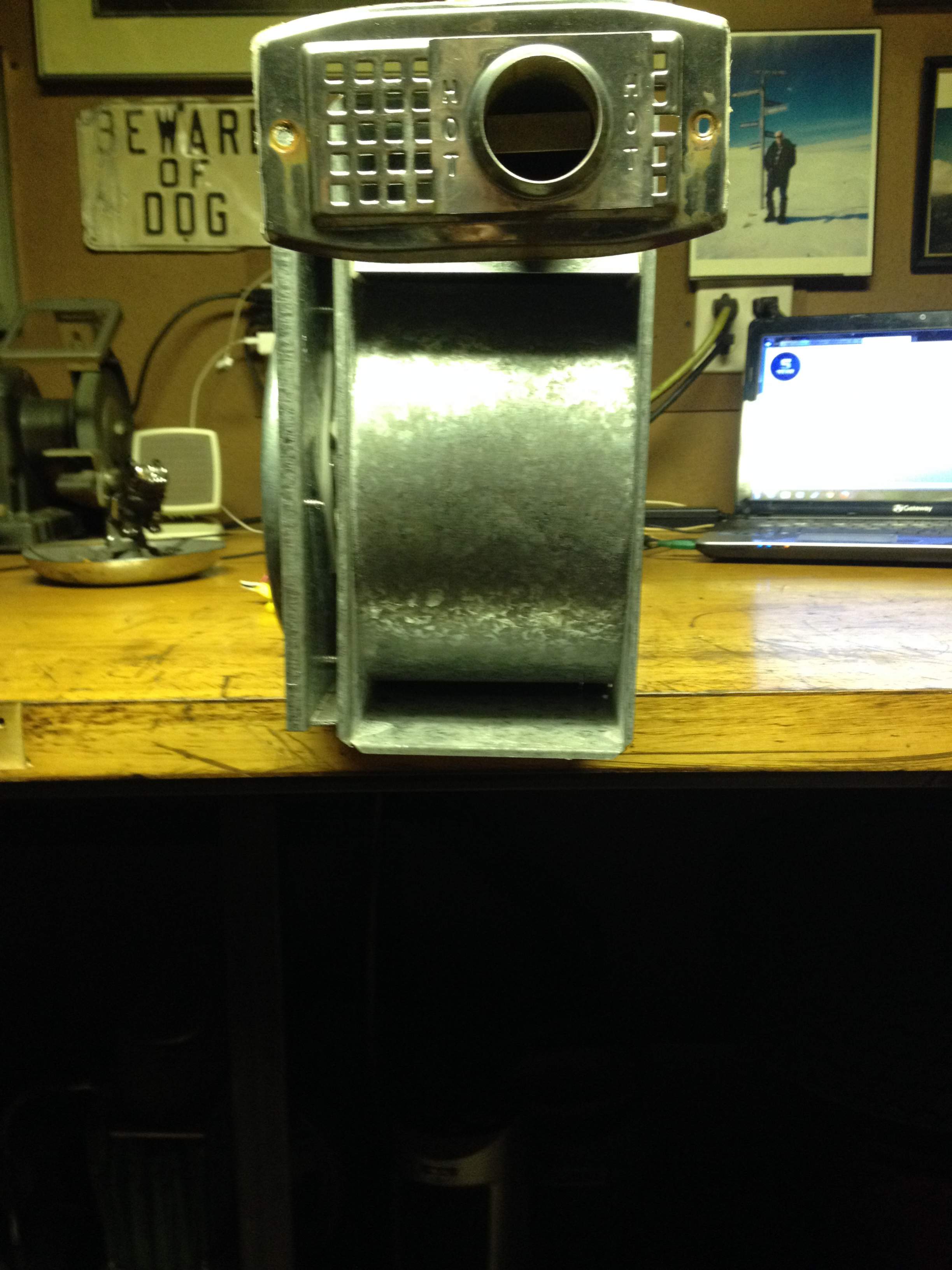

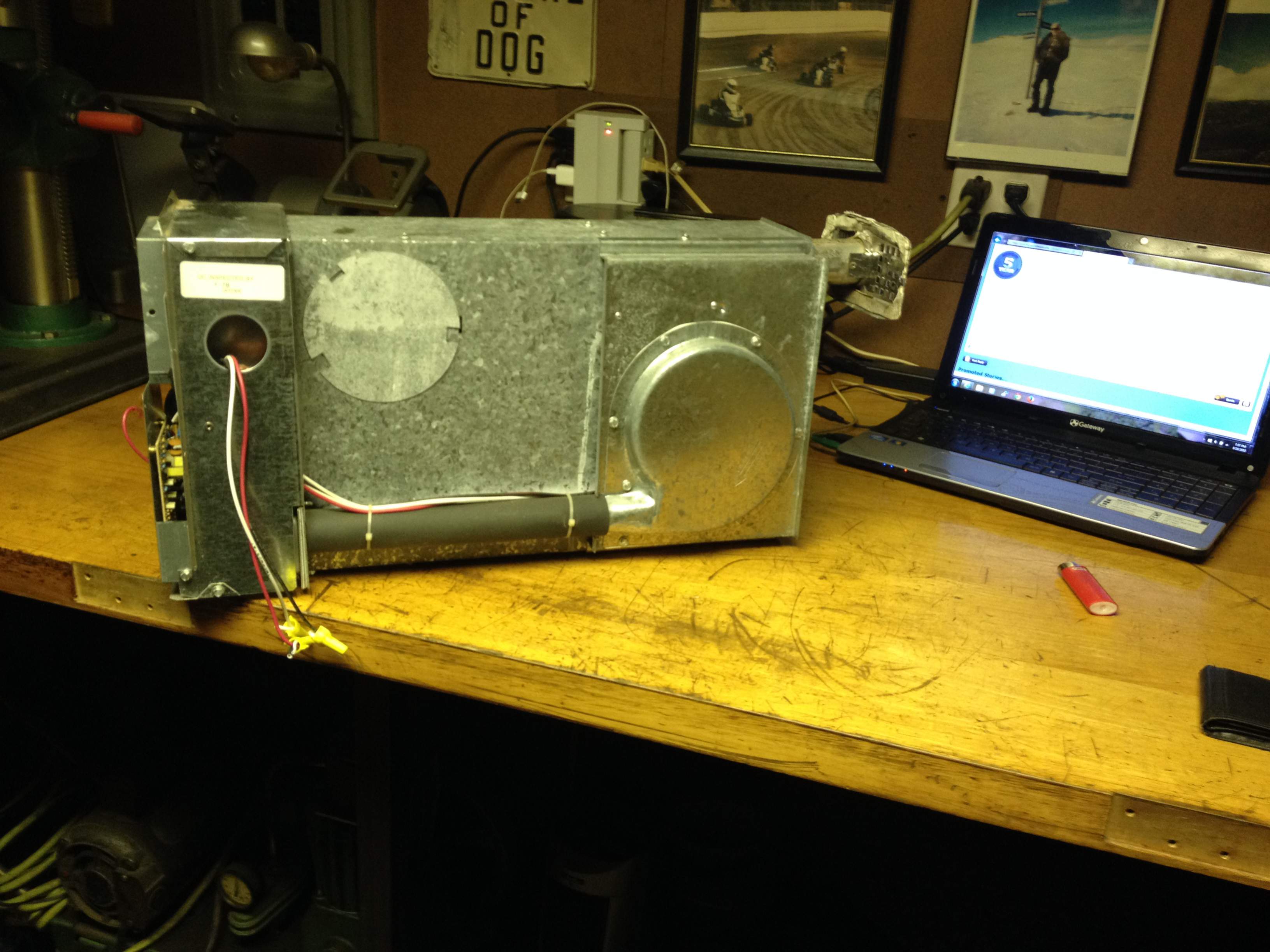

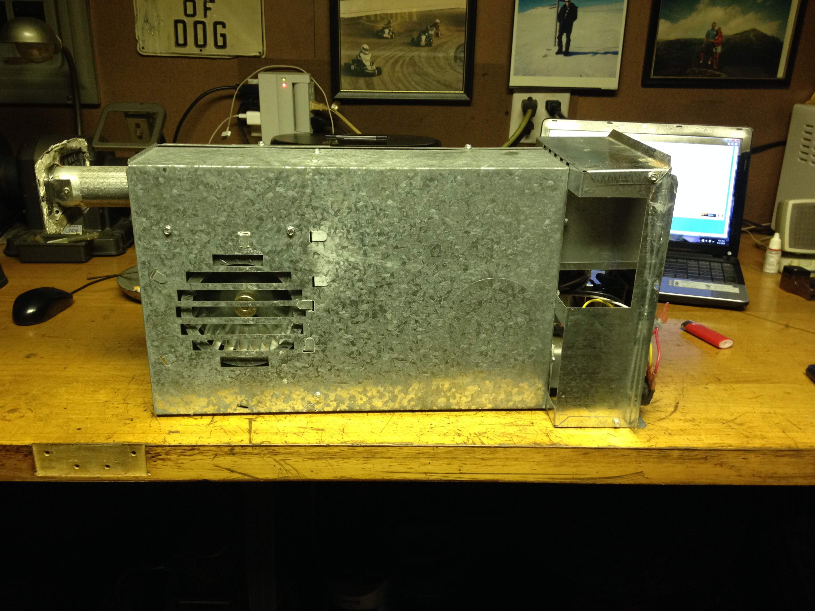

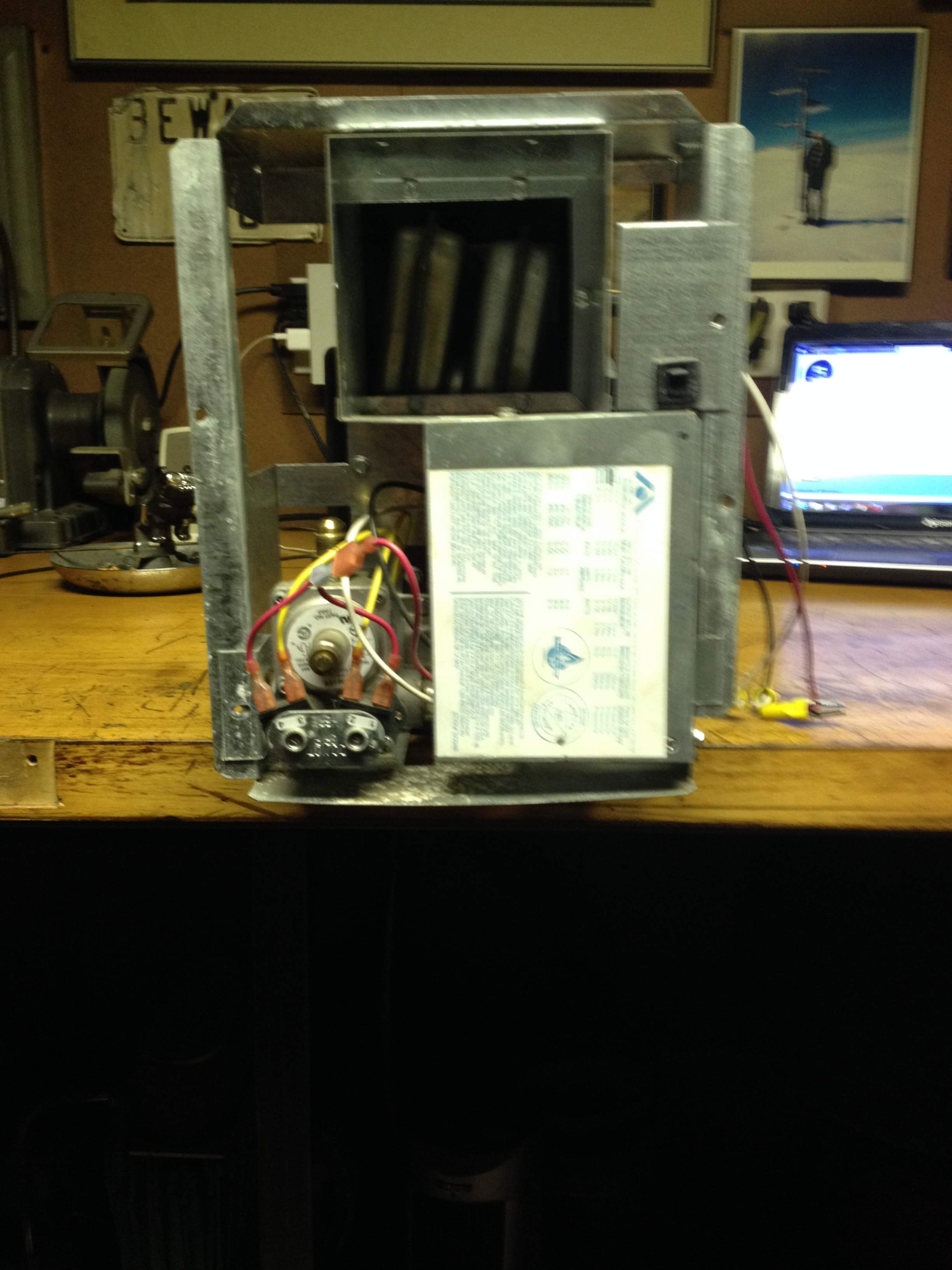

Took a ride today and picked up the furnace, an Atwood 7916-II rated at 12K BTU's output, very little use and in excellent condition. I located the parts breakdown for this series of furnaces and have found that a smaller orifice is available that will reduce the output to 9K BTU's at the same manifold pressure and will be ordering that Monday. There is also a ducting kit available that converts the output from the 4 1/4" square outlet on the front of the unit to a 4" round side outlet and am considering that as well. It appears that the unit is dependent on drawing the intake air from the face down the length of the body to the squirrel cage fan to keep the unit cooled so I will build the enclosure accordingly. Overall measurements are 22" long, 10" wide and 12" tall so the it will make for a compact and tidy unit on the back of the cab. Thanks for the input and interest, Rick

I'm not familiar with that heater but it looks interesting. If there's some way to control the output (fan speed, fire level, etc) I'd test drive it in cold weather before swapping to a smaller orfice.
The heater I have is rated at 20,000 BTU's and there have been a few days that I was glad to have that output. I can vary the heat output via the fan at OFF/LO/HI speeds and by regulating the valves for water flow.
