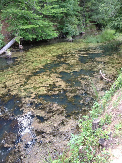

Attached pictures are before grass carp (2007) and after grass carp (2017) I am sure there were other contributing factors to the huge algae bloom we had but after adding the grass carp we have never even come close to the mess we had prior.

I have a pond about your size. Longer but narrower. I bit the bullet and had it dredged to 8 to 10 feet deep. If you have good access for a trackhoe, an excavator can do it very quickly.
Grass carp will clean out a pond but are not necessarily recommended for a healthy pond. Generally "hybrid" or "sterile" fish are not 100% sterile and will eventually overpopulate. Aeration is better. Don't worry about the distance. Just bury PEX from the power/pump location. I run my small aerator 50% of the time on a timer and have no algae.
