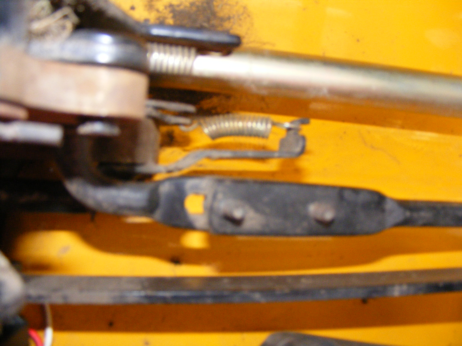

FIXED IT!
There are two adjusters for this. One that everyone seems to know about which is where the pedals are (This is mainly for reverse adjustment not forward adjustment). There is a second adjuster under the mower for the forward pedal. Mine had slipped all the way to the lowest setting. You want it about half way otherwise when you press the break pedal it will kick in your forward control if you adjust the adjuster to far the other way.
I am getting about 8 mph forward out of her now and about 2 to 3 mph in reverse.
I will post a photo of the adjuster sometime in the next day or two. From what I have read on here this seems to be a common issue that no one has found an answer to. Some have made way to extend the pedal, but there is no need to do that with this adjuster.

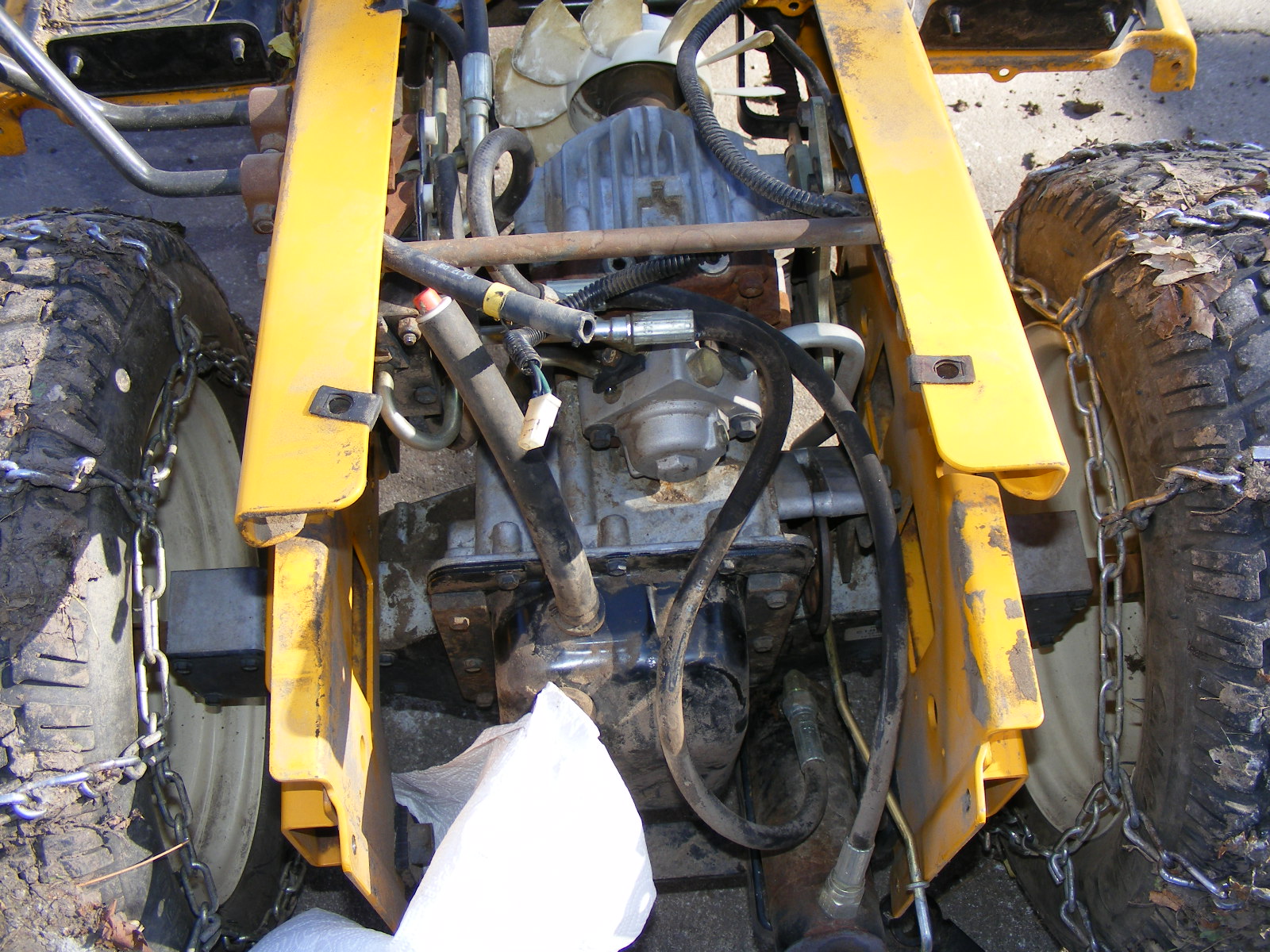

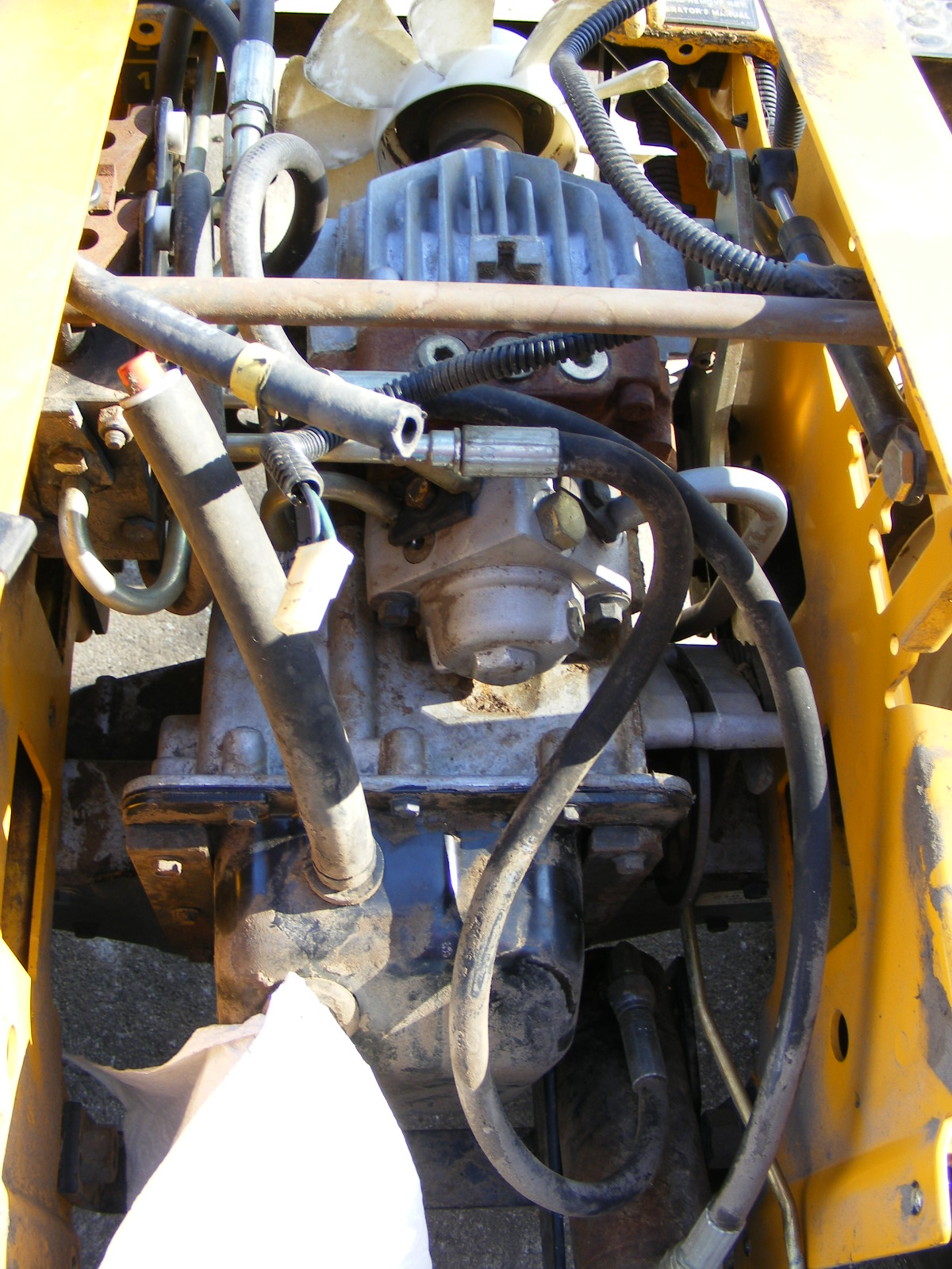

Attached are photo's of the forward adjuster as well as my Cub with the gas tank and rear end plate removed. I was trying to find any hydro leak that I could and I don't see a leak anywhere on this thing. It has to be a charge pump going out.

Just for giggles try this- find the hydro-releaase mechanism and make sure it isn't partially stuck open.. This would dump your hydro pressure and cause your low pump output.. Another thing to try is to block up the thing and run it elevated for a while to try and bleed any air out of the pump.. Good Luck..

I finally gave up on this hydraulic noise issue. It is getting worse now and I still cannot find it. I took it into the dealer today to see if they knew what it was. He thought I was getting air in the lines somewhere. They said they have never seen a charge pump make this kind of noise, and when they do have problems they just go out and nothing works. I told him good luck finding a air leak I have spent many hours with the fenders off looking and had no luck. So we will see what they come up with.

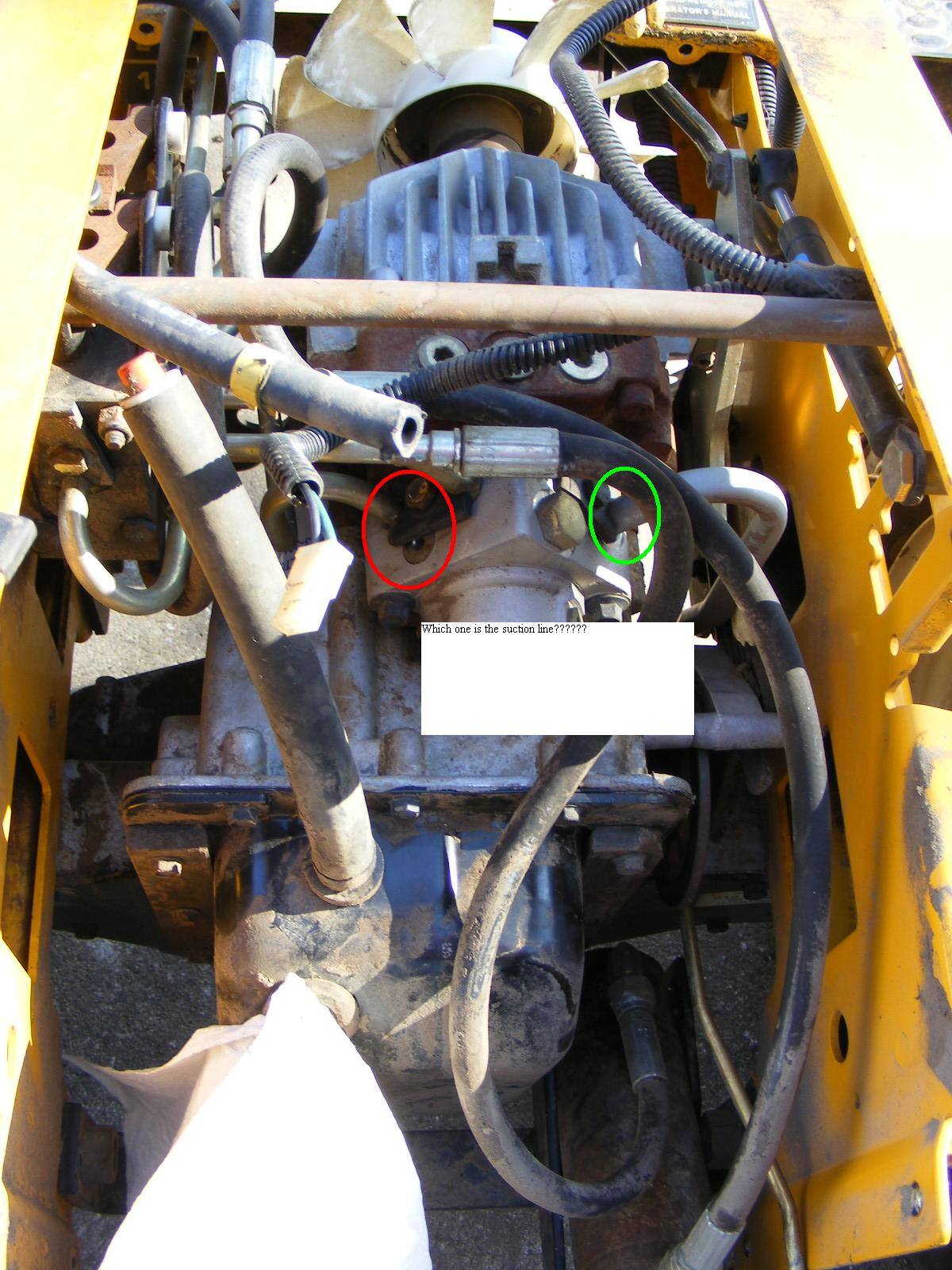

Ok since my cub dealer cannot get this fixed I need your guy's help. The leak is in the suction side somewhere. When looking at the charge pump from the back which line is the suction line. The one on the right that goes down to the bottom of the transmission, or the one on the left that goes up front?
If you look at the attached photo is it the red or green circle?
Also where all could the leak on the suction side be coming from. The Cub dealer replaced the "O" ring on the charge pump and the one on the transmission.

I tried using a bottle of Lucas hydro sealer in the rear end and of course that did not work it only made my hydro's slower. My next step I am going to do it is drain the entire rear end and put in synthetic shell rotella 5-40W to see if that helps. If that does not work I am going to replace all the O rings on the power steering pump.
