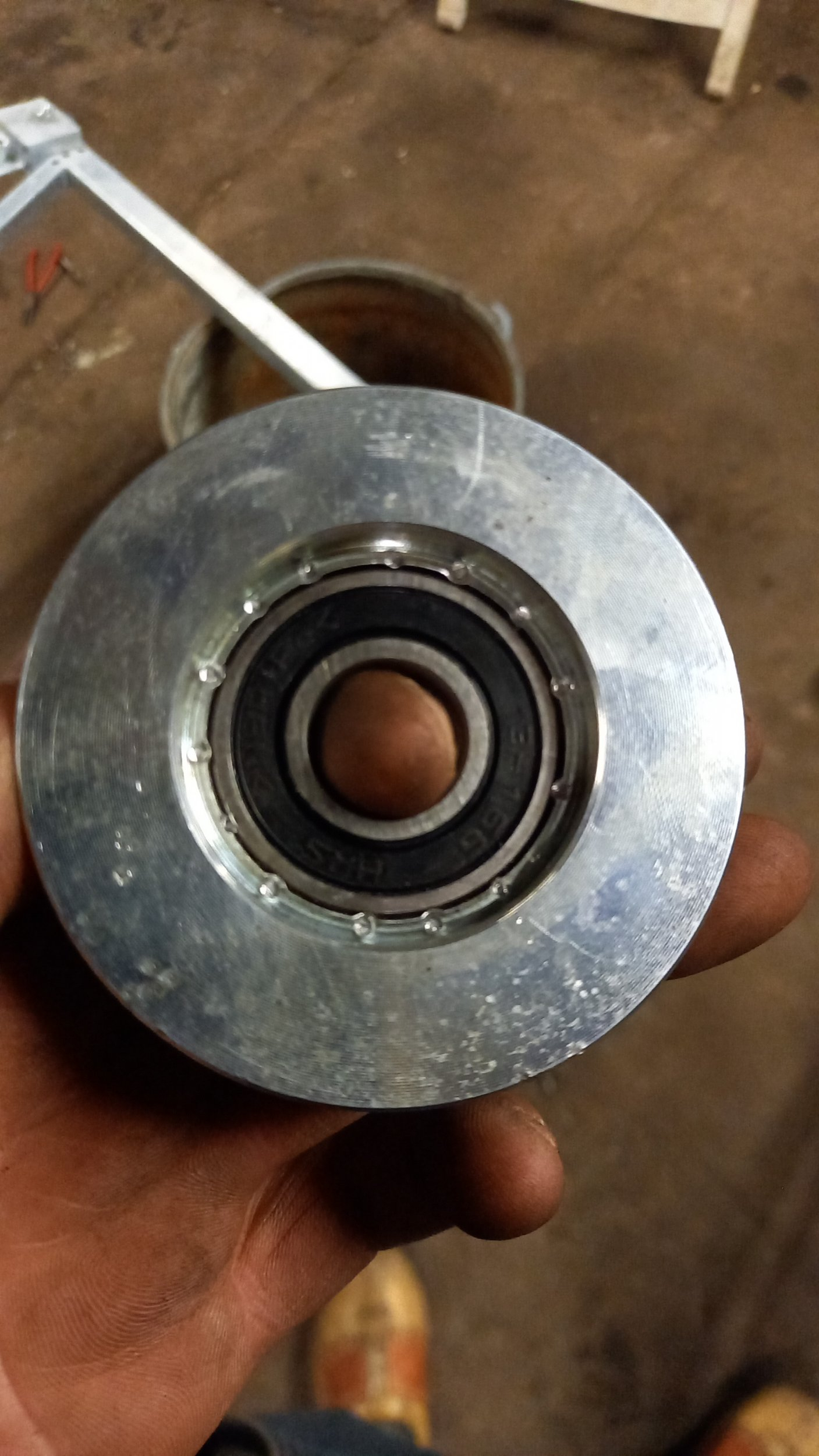

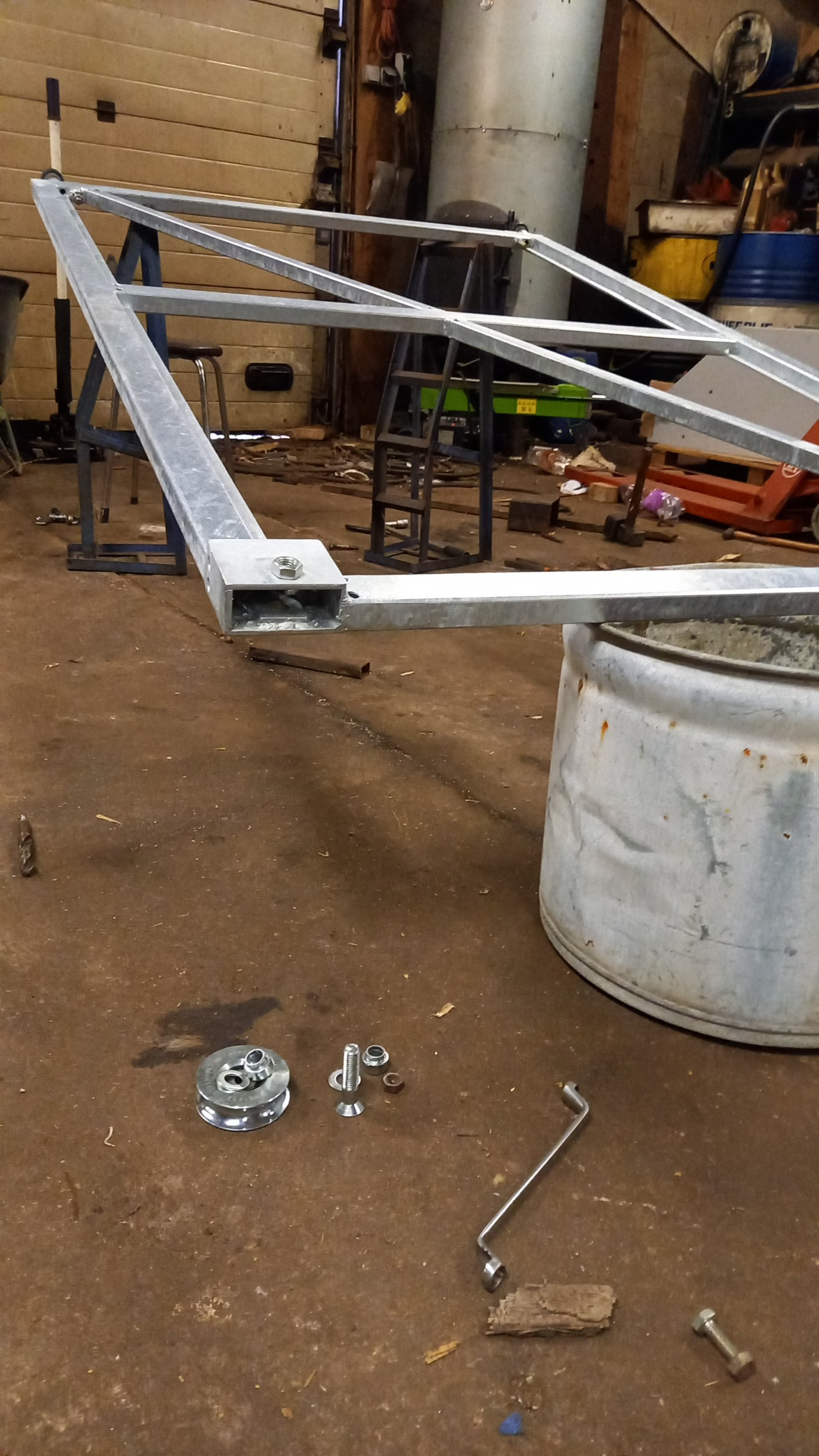

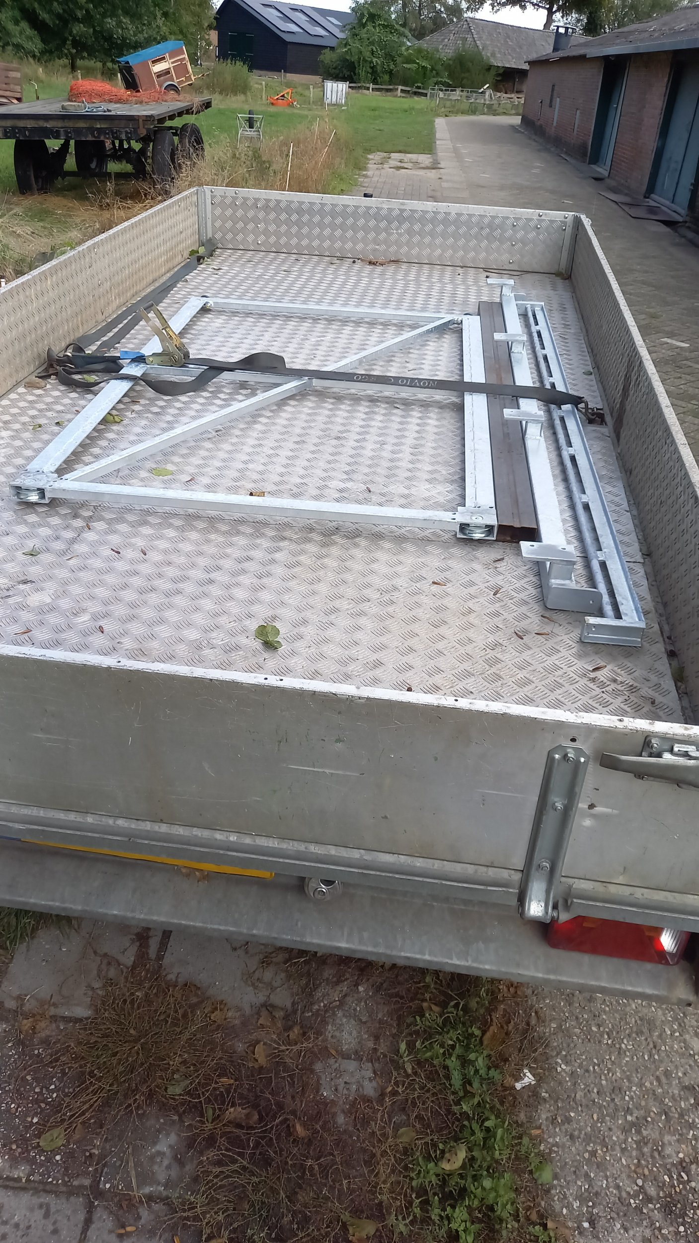

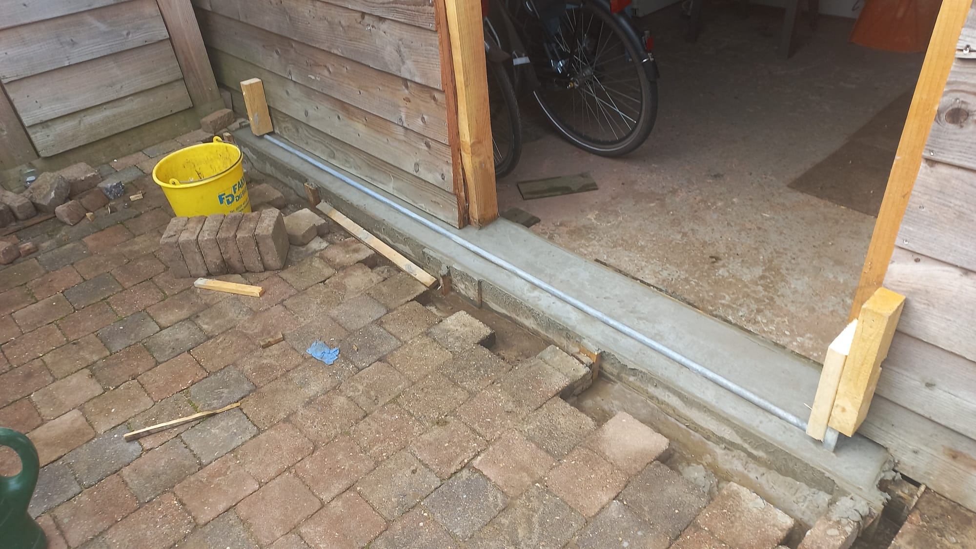

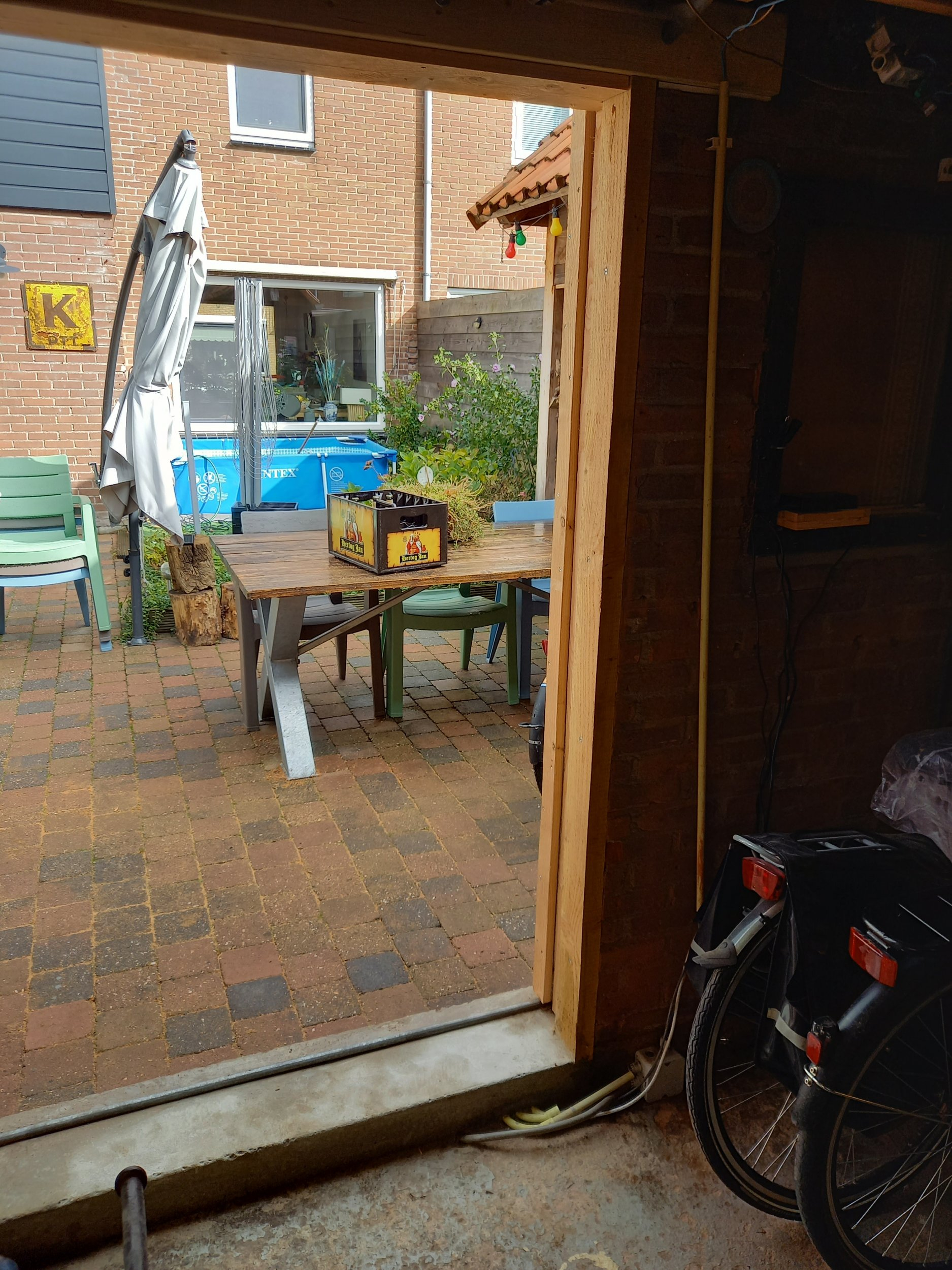

This is the barn door i made for my friends bike shed. He has lost control of his right hand due to a car accident in his youth, and the bike with electric pedal support is a bit too heavy to lift around the corner of a 1960s 80cm (31.5") door...
A rail of 20mm rod cast in concrete, and two rubber clad guide rollers on the top. Two threaded rods driven out to the point where their tops are 2mm from the upper rail, so no thug can lift the door off the lower rollers, and pull it out from underneath to steal his electric bike or tools. All galvanised and on sealed roller bearings, so it will last him a lifetime.

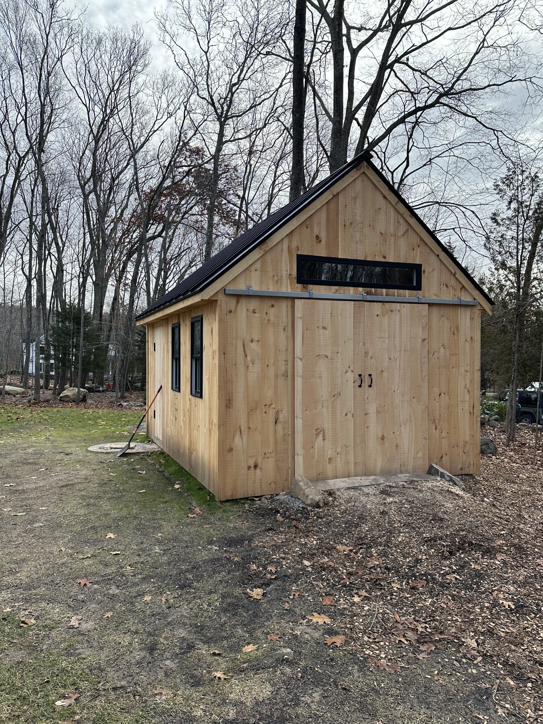

I really appreciate all the thoughtful comments on my questions. I've made notes and will incorporate some of the suggestions. Thanks
i just saw this thread and wanted to know what you did to lock the sliders in place. I have built a shed with a slider that goes below the floor level, and is held in place by a reclaimed granite curb stone that is 2” off the sill. I used cheek stones to support the ramp up to floor level.
