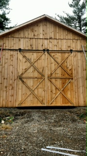

Each door is 5' wide, door opening is just under 10', hangers are around 6" in from side of doors. The hardest part is trying to weather strip them, but that's only needed in colder climates.

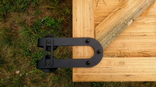

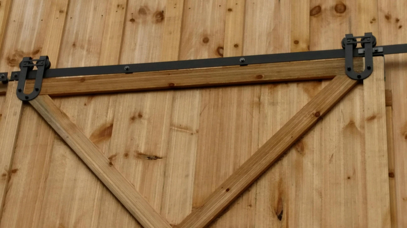

Near the end worked for me. image-1018924966.jpg image-3357898098.jpg image-2745908688.jpg
The doors are 6 foot each. I believe I put the outside edge of the hanger about 4 inches from the edge of the door.

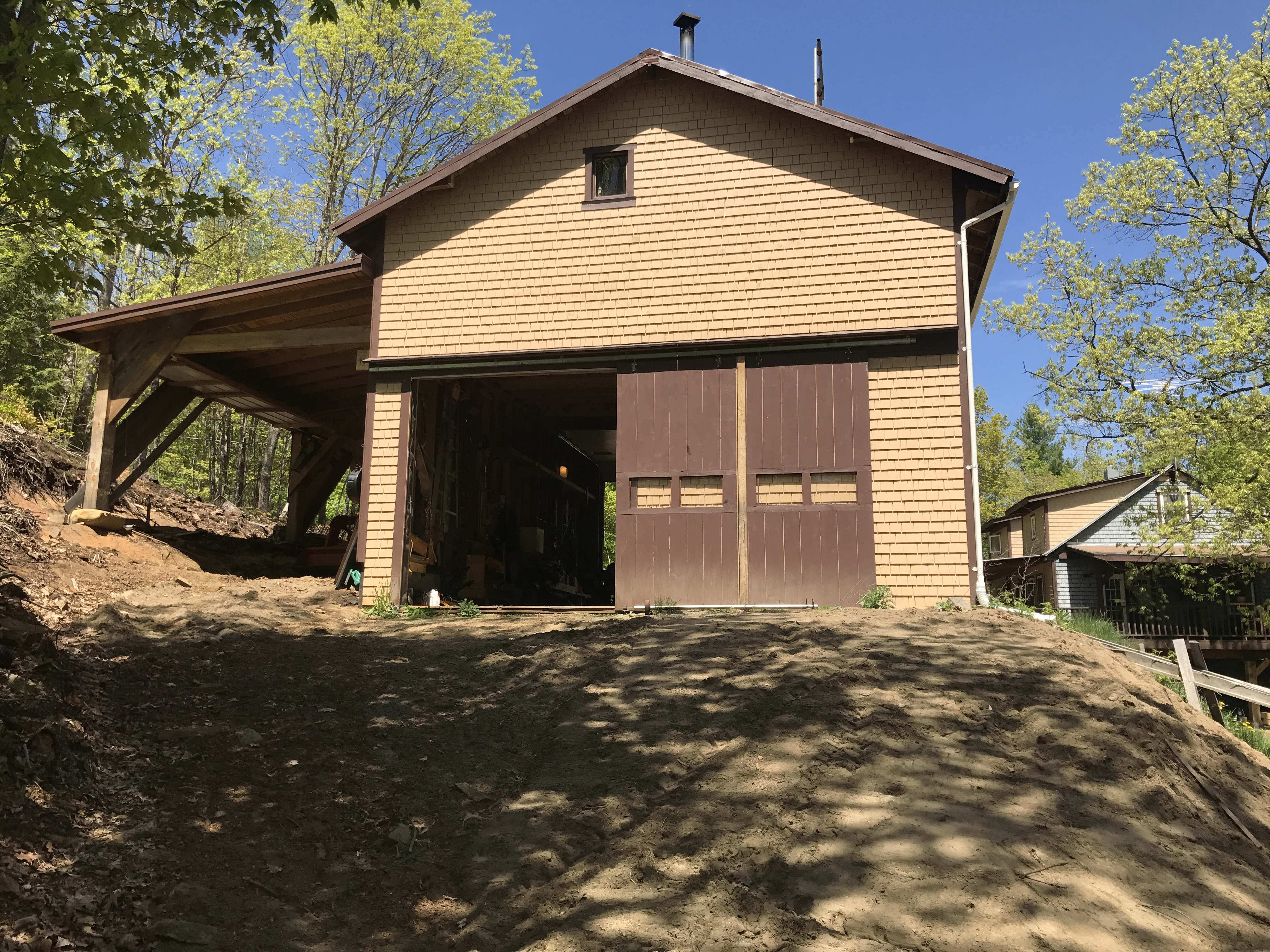

That's just the frame in my pic -- aluminum tube on the sides and 2x4 fir across. Here's the finished doors with pine siding and stain:
I used spikes on the bottom as pins, as well as latches on the sides, to keep the doors put when closed:
