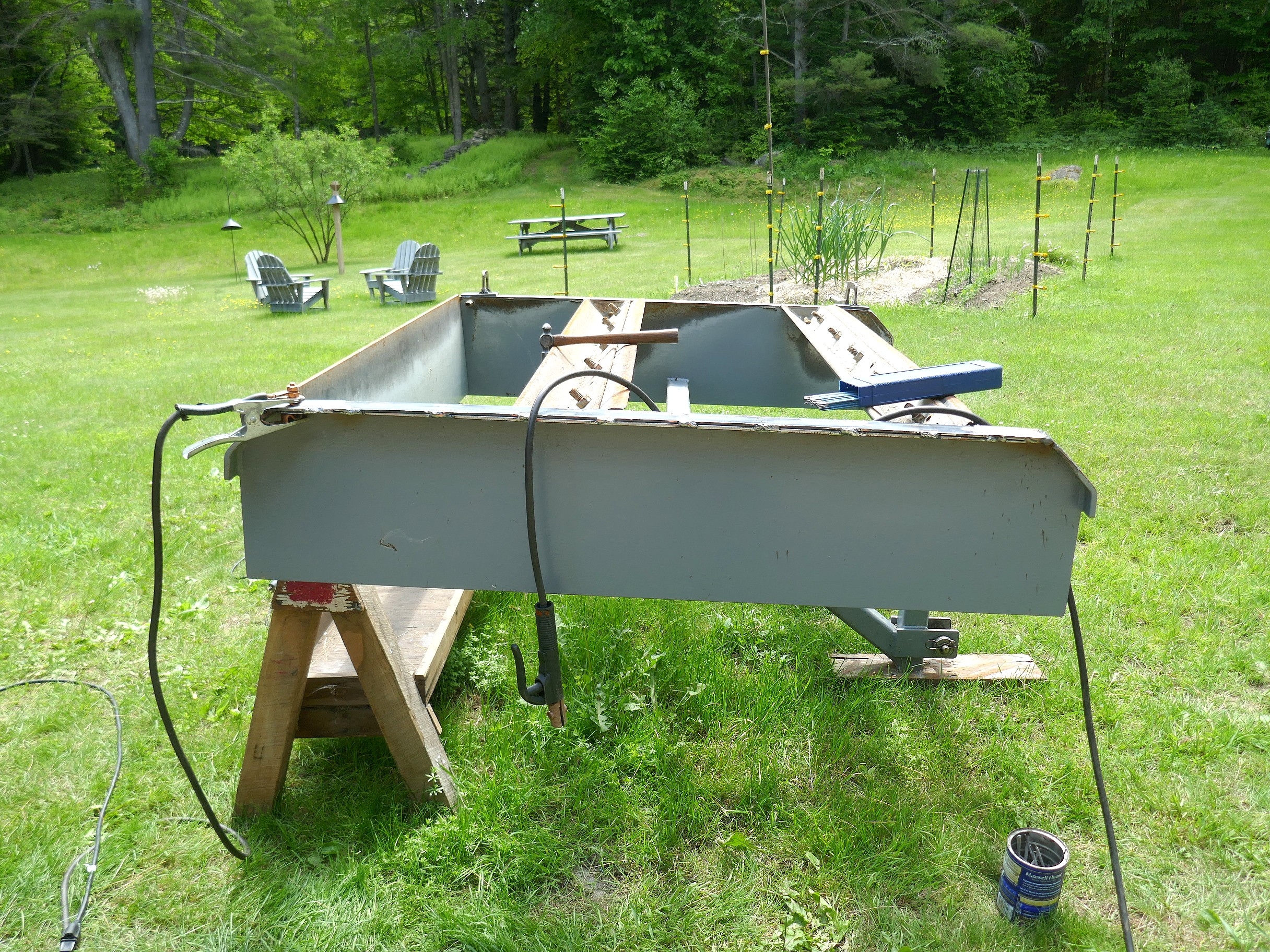

I built this LandPlane in 2010. The 3/8" skids were about half worn except the back ends which were paper thin. For finishing passes I often raise the front a little putting all the weight on the back. Not too pretty but I scabbed on another layer, a little thicker on the ends, to give it some more life.

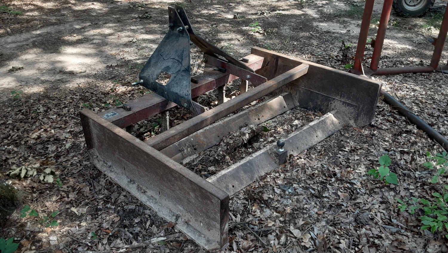

Replacing, or reversing the skid plates on my land plane was a pretty regular occurance.

Nice work but now hard face that skid in a Z pattern full length and never replace it again (y)

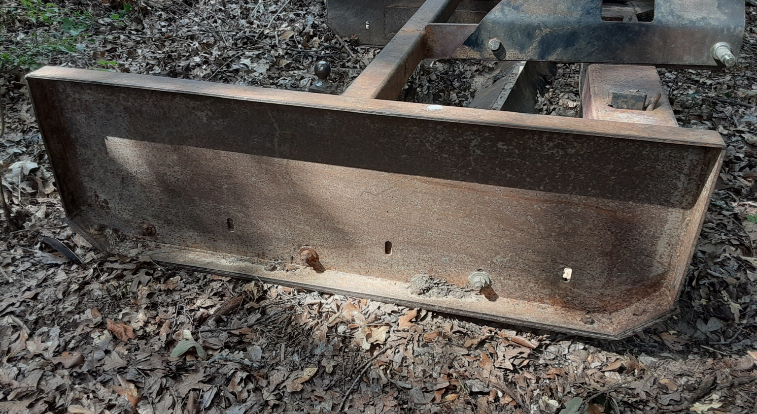

I made mine with 1/4" and then bolted a 3/8 one to it.
View attachment 3659054View attachment 3659055
Idea being I just bolt another piece of 3/8 X 2" to the 1/4" as needed.
So, could you bolt a piece of 1/2" or 3/4" to it instead? Seems like it would prolong intervals between having to work on it? It would also allow a significant time before the wear got to the bolt heads which I assume are countersinked into the 3/8? (or did you drill and tap the 3/8" flatbar to allow for a longer wear?)
Anyway, nice job in building it.
Is there a reason you didn't angle the blades? While it doesn't do much, angling the blades allows you to crown the roadway while making a pass.

I would just weld something on right in the place of the most wear and possibly a few other spots. Once the welded area is worn down you just cut the rest of it off.
That's probably a good idea for the learning experience alone as I have never tried it.
gg
I hadn't either until recently. I bought some hardening wire and drew out a pattern with a soap stone. And Zig Zagged away and it came out pretty good if I don't say. GL with it (y)
/ Skids Worn on LandPlane #10
Sure, if I ever have to replace that one it might be thicker but won't be a deal breaker as it has been years since I made the original there.
