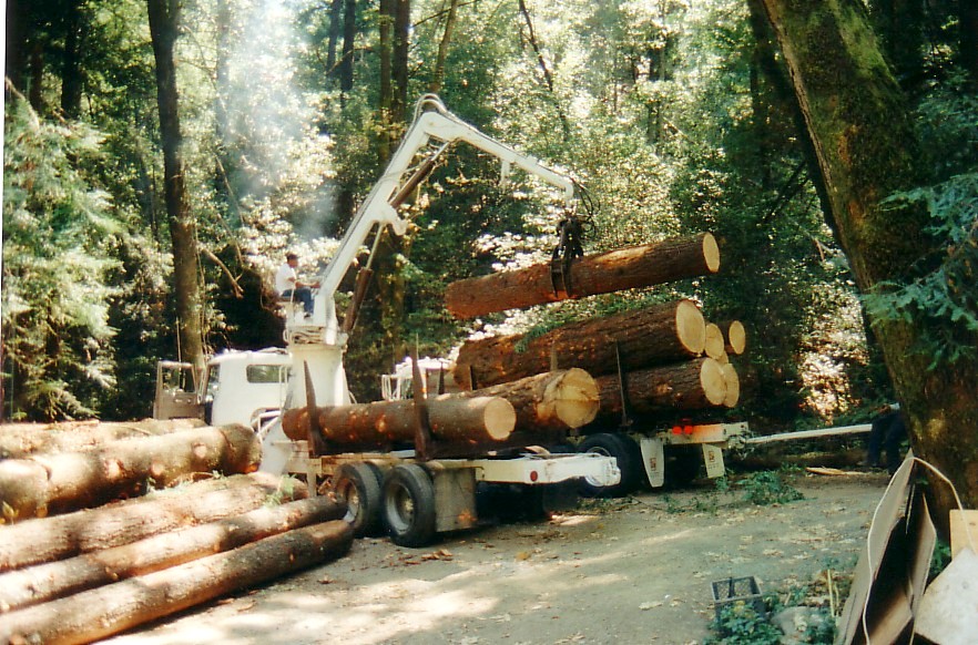

You guys have no idea how tough it was to find a logger who would take
my 18 DF trees back in the 90s. It takes some very specialized equipment
to skid and load these logs....each one weighs as much or more than
a F250 PU truck. You should have seen the skidder....THAT was impressive.
It was an articulated 4WD machine that had a giant cable winch on it. I
had to go begging just to get an company to take the logs...for FREE.
After I paid for the Forester and Timber Harvest Permit.
Here is a scan of the loader and the trucks they used. I think there was
6-8 full trucks hauled out.

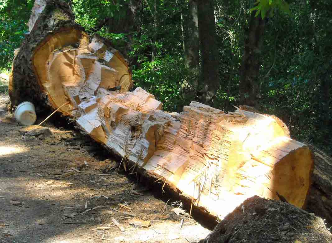

The big DF tree in this thread is now gone. It was removed the hard
way by a neighbor who cut/split it for firewood. Since he only has a small
chainsaw, he cut as deep as he could, then split off chunks with
hammer and wedge. It took about 6 months.
