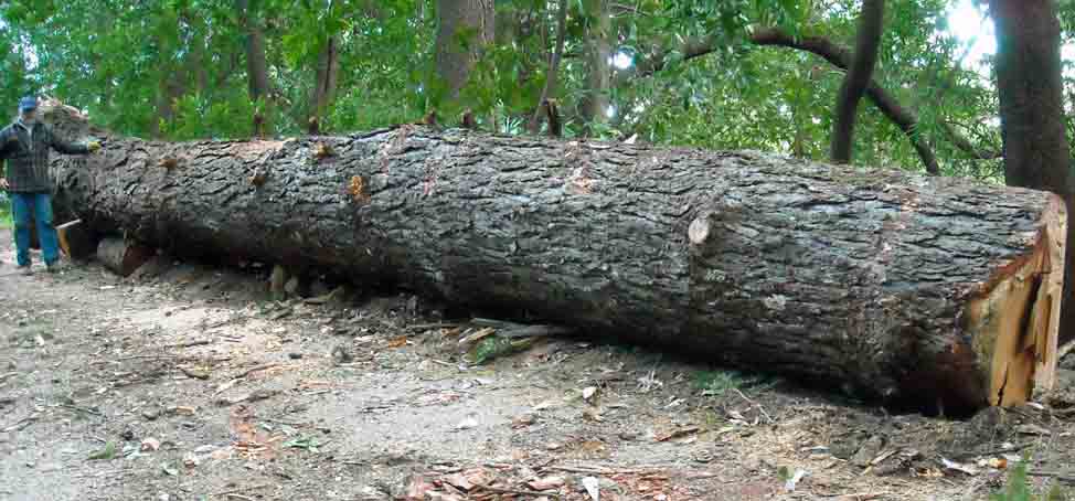

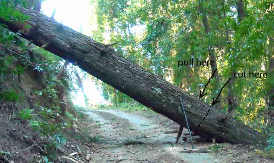

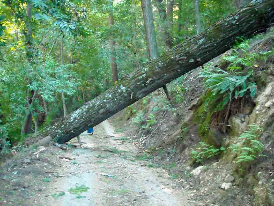

This douglas fir tree fell last Sunday, due to wind, and a weakened root
system. It was lying across my private road, very close to my neighbor's
house. The tree was 41" in diameter at chest height, and about 110 feet
long. The slope is about 90%, and our county road is downhill, about
100 feet away.
So, how do I get this big tree out of there? The second photo shows my
approach. I will cut thru the log very close to where it touches the
ground, then use my tractor and logging cable to pull on the log at the
cut.
Why not cut sections off from above, near the root ball? First, the biggest
saw available has a 24" bar, which can not get thru anything bigger than
a little less than 48". Second, cutting sections of the log on a 90% slope
(even if I could) could allow these sections to roll downhill, towards the
county road below. Since each section cut would be pressing on each
subsequent section, I would need to pull them off to relieve pressure.
Dangerous.
It turns out, the pressure of the log trying to slide downhill was very strong.
Once it was cut thru, the pressure was so great that I could not move
the tree, pulling with my 5500# tractor and logging cable. Traction on my
road was excellent.

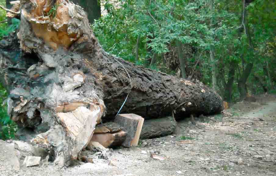

So the next thing I did was cut a foot-long section out. I was hoping to
relieve some of the pressure here, or be able to pull out the section with
the tractor, or with my 20T jack. The diameter is 30" at the cut.

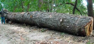

At last, a section was removed, and I was able to pull the log end about
15 feet along the road. I could not pull any further because the end of
the log was digging into the road, and was just too heavy. It is
43' long, and about 9 tons, according to my calculation.
Finally, I attached my cable to the root ball end and, using a snatch block
to redirect the forces, pulled it off the hillside.
This is the biggest log I have ever moved!
