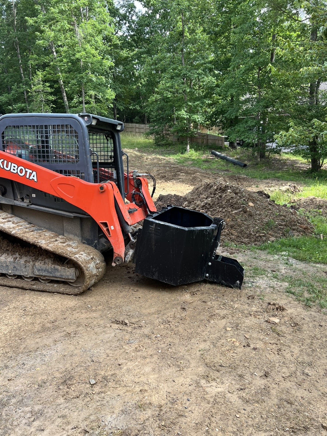

Your skidsteer's hydraulics can lift 3600 lbs, but it will tip on level ground. If your on uneven ground or try to turn it will tip with less. .
If you’re comparing a wheeled machine thats largely correct but a larger track machine will make easy work of lifting and carrying 3600 pounds without tipping. My SVL 90 will drive on steeper slopes than you really want to or else the load falls off the forks without tipping. I poured a 6 yard pad the other day with my concrete bucket that holds 3/4 yard with zero tipping. That 90 won’t straight up lift a lot more than my dad’s 75 will. Honestly I probably need to have the relief pressure checked but it’s way more stable than the 75 is at max load.
