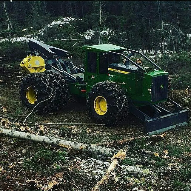

G'mornin.
I get asked when I will buy a skidder, usually by skidder folk. I say never and that I don't need one cuz of my tractor w/FEL and they look confused. Or wounded?
While I realize that seeing the cutting edge would be a huge advantage, I feel that a tractor is far better for rural living.
Your opinions??
Skidder
Skid Steer
Which one are we talking about?

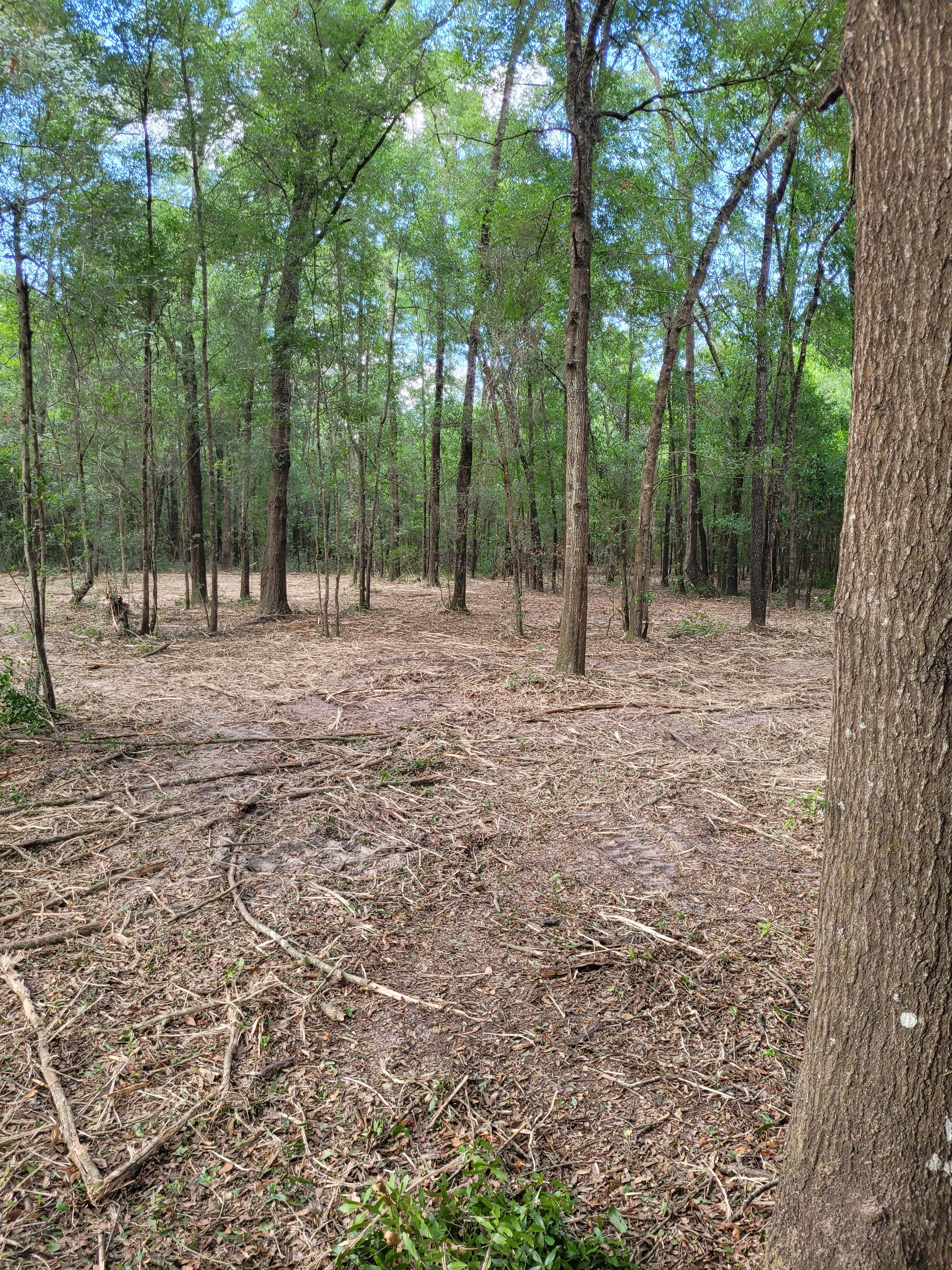

   / Skidder or Tractor? If you could only have one. #67
I do one kind of work with my tractors and another with my skid steer, they both have their place and are as a whole polar opposite.The places I put this skid steer I would never put my tractors.

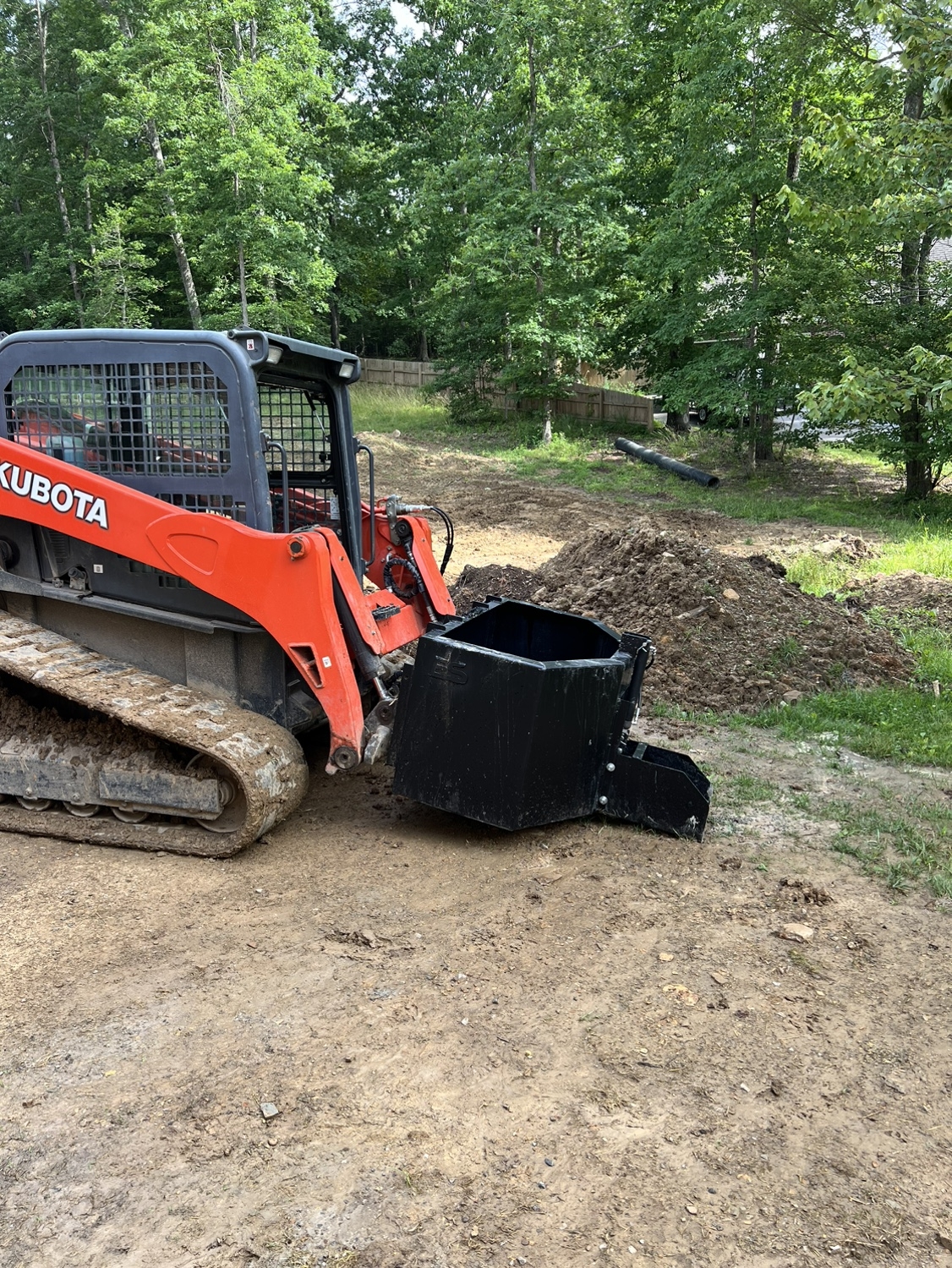

   / Skidder or Tractor? If you could only have one. #71
Your skidsteer's hydraulics can lift 3600 lbs, but it will tip on level ground. If your on uneven ground or try to turn it will tip with less. .
If you’re comparing a wheeled machine thats largely correct but a larger track machine will make easy work of lifting and carrying 3600 pounds without tipping. My SVL 90 will drive on steeper slopes than you really want to or else the load falls off the forks without tipping. I poured a 6 yard pad the other day with my concrete bucket that holds 3/4 yard with zero tipping. That 90 won’t straight up lift a lot more than my dad’s 75 will. Honestly I probably need to have the relief pressure checked but it’s way more stable than the 75 is at max load.
