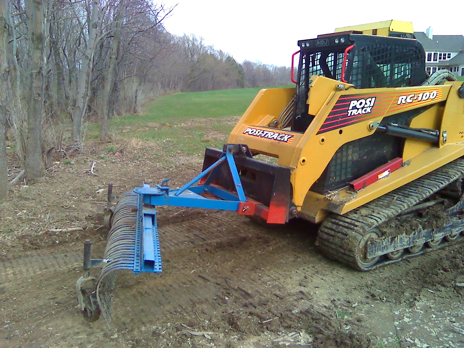

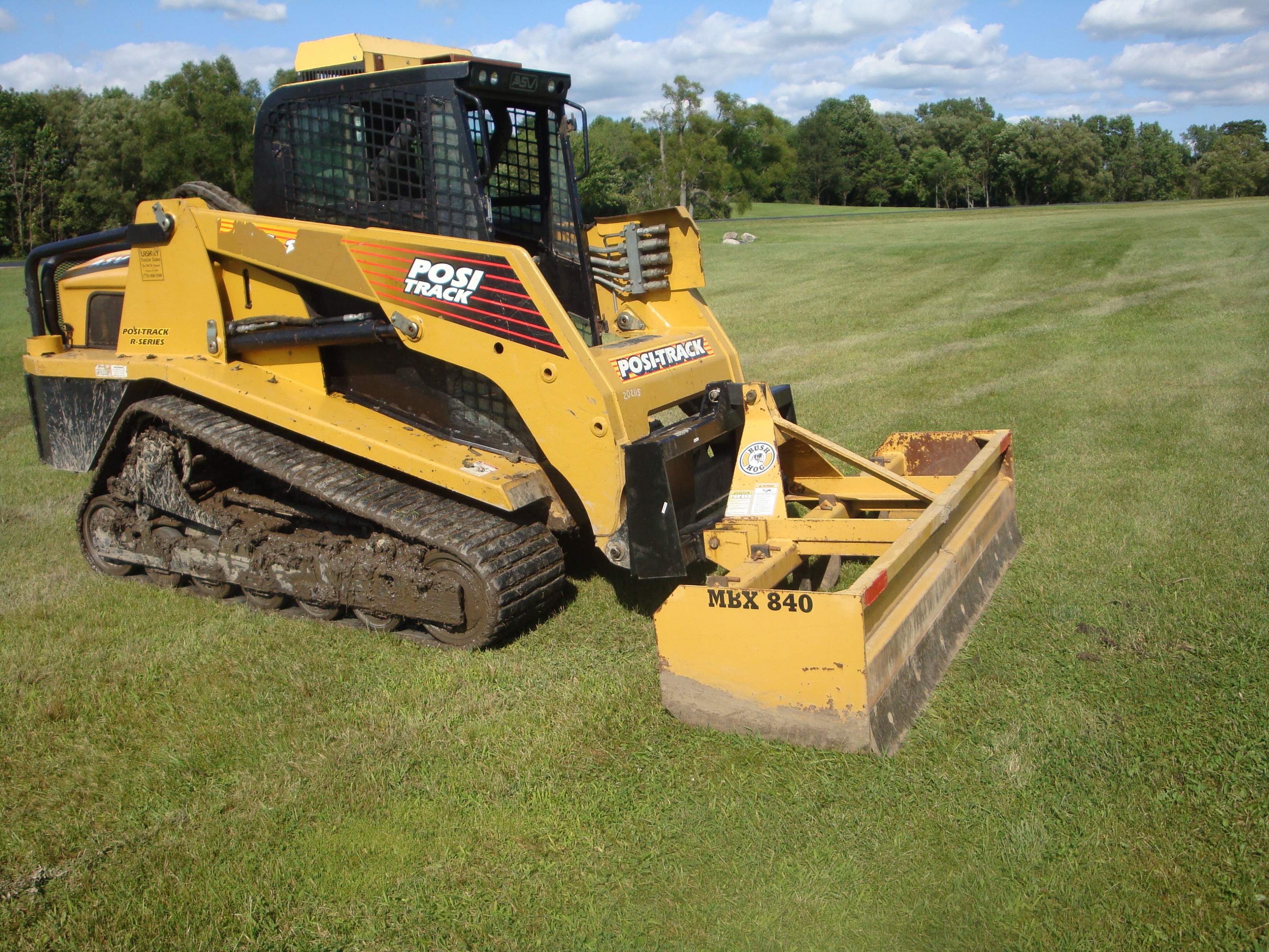

I use a plate to 3 point adapter. Worked great for the rake until I snapped off the rake at the weld pivot point. The carriage arms of a skidsteer are very heavy with downward pressure causing too much stress on the tube welds, even when 'floating' the hydraulics. I welded a steel channel to the rake because it was starting to twist. Box scraper also works good with the adapter. The tracks on the skidsteer keep it level over ruts compared to tractor tires, making a quicker level surface. Tracks allow me to work on damp, soft areas when the tractor would sink. Using the scraper in a forward direction makes a great plow for leveling surfaces. I can also use this setup on my tractor FEL which has quick disconnects. Downside is operating in reverse and limited visibility.

Are you still using the rake as a front mount on your skid steer? Or have you given-up because of carnage to the rake?
I would still like to do a front mount and I think my Woods rake might be heavier-built than your rake (not trying to rip your rake, just stating that because I might be able to get away with a rake on my less powerful tractor opposed to a more powerful tracked skid steer like yours).
Would you guess a well built rake would survivie in front of my M7040 if I'm farily careful? Or maybe more accurately put-would your rake survive mounted to the front of your TN65? (similar size to my rig)
Thanks for the input and especially the pictures, they really help me envision what I want to do.
