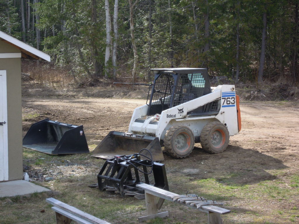

Congrats on the purchase. Course, no pictures, no purchase. :)
/ Skid Steer - Tracks or Wheels?
#44
Here's proof it's not a Unicorn skidsteer. :) It came with the std bucket and the snow bucket. The grapple is the one I made.

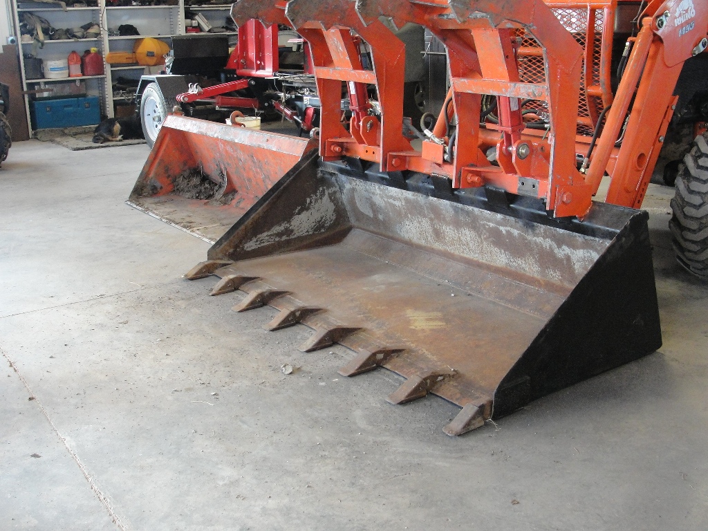

Look onto a good heavy tooth bar or a tooth bucket, you'll wonder why they even make smooth buckets.
Good looking Cat Hillbilly. Congrats.
Good advice. I bought a used 6' toothed LowPro Bobcat bucket to make my Grapple with. I paid $600 for it. I rarely use my Kubota smooth bucket.

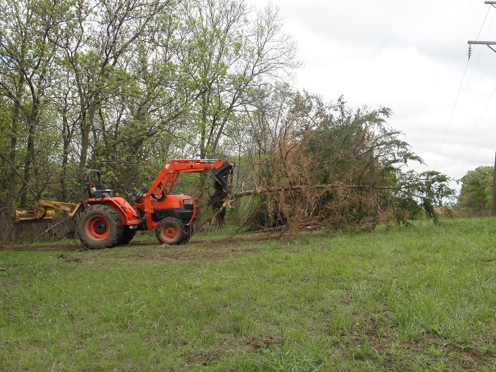

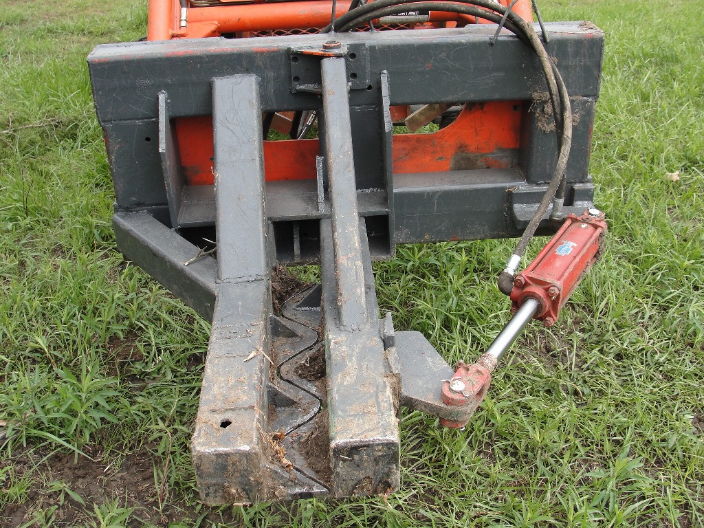

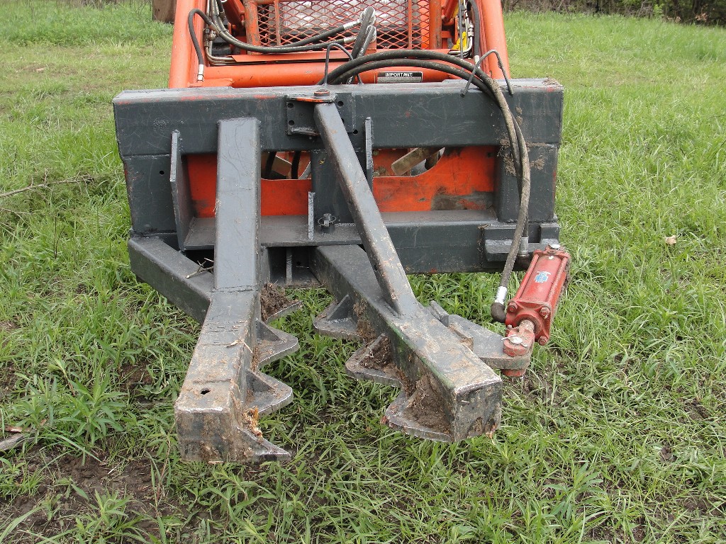

I don't know if you have brush/trees to deal with, but if you do, here's another build project. Very, very handy on a SS. You can see what you are doing so much better than on a tractor FEL.
