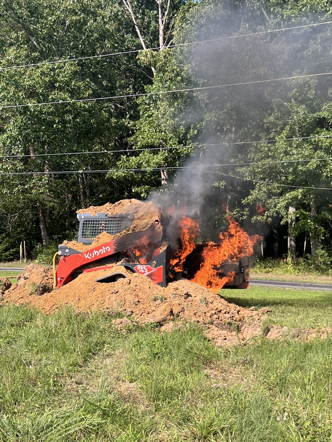

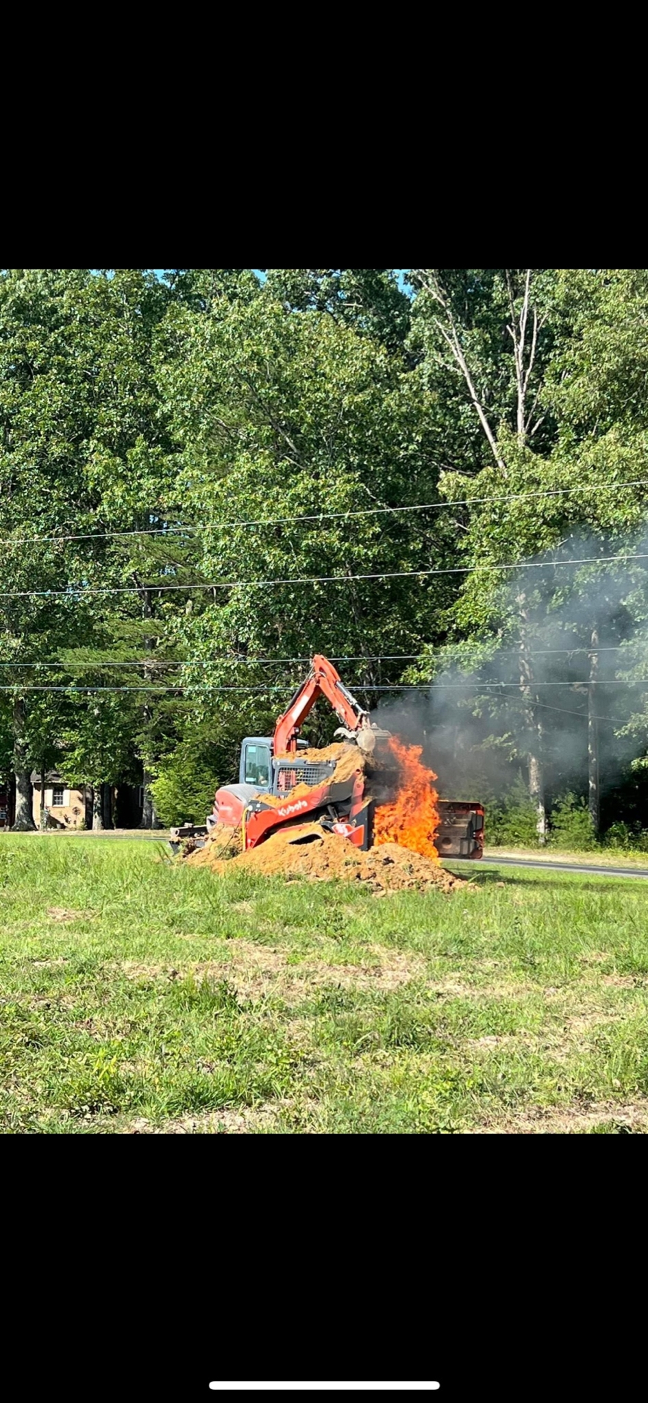

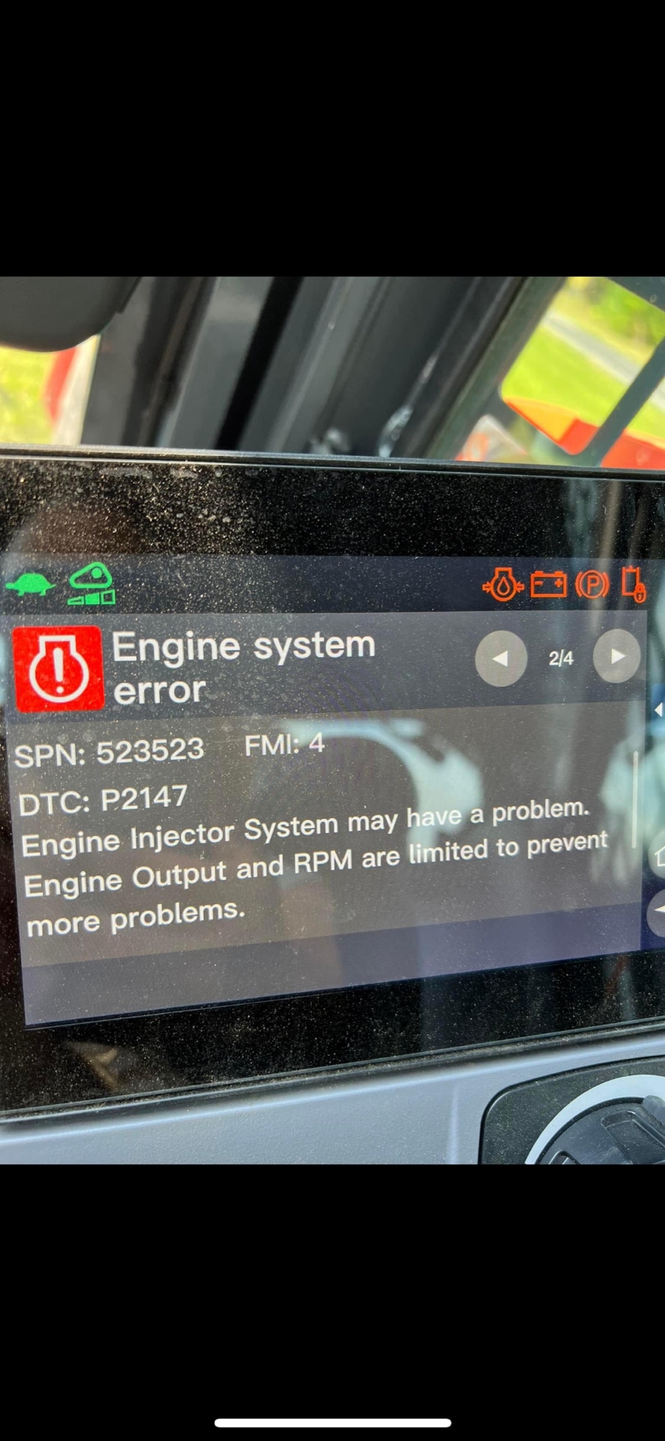

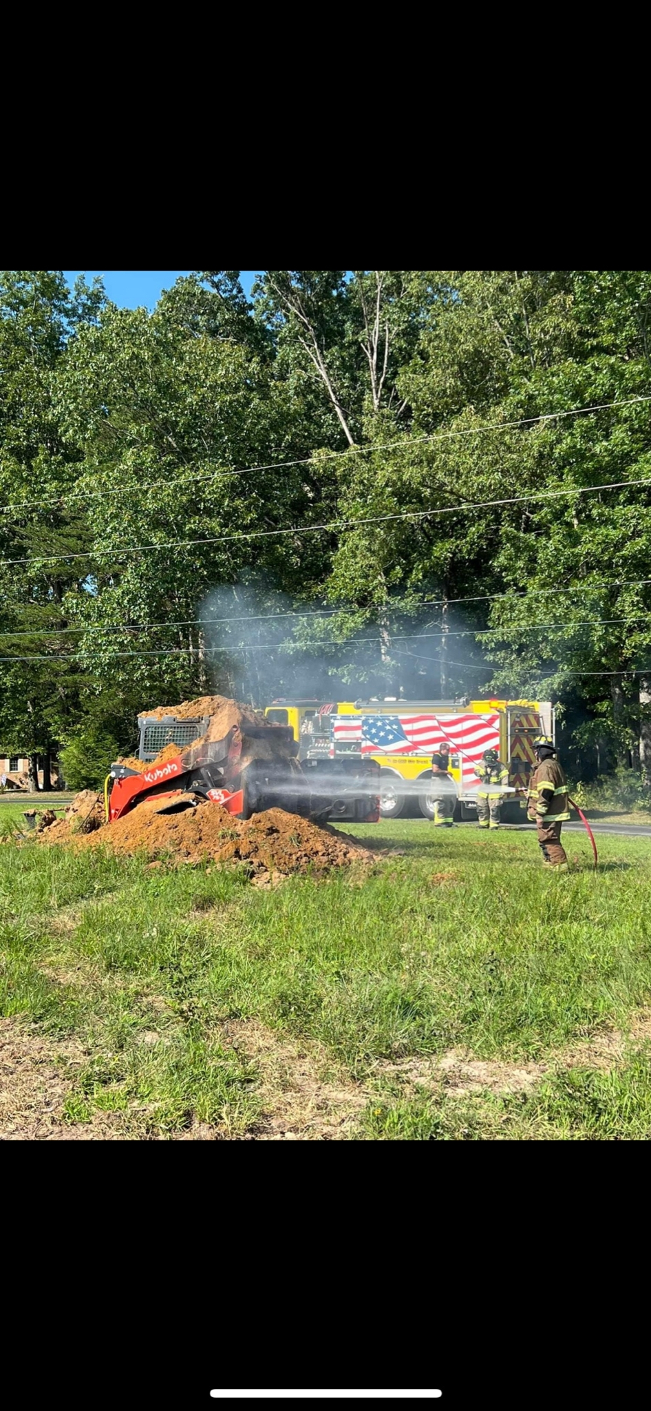

My 75-3 Kubota caught on fire today. The engine bay on this machine was completely clean. It’s never even been in the woods before. It flashed an error code about the injectors and a minute or so later and it was in flames. It had 55 hours on it. View attachment 884692View attachment 884693View attachment 884694View attachment 884695
I suspect there was a crack in a high pressure line to the Injectors and fuel flashed at the exhaust manifold. Sorry for your loss.
/ Skid steer fire. #52
Looks like there were four Error Code Messages. But that Exclamation Mark in RED might have meant 'SHUT ER DOWN FREDDY!
Was it running went it burst into flames? Or had you shut the engine off?

Scary stuff! Have you contacted your dealer? Kubota will employ a fire investigator and he/she will want to look at it (I know JD does). They may want to ship it to their facility as well. The dealer will contact the factory and get things rolling.
It shut itself down when it threw the error message and burst into flames shortly after.
