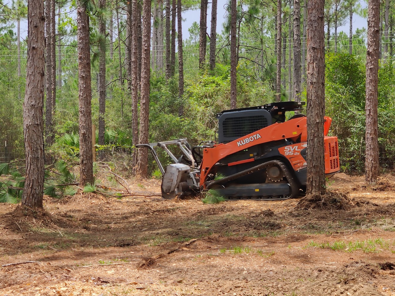

glad you're OK, it it's not extremely rare (not common either) for those Kubota skid steers to go up in flames. My forestry mulcher guy had the same happen, and told me of a few others who had the same issue. Like you, his was insured and it was quickly replaced. It's crazy to think it happens as often as it does, it's rare by the numbers, but happens more often than it should, and I only seem to hear about it with Kubota skid steers though I'm sure all are susceptible. Maybe it's a numbers/quantity thing.
This is the one that burned up similarly to yours.
Caterpillars and John Deere skids burn to the dirt at the same rate as the Kubota's but it usually is due to a machine that hasn't been kept clean and by that I mean dropping the belly pans , raising the cabs and removing all woody debris, sounds like that wasn't the case with 4570's but it seems to be on most, there is a guy on You tube that goes by the name The Tree Shop here in Florida who posted a video on YT this morning of his Cat 299 burning to the dirt this past week.
