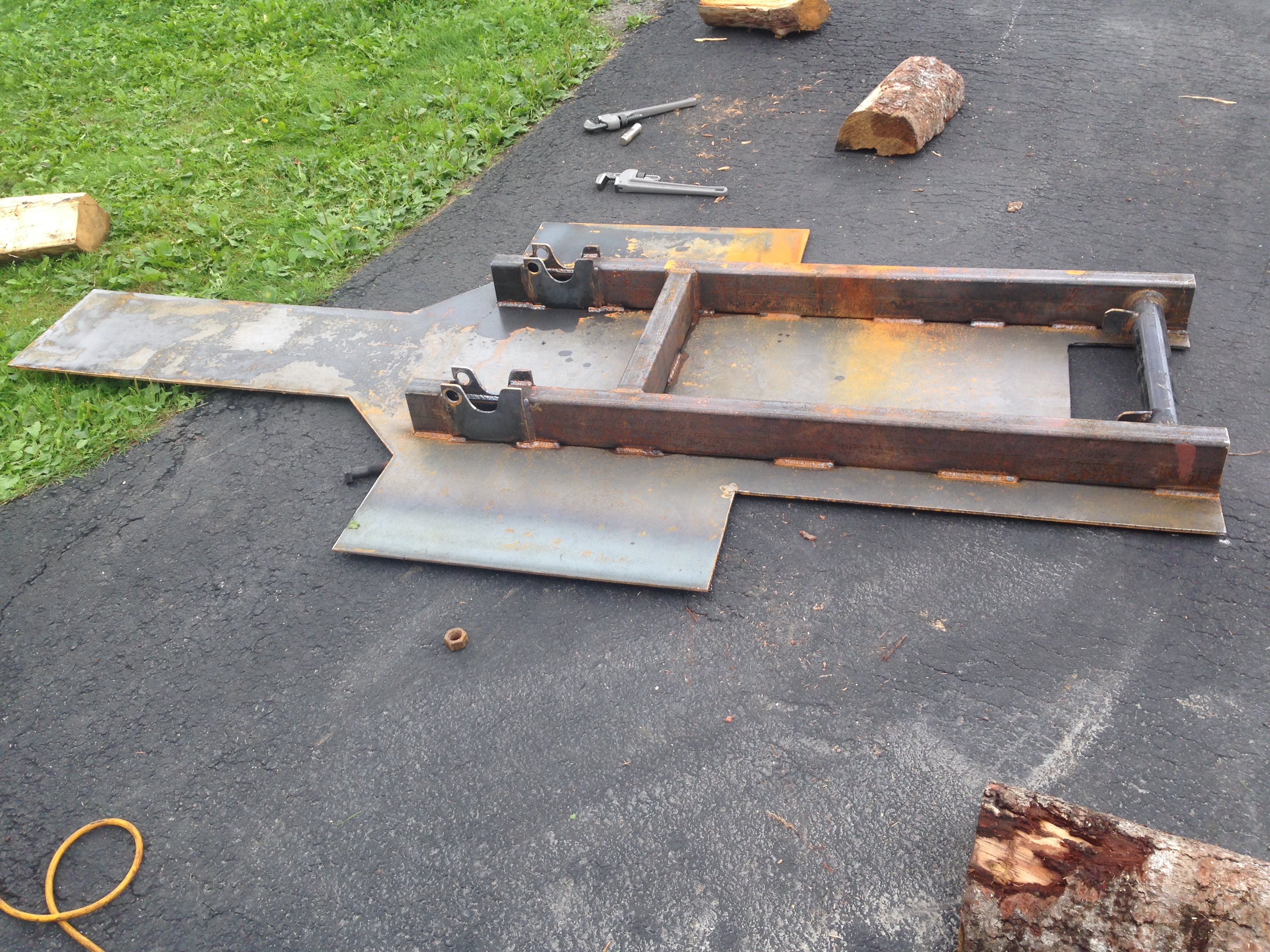

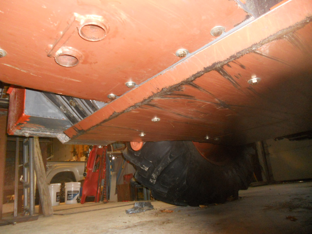

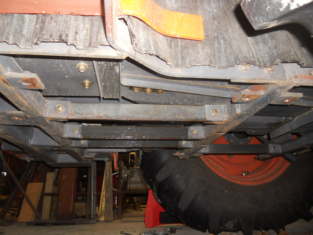

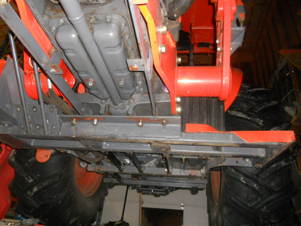

It's been a while since I've looked at that post, not real descriptive or helpful. I need to drop the plate and clean out the junk that accumulates in there and try to do a little better explanation along with some more pics if you like. I really only had 3 places to locate a "crossmember" and used 3/8" X 2" bars running parallel with the tractor in between these 3 x-members.
Did an oil change today and dropped all 3 pans to clean them out. You can see the framework that supports the 1/4" "pan" along with the scars from some nasty rocks.
