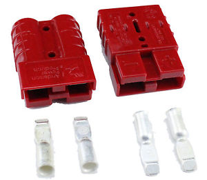

read the full load amp rateing on the unit...or just buy some 400 amp plugs....:)
/ sizing winch plug #3
I agree to get the higher rated Anderson plugs (340 or 450) amp. Of course you'll have to feed the plug with battery cable direct off the battery. I bought a few at the last car parts flea market I went to. Installed one on the tractor, still have to install one on my truck and jumper cables.

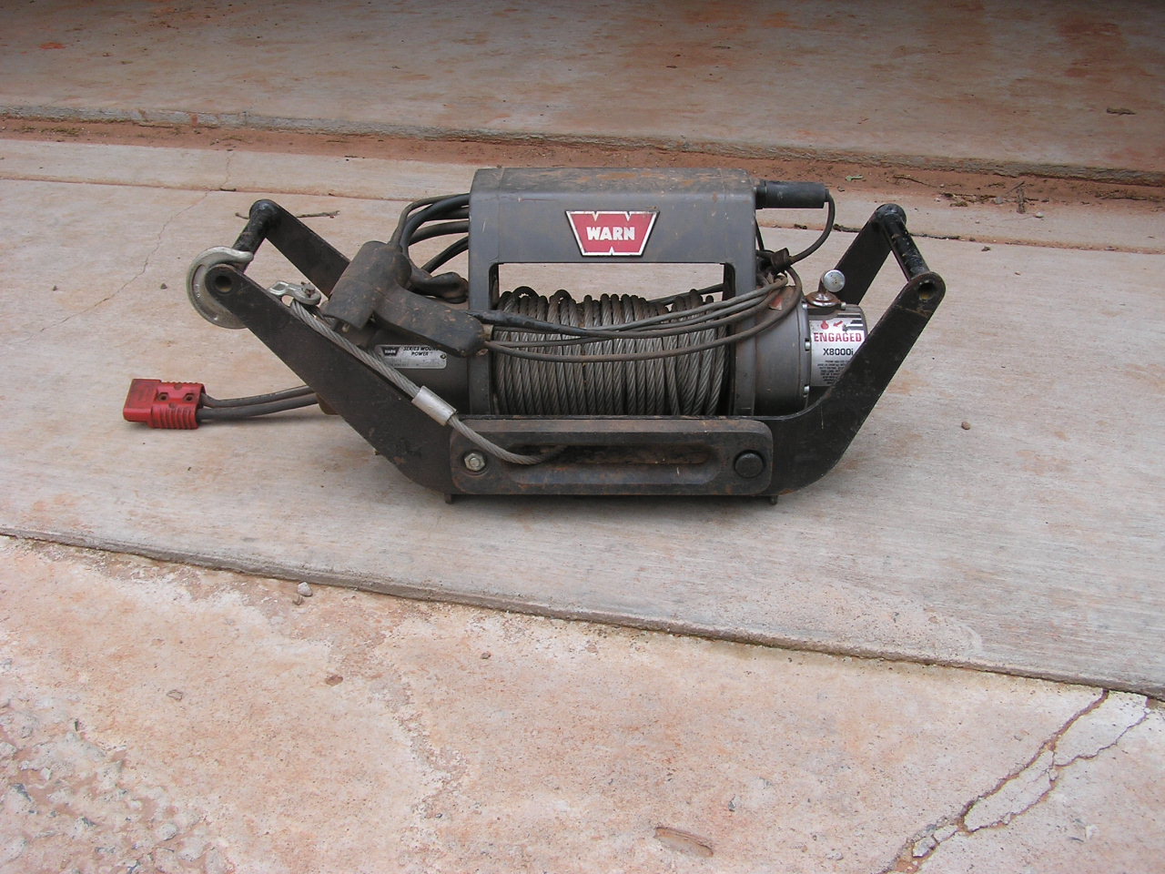

Mine came with the red ones.

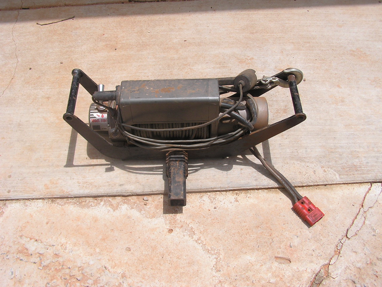

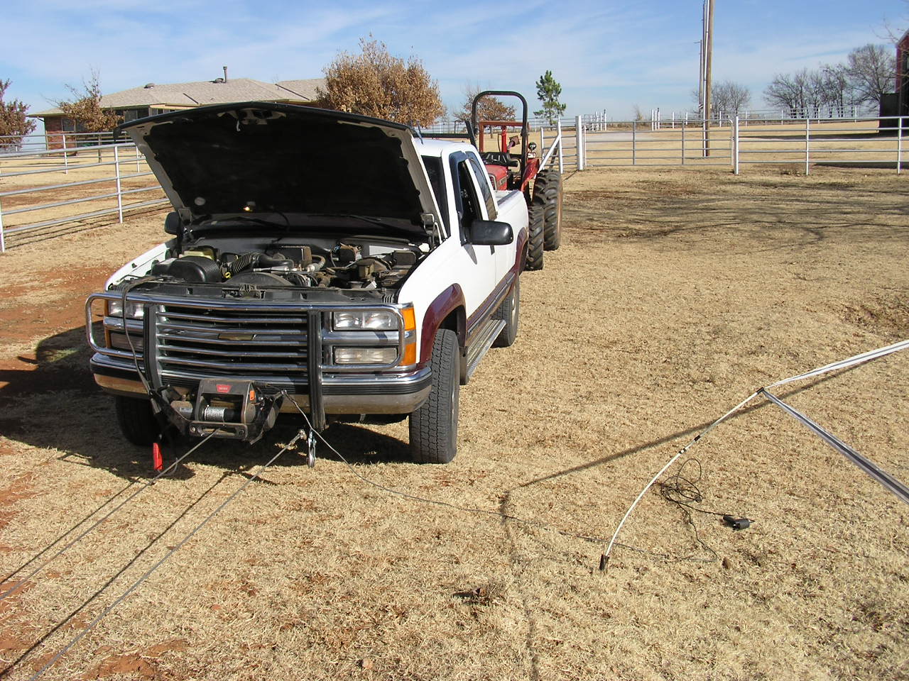

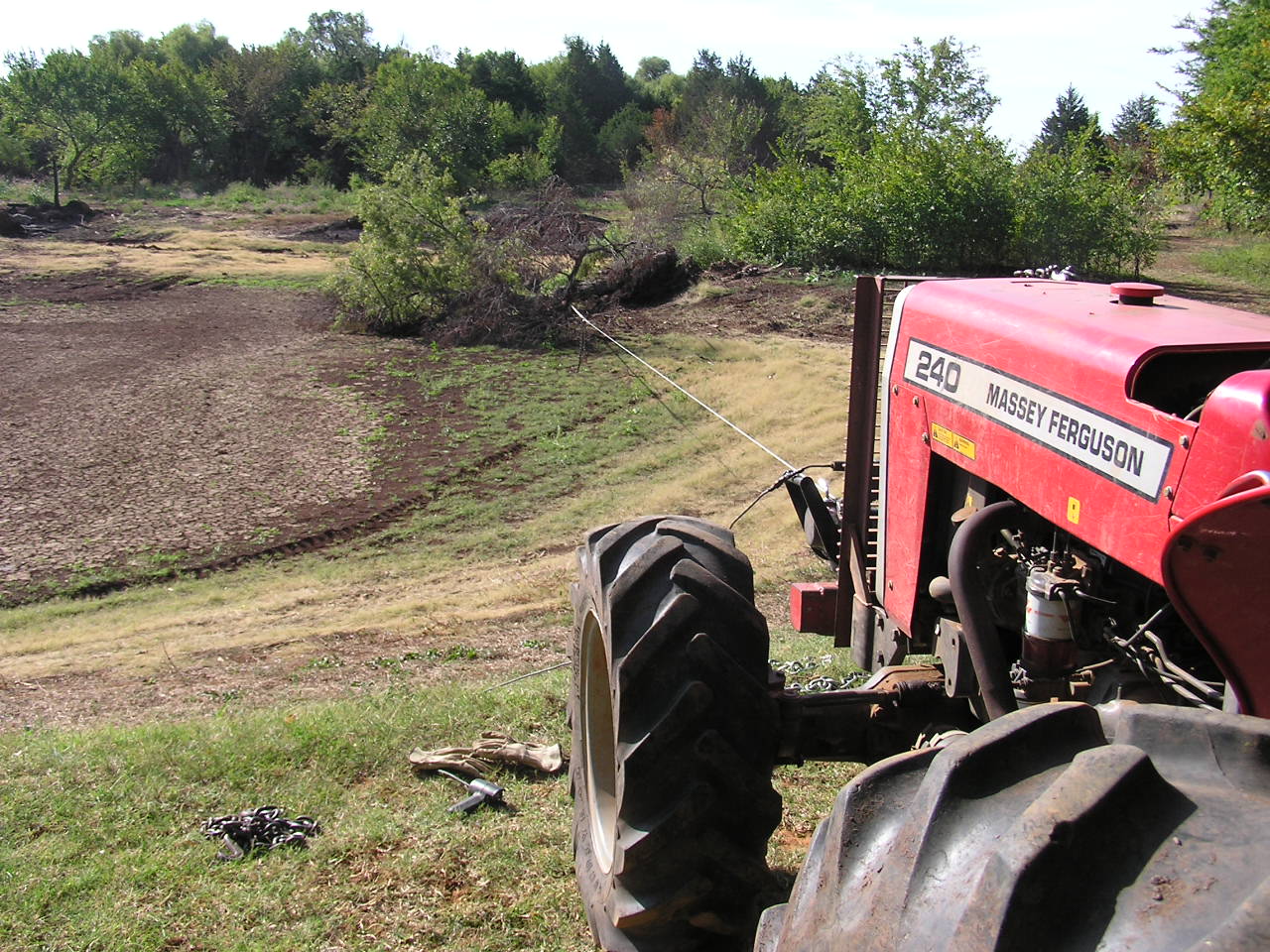

I had a front receiver hitch on the truck at that time, also put one on the tractor.
