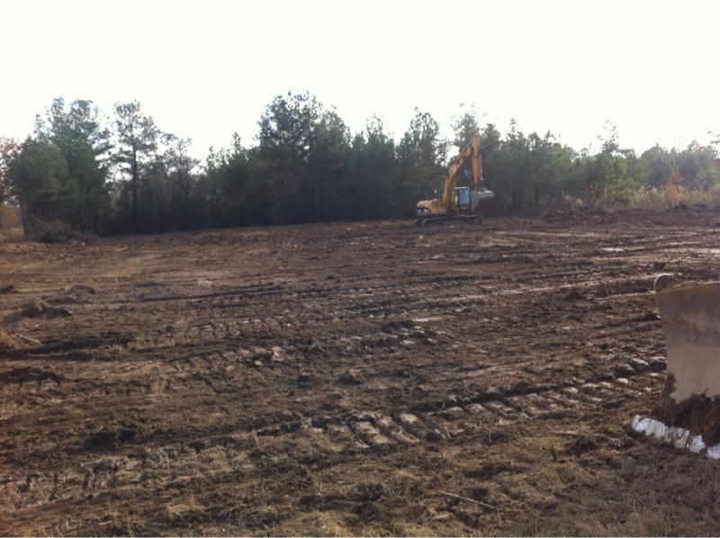

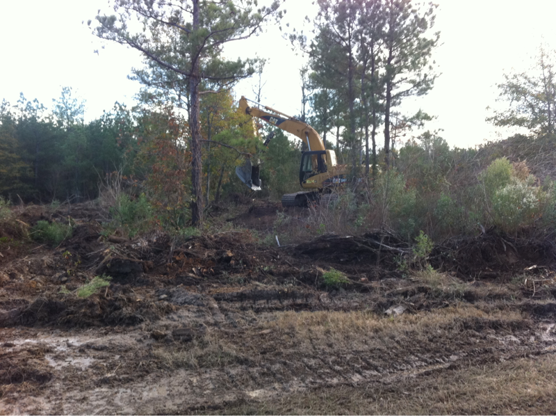

Well I got to go play with it some before dark this evening. I've never really used a box blade much before but wow, you are spot on, it flat out moves some earth quick! It definitely puts the weight on the rear tires too, the more full it gets the more traction I had. I was actually considering buying a small dozer before this but that definitely won't be necessary for this job. I think in 2 or 3 days max I can have my hills moved to the house pad area no problem. Thanks again for the response! Heres some pics of the area we just had cleared and the box blade hooked up to the JD. Some show the hoe at work the other day.

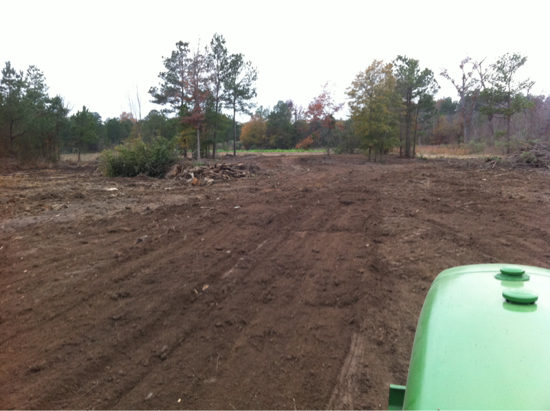

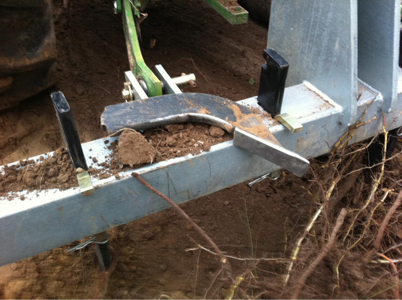

I got back out this evening and made more progress in moving the dirt. I did manage to break my new toy though. : (
I snagged a root or something but I'm surprised at how easy the ripper broke. Are these things made to break away or is this one possibly defective? I'll contact the dealer where I got it from and see what they say about a replacement.
Also I got a pic from my view on the Deere.

/ Sizing a box blade for my JD2040? #10
Seems to me like it might be defective. I'm pretty tough on mine and have never broken a ripper. Several times I have taken out small trees by just getting over top of it, snagging it, and yanking it out. I did some work for a friend recently clearing some ground in the woods. I ripped out a lot of roots and even small tree stumps by snagging them with the rippers. I was pretty brutal on it and managed to bend one sideways, but never broke anything.
Just my experience, but I think I would check with the dealer/manufacture.

Just an update, I took the broke ripper back to the dealer and he was surprised to see it broke. He swapped me a brand new one no questions asked. That's good business. He said the rep was coming tomorrow and would def want it to take with him back to HQ. I have to give a plug to P&M hardware in West Monroe, they are great to deal with too.

Well I broke 2 more. I'm really hoping there are updated parts, it kinda seems like a poor design... Either that or it is designed to break really easily. I'm off to my dealer to see what he recommends.

dntfxr - Very surprised that you're able to break the tines. When my Gannon BB hits something it either rips what it hit or stops me dead in my tracks on a JD5325. How fast are you going when you hit these roots? BTW that's a nice looking box blade.....Gary
/ Sizing a box blade for my JD2040? #15
Your Gannon has forged steel shanks, his are probably cast. HUGE difference in price. There is a good reason why a Gannon cost so much. The shanks and teeth alone cost as much as some entire box blades.

I am very supprised that the rippers broke like that, modern makes one of the best Boxblades, I also have modern products and never had that problem. this could be a production problem with their source, for steel. I have owned others but I am all modern ag. now...

Yeah I am really surprised too. They are around 3/4" thick and around 3" wide. They arent even set in the lowest position when they break. I mostly use 3rd or 4th gear, not real fast. I noticed on their website that there are replacement rippers with the notches on the back edge of the ripper instead of the front. That seems like an improvement because they all break right in the notch, at least then it would be on the back edge instead of the front. I noticed some replacements are designated "HT", heat treated I bet. Anyway I emailed Modern and they were very quick with a response but he said to contact my dealer. So I'll be bugging them again Monday. At this point if I could just pay for upgraded parts I'd do it just to avoid downtime. I'm down to 4 rippers an the performance is reduced for sure. I just had my grade shot on my lot and I've got around another 4 feet of dirt to add on the pad! Lots more pulls!
To be fair there are some small chunks left in the ground but I'm not raw dogging it by any means. As thick as the steel is on these things surprisingly the tractor barely lugs before they let go.

Just an update guys. My dealer is great, I brought the two broke ones in and he replaced them again, no problem. He said we'll keep replacing them as long as they keep breaking. In my spare time I forge knives, and I think it's a heat treat issue from looking at the open grain. I think they were hardened but not tempered. I considered tempering them in my oven for a long soak, to see if they'd at least bend before they break, but I'll just let Modern sort that out... The box blade itself is much heavier duty than most on the market, so I'm thinking they probably just got a bad batch of outsourced shanks.
