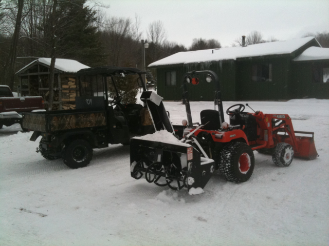

We sell the 50 inch Buhler/Farmking 50 inch for the BX22's. 60 is a little much. Our 50 inch is in stock again at $1995 and the 60 inch at $2195. Ken Sweet

I have a 48" luck now on my bx 2200 and that is all I would ever want built heavy and manages it well any bigger and I'd be crawling IMO
