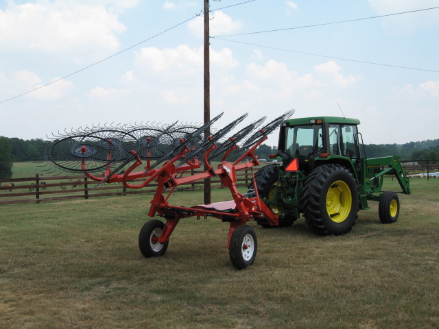

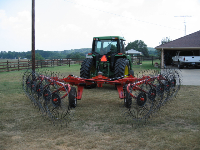

I just priced new Sitrex rakes at our local New Holland dealer today.
10-wheel Hi-capacity $8,250
12-wheel Hi-capacity $11,200
10' rotary rake $4,300
We used a Vermeer WRV10 hi-capacity rake for two years in Iowa. I like the rake for its speed and for the fairly good windrow it made. I don't like wheel rakes as a rule sue to the amount of dirt and debris that can be incorporated into the windrow.
The pricing of the Sitrex rotary rake is lower than I thought they would be so it may be an option for our operation. I did find a Vermeer WRV10 in Kansas that looks really nice though......
